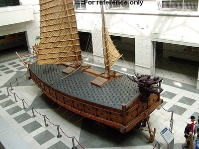

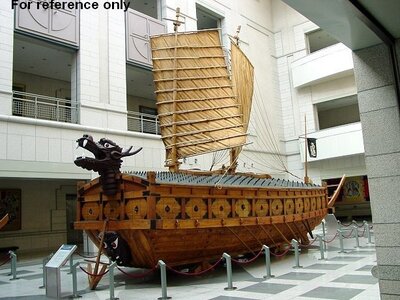

A replica is shown in the War Memorial in Seoul.
Controversial or not, I will build her covered with the iron spikes.

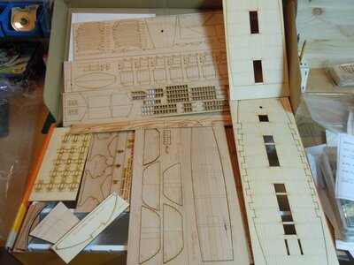

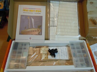

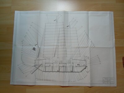

Some pictures of the box and its content:
And started already with a dryfit - total length will be 60 cm:

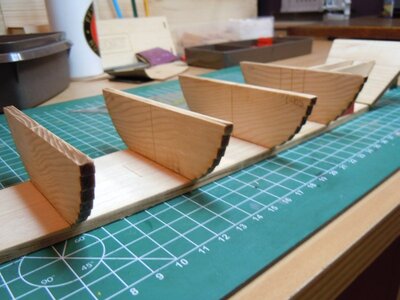

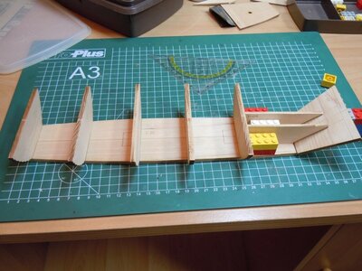

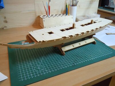

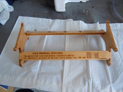

I have started with the pedestal frame. I used some oil, the reason why It's still a bit shiny.
The hull is not so complicated, very flat but it's according to the original ship.

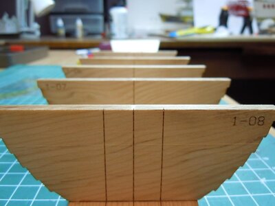

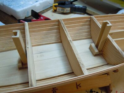

With a little help of "Lego" I glued the first five frames:
The planking will be layered and frames are already prepared for it by the manufacturer:
I'm satisfied with the first results:

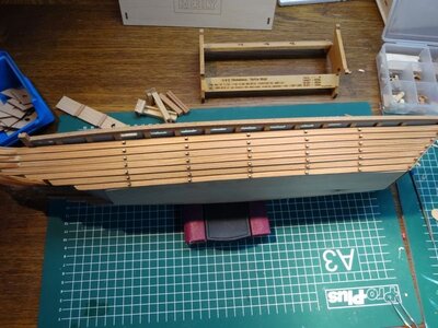

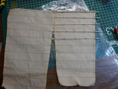

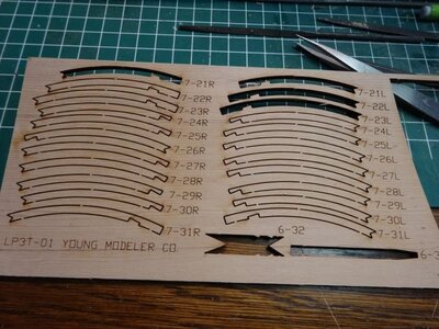

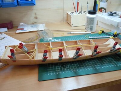

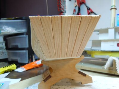

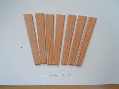

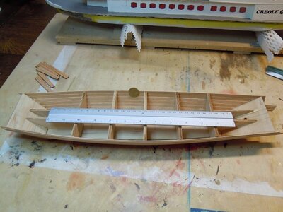

Seven planks on each side were enough to close the hull, no difficult bending.
Overview:

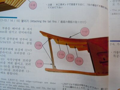

First modifiation is upcoming.

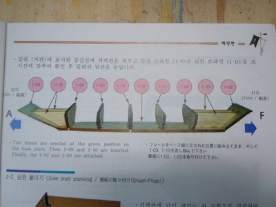

This is according to the instrucions:

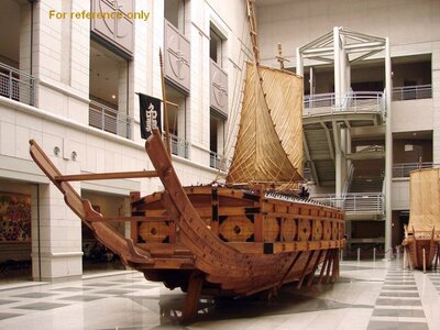

And look at this photo of the replica:
It's not quit the same :eek:.

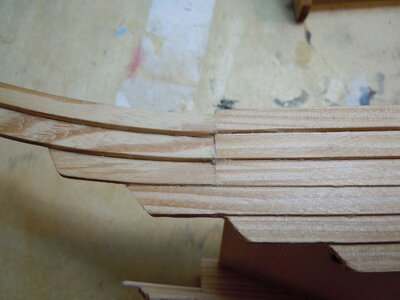

First the bow (rounded planks):

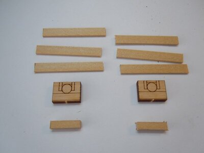

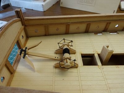

Parts of the mast foot:
Dryfitted in ship:

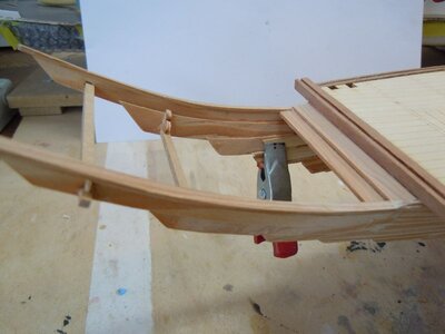

The tail of the ship must be extended with three pieces, now trying to repair the small gap with sawdust and a bit of carpenters glue.
It's not done yet.

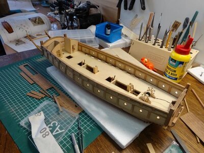

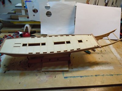

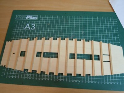

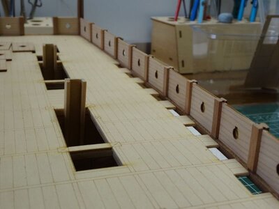

Preparation of the maindeck:
Overview (dryfit):

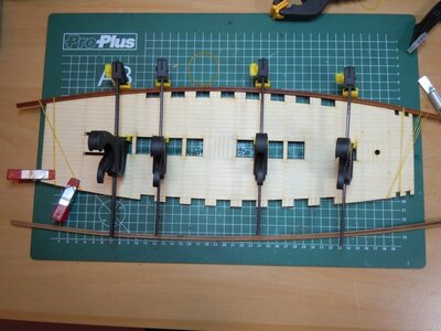

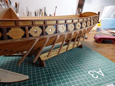

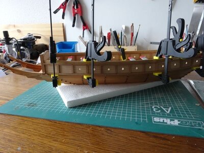

Bending sideboards - 5mm x 5mm cherry.
First soaked in water of course.

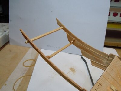

And the first modification of the tail (not finished yet).
Furthermore I want to hide the gap at the right side - I'll fix it, but need some time to think about that.
The cherry was more easy to bend than I thought.

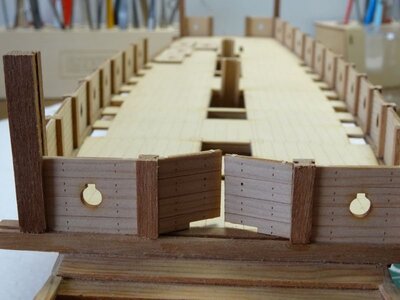

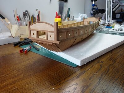

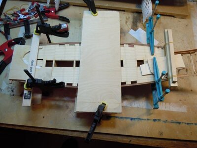

Placing the deck on the hull. Needed some creative clamping.
And without clamps.
Working on her tail:

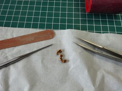

Some very small parts:
Placing them on the boards:

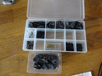

Blackening the metal parts.
The ship will be 'overloaded' by metal parts. Hope it wont sink.....

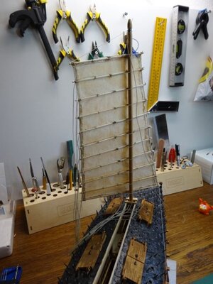

Anchor build:
Heliview:
Firstmetal parts. It looks Wow imo.
More details:

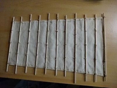

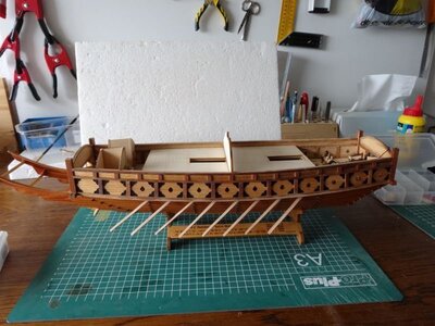

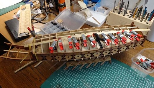

Building roars:
One side with roars finished:
Cheers,
Wim

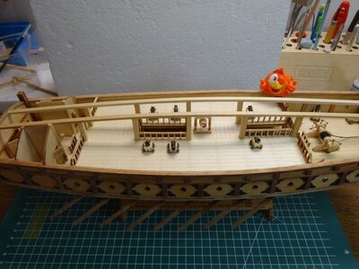

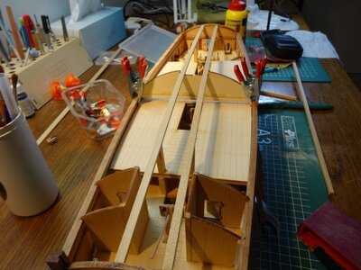

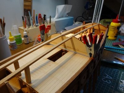

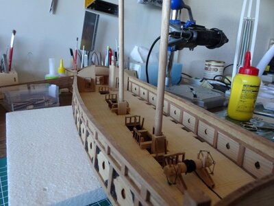

Both side roars are placed, so second deck could be glued.
In the middle there is a jig, which was in the kit.
It is intented to obtain the right shape in the roof.
Two planks over the jig.
Some guns and fences on second deck and removed jig.

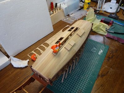

Normally you only plank the hull...now roof too.
First planking.

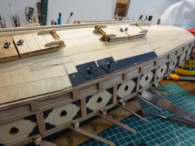

Deck is closed now, a bit sanding and she is ready for her metal coat :)
Busy with the portholes - must say they have a different position we are used to.

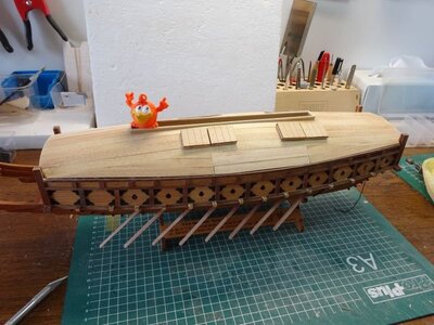

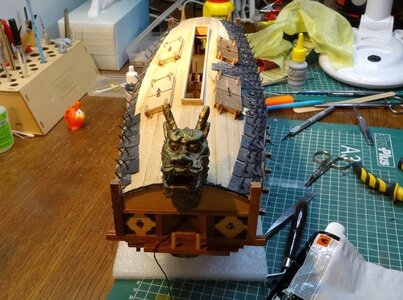

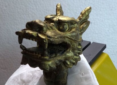

Painting the dragonhead in gold, for more depth it need some black wash.

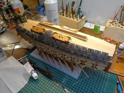

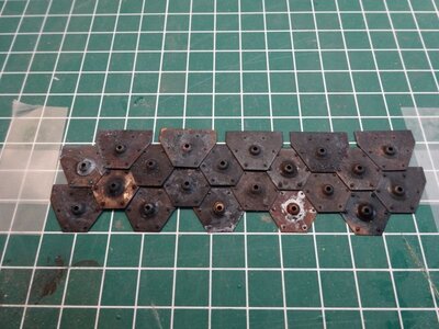

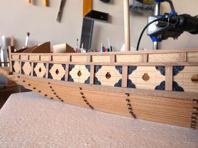

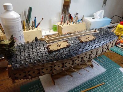

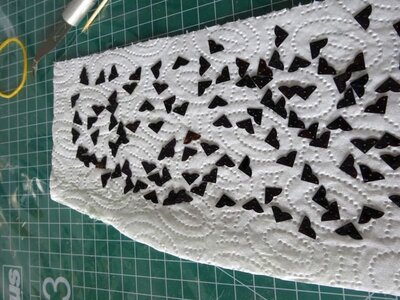

Studying the pattern of the metal armour.

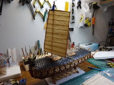

An impression:

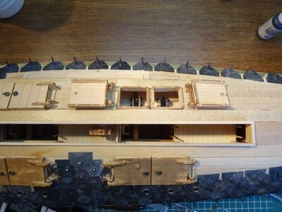

Placing armour:
Finished the armor, I am satisfied with the result so far.
