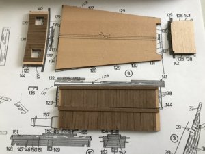

The partially completed pieces for the deck cabin, I've left the ends of the side and front walls free of the walnut planks since they will require a slight bevel when fitted and glued.

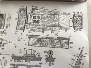

The plan for the deck cabin, it looks like a confusing bunch of numbers, but with a little study and colored highlighting and looking up the material referenced by the numbers, everything falls into place.
This is the start of the rear cabin. The plans are 1:1 scale and all the materials need to be reference back to the German instruction manual. I've been copying parts of the plans as I need them. It takes a little bit of study to visualize how the pieces fit together.

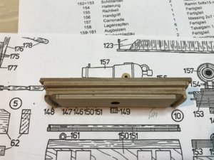

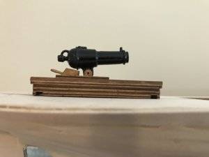

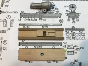

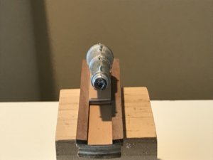

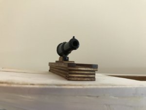

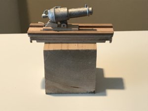

Working on the Carronade carriage. (Is that the correct term?)
I found once again that the 1:1 plan needed a bit of study. This piece is made up of several sub assemblies. The build plan is excellent but also confusing. Without noting the part numbers and referencing the build manual, the laminated plywood pieces as shown on the drawing look like individual boards.
As Uwe would say, check, double check and then check again. Being a novice builder I have a lot of instances of measuring twice, cutting once and the part is still to short. :)
Jan

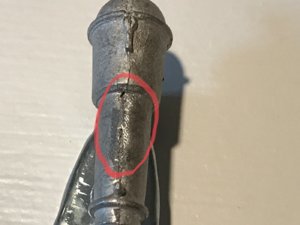

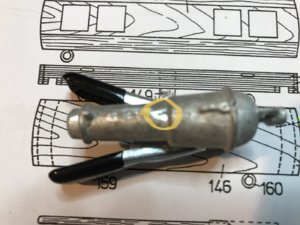

Hi Jan. That is strange - those gaps in the cast-line are very "un-Krick" like (from what I've heard). I cant tell you the exact number of the postings, but if you look at @Maarten and Alex T's RC builds, you will find the write-ups on the blackening agents. Everything on Maarten's RC is just about perfect, so have a look at what he advises.
Thank you Heinrich,
I'll look those builds up.
Jan

Hi Jan. Good to see an update. Yes, that is the question. But you wont be happy with that the way it is now, so I would take the chance.

Hello Jan,
Agree with the above comments, try to drill. Use small drill bit first. if worth come to worth, insert a piece of brass tubing it will make nice bore.
Jan
