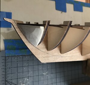

I haven’t gotten very far assembling the false keel and bulkheads other than dry fitting the parts. Finally after a long wait the Basswood sheet wood arrived in the mail. The sheets are 2 X 3 X 24 inches. The plan is cut, laminate and fit them into the bow and stern to give the future hull planks more support.

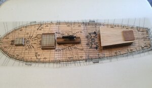

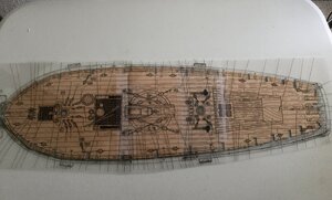

I have to say that transparency looks pretty cool.
It will be interesting to see how much use you get out of it.
Rowboat,
The overlay has been helpful spotting, comparing and placing the “deck furniture” pieces as I finish them. It’s also good for visualization of the deck planking pattern. IMO it’s going to be a great “jig”.
Jan
What product and process did you use to get the transparency overlay, might be something to add in the technique section of forums for others to know about and use.
In my post #67, I mention that the process was to use a inkjet printer and transparencies.
I have a HP Officejet Pro printer and researched on line for the right transparency medium. There were many to choose from, I picked a vendor that sold a package of twenty sheets.
1) Because it was an experiment
2) Because I had figured out I only needed three or four sheets to make into a template for the deck.
I also made a couple transparencies of the plans for the deck furniture. The thought behind that was to use them as a base for assembling the deck furniture. But unfortunately not like the wax paper I had been using, the PVA glue, wood parts and transparency underlayment bonded quite well.
Jan

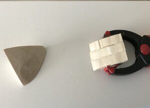

Bow insert Filler:
The raw material, right side of picture, Basswood pieces glued into rough shape. The left side of picture is the Port side almost done.
Some more sanding, fitting, sanding, fitting and sanding. Once this part is done I plan to do the same type of fill between bulkheads 2,3 and 4. Then it’s on to Starboard side.

The filler block in the pictures my third try. Each one is getting better as I progress. My carving experience is next to zero, but I'm learning.
Jan
On that one, I wouldn't carve any further. Just sanding now with varying grits of sandpaper. I am very weary of carving there as it tends to result an irregular shape. I know it takes much longer, but sanding is much safer and the more you sand the more you tend to get a "feel" for the curvature of the bow and the fairing of the bulkheads.

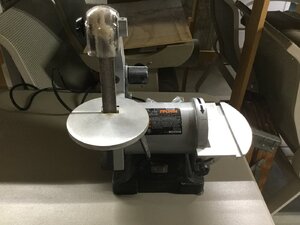

Indeed, I’ve found that my carving skills are not impressive or improving. I’ve switched to using my
I use the belt sander to remove small amounts at a time to get the bow filler roughly to size and then sand by hand to get the final shape. My prior efforts with carving and sanding resulted in “dimples” that I could not sand smooth. The result of that method was the removal of to much material. So currently we are in my favorite build mode the “Do Over“.

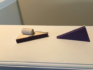

Need a tool to sand in a corner? Found all kinds searching the internet, but nothing that would do the job I was trying to do. So I put on my DIY cap and this is the result.
A couple of pieces of scrap cut to the angle I needed, sandpaper cut to fit the scrap shape and Elmers glue stick. I used enough sandpaper to cover both edges of the scrap to allow for some edge sanding.
Jan
I have used small angled sanders with rotating bands that have a angled point to get almost into corners.
Yours looks like it will work well, at least until the sandpaper wears thin, then pull and replace I guess.
