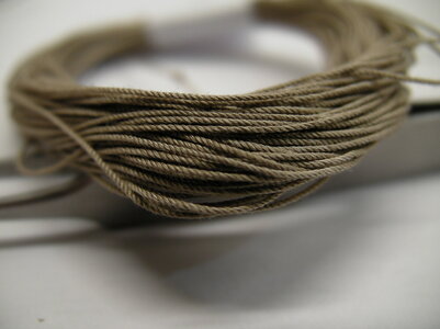

For further construction I ordered the necessary Pearwood Cleats from Dry-Dock Models. If I need them they are available.
For the rigging of the anchors I received the needed yarn today.
Above the new rope from: Modellbau Takelgarn, J. Marx, Berdingstraße 4b, 30451 Hannover. Below, the usual ropes from various kits.
Construction kit rope as it is still found in many construction kits today.
Rope from Modellbau Marx.
Also new the anchor rope.
Of course it is always better to make everything myself, but for my small needs I also like to use and support suppliers. The "La Belle" is actually also a kit model.

First attempt with rigging rope from the remnants of old kits with different diameters. Lint can not be burned off but the rope melts instantly.
. . . and with the new rope. The rope is made of "Gütermann" raw materials and does not melt if, however, once a lint to stand under the magnifying glass disturbes. With beautiful ropes, of course, you enhance your rigging work significantly and modelling is more fun.

Have you tried using a little bees wax? That’s how I get rid of lint. ;)
Hi Dean!
The rope is beautifully made and immediately consumable. With the eye you can not see any fuzz at all, at most under the magnifying glass. The lighter test was only to see if they are really natural materials.
Once you have such a beautiful rope in your hand, you envy the modelling colleagues who make their own rope and consider as a new acquisition a machine for rope production.
