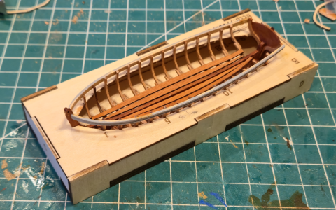

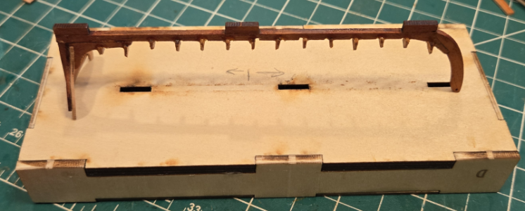

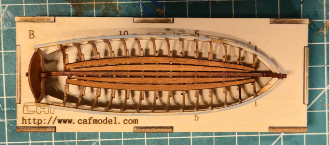

La Belle - CAF Models 1/36 by Signet
Time to put the wind beneath my wings - oh, wrong song. The wind into my Jolly boat's sail. Which means I have to work on the sail. Let's start with the sail, mast and spar design, which I drew up:

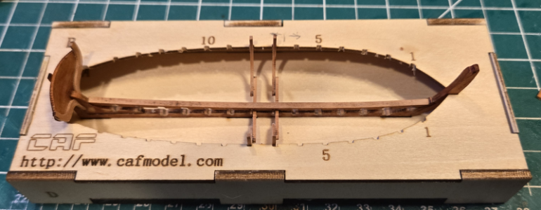

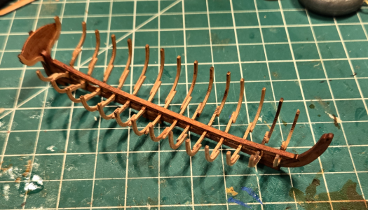

Okay, enough of me screwing around and not working on the subject of this thread, the CAF 1/36 Scale La Belle. CAF had done a 1/48 scale version of this vessel that has been done quite often. I don't envy those modelers; even the 1/36 scale will be a challenge to me in many ways. An Italian outfit made a 1/36 scale version, which appeared to be a group build on a German modeling site, and they are darn well incredible, as it was a great kit to start with. But no longer available, so I'm happy CAF has gone with this model.

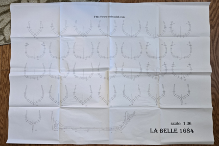

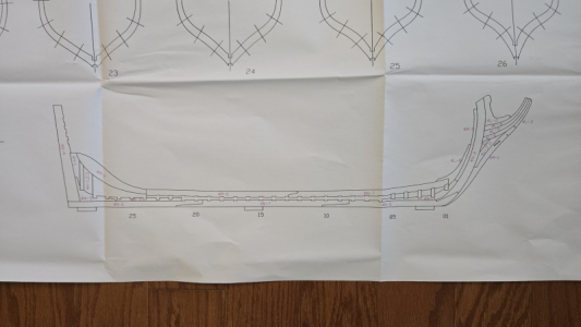

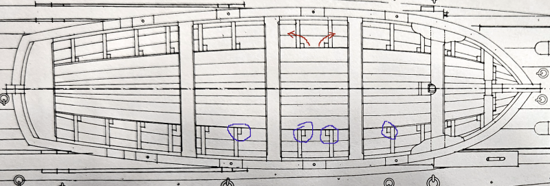

I'll start by comparing the mid-section frame of the model with Boudroit's drawings included with his La Bell monograph:
Boudroit's drawing is on top, and includes for reference the plank locations. The kit drawing is below, showing cross-lines where joints are located. The other outline is quite close, with very slight variations in a couple areas. Probably within my sanding and shaping ability. The inner outline is thicker toward the bottom, but I'm happy about that, as it makes it stronger, and if I /really/ wanted it closer to the monograph, I could sand that area more.
(BTW, I know there has been a lot of discussion and research concerning problems with Boudroit's drawings and analysis of the actual, or theorized, shape of the hull. I don't want to get into that here. The small variations between the various versions will not, IMHO, be visible in the model. I will ignore Boudroit's information where I have specific information to the contrary, and will explain why. But the niceties of the hull shape will be beyond the scope of this build. Hopefully.)
I'm going to take the process of building a couple frames tiny-step-by-step, as I think/hope there are a couple details and other information that may help others. Obviously, I won't do this for the remaining frames. I decided to start with the M section frame, the only triple frame on the ship and located at the broadest portion of the hull, and a severely beveled frame #2, to see how that works out.

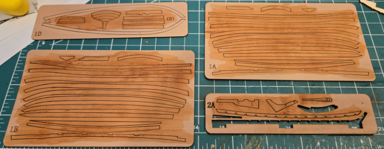

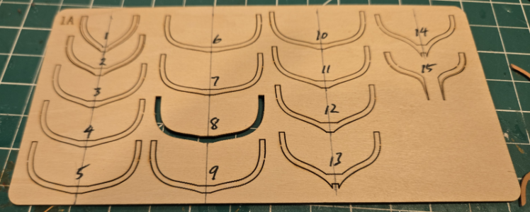

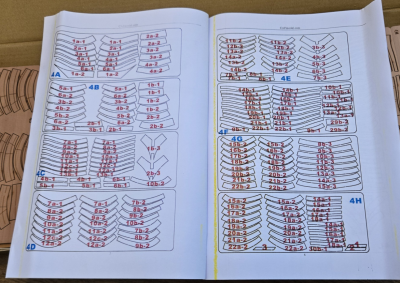

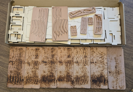

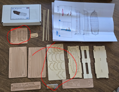

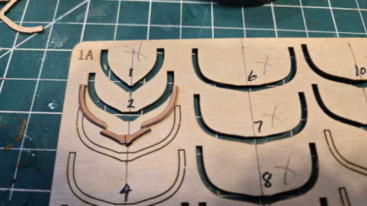

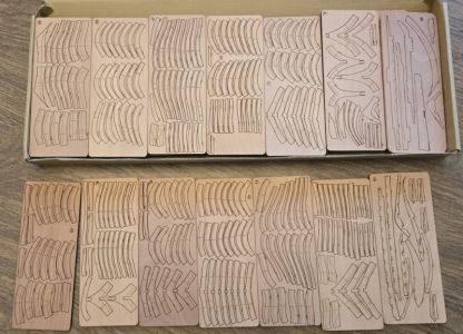

The needed parts for one frame are removed from each sheet. In the past, I've marked the part numbers beside each part, but so far I'm not doing that, partly because there's little room here to do it clearly. I do quadruple-check I have the right parts for each frame - the parts from adjacent frames are extremely similar, so this can easily happen. I've seen others write numbers on each part, but I don't like to do that. At least most of the time.
While looking at the various parts of the frames, and when comparing them to the frame outlines, you will find some lines that don't make sense, and seem like they shouldn't be there, like those circled below:
It turns out that they shouldn't be there. According to Tom, they are a "legacy from a previous version". That's kind of unfortunate, if you want to see the sides of the frames in your build, so you may have some extra sanding to do.
So, next I take the pieces for my frames, and place them in the approximate location to confirm that's where they go. I broke my rule of doing one frame at a time here, as I felt I was safe with the completely different frames being worked on:
Most frame parts of laser-etched lines on one side, like the center portion below:
The "cross lines" I'll call them show the location of parts of the second frame, which overlap each other for strength a bit like a row of bricks. It's hard to tell from the photos below, but the notches are a bit narrow for the 4mm keel:

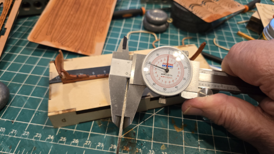

The notches are smaller than 4mm by less than 1mm, probably closer to 0.5mm. That seems a tiny amount, and it is, but 1) It's a lot more than is required to remove the char (and it's debatable if when gluing notches and parts such as this that the char needs removed at all), and 2) That 0.5mm, or whatever, is much more of a pain to remove than it appears to be (and should be).
I guess I'm not as skilled as most, and maybe a bit more impatient, but I've used about a dozen files of various styles, grits and shapes to widen this slot, while 1) Keeping the slot from being too wide, 2) Keeping the slot centered, by not removing more material to one side than the other, 3) Trying to NOT deepen the slot by more than the char, and 4) keeping the bottom slot corners sharp so the 4mm pieces fit in as far as necessarly.
Sure, that's a common task for us model ship builders, and basically a simple one, but hard to get "just right". My first notch looks like this:
Yeah, it works, the part fits, and it will glue fine. But it's not neat. One side's a bit deep, and it's, well, ugly. Perhaps others have found ways of increasing the width of these slots, but I've not found a great one. This is the best way I've found to increase the width, without increasing the depth, which can more easily be done afterwards:
OF course, it depends on the state of the grit of each side being the same, but hopefully it is.
Again, why the big deal? Well, for just this frame Section 1 of La Belle, just counting notches involving the 29 frames, I need to make 116 notches, counting those in the keel and keelson. And, IMHO, there is no reason we should have to do this. Other notches, like those on the building frame, push together with little force and clearance without the touch of a file or sandpaper. The 0.5mm or whatever is allowed for this should not be there, for this location or any area where a known thickness piece (like 4mm for the frames) is inserted. The 4mm pieces are accurate within less than 0.1mm, most much less. The "normal" 0.5mm allowance for pieces like the frame outlines themselves should /not/ be necessary on the notches.
Tom - I know you're following - please consider allowing far less, maybe close to zero, clearance in laser cut notches when known thickness boards are inserted into them. Sure, the outline of parts needs the allowance, but not the notches.
Anyhow, after filing, sanding or whatever method (I considered buying a 4mm wide file, but couldn't find one, only a round one) the notch, the 4mm thick piece hopefully fits well and is of the correct depth:

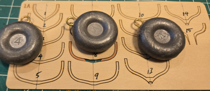

Weights hold the pieces straight while the glue dries. I've used a piece of glass to mount frame pieces on in the past, but think my work area is level enough for this purpose.
After the glue of the first layer dries, I can add the second layer. The laser lines on the center piece are somewhat useful here, but all I really need is where the pieces start. I've found that excessive sanding for end-mating parts isn't really necessary, and can sometimes result in a shorter frame than desired. I prefer all the frames as high as possible, so I can be sure of obtaining the correct height.
So now there are two layers with one to go:
At this point, the center frame can be removed from the paper to add the 3rd layer:
Any Fixo-Gum can easily be rubbed off, any paper sticking is caused by the white glue, so a light sanding eliminates those items and provides a level surface for gluing the next layer. The template can't really be used for that, but isn't necessary, as you're just matching the parts to the existing structure. I started at the top, actually.
Frame #32, and all the frames /except/ number 12, the triple frame, are double frames so the initial procedure is a bit different. Most frames, in addition to the (unnecessary) cross lines, have lines that show where bevels are to be cut/sanded. TO be sure they will be visible when the frame is done, the frame pieces have to be placed on the paper with the laser-cut side down.

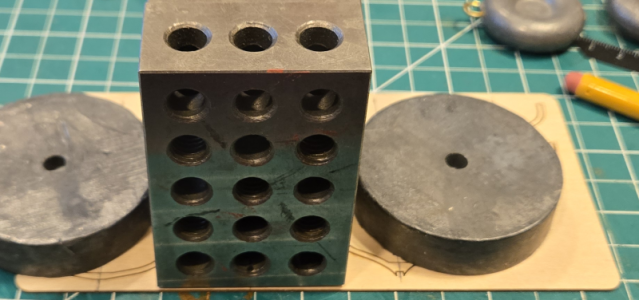

My single plate weight works well here for this smaller frame:

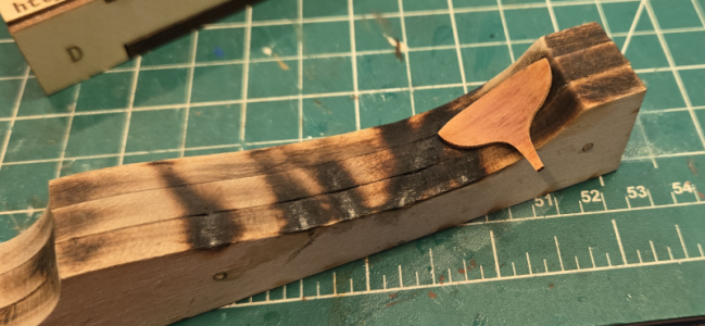

Next I sanded the contours in frame #2 above. (The triple frame above has no lines or contour, so that's not required there)
I also removed the char and sanded the inner and outer surfaces of the two frames. I feel the inner contour will be close enough visually and construction-wise and this will eliminate inner sanding in place, which is difficult. I've also sanded the outside of the frames. After assembly, they can be recontoured, if necessary, but if that isn't required, they'll have been sanded with the grain, and have an initial finish coat.

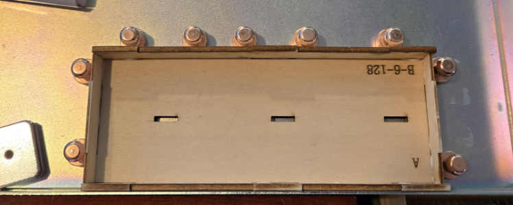

A quick note about the frame construction on this model. I've been surprised that the double frames did not have both halves go all the way to the keel, like in the Granado that I built. It seems to me that the area near the keel needs to be the strongest (which is why most frames taper in both width and thickness as the go from keel to rail), but that's not the way this ship was built. It seems that the La Belle was one of the first proven examples of double frame construction; the French shipbuilders simply added additional frame 2nd and 3rd futtocks to the existing single U-frame, without adding the second 1st futtock that would form a normal double frame. BY itself, this would add little to the strength of a frame, but added to the entire hull structure, it would add strength and help prevent penetration by cannon shot or accidents.
My intent is to include the appropriate bolts in the frame, and maybe treenails and such as well, so today was my first try at it. While most bolts on the La Belle were round, the bolts holding the futtocks of one layer of frame to the other were 1" square bolts with square heads, with roves (washers) at the other end, bolts peened over. I have seen square roves in use, so assumed those would be square as well. First, I drilled holes in the M (triple) frame in the required locations:
I drilled the holes from each side separately. In theory, I should have been able to drill straight through all three 4mm pieces, but I really wanted to be sure the holes were centered, so drilled from each side. Maybe I'll drill straight through the double frames.
I pressed the square head bolts in place on one side. I wanted to avoid glue, as I was afraid it would make mess around the hole,
I tried prying the bolts out with my fingernail, and "pounding" the frame on my workspace, and didn't lose any, so hopefully they'll stay. Later coats of finish should help keep them in place as well.
The other side of the frame has the bolts with roves (I assumed builders would install them all from one side. That may be a bad assumption, but I went with it.
With the naked eye, the bolts with roves just look like big bolts, a bit oversize, but that's how it should look.
Here's a close-up of the side with the square bolts:
And here's one of the side with the roves:

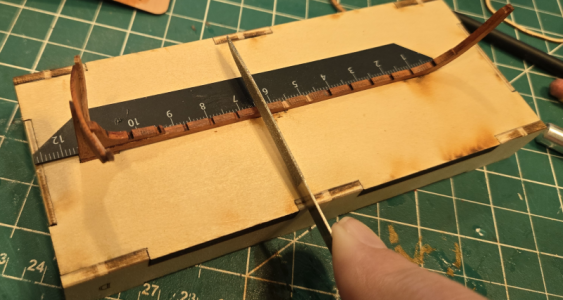

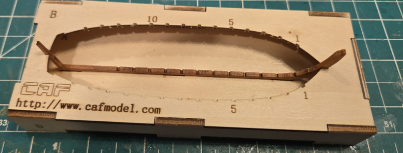

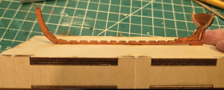

Continuing on with my concern that the added bolts may interfere with the positioning jig, I first measured the location of the frame to the keel (not yet assembled):
I then overlayed the frame on the side of the jig, to see where the jig with slots for the frames is located (arrow in red):
So, at least the lower of the pair of bolts at that location interferes, as shown below with the frame in the correct locaton:
With this interference, I won't be able to put bolts in at that location, or just below it, to be able to get the frames in position, or more importantly, get the completed frame out of the jig.

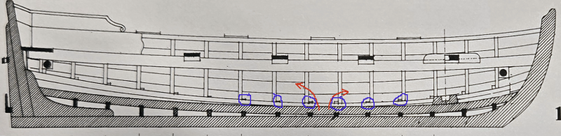

Let's check frame #2 to see if it has a problem:
No problem with this particular frame, since the bolts are placed as far as practical inboard, but if there had been bolts on the fore side, they would have been placed outboard, and would definitely be a problem.
So many of this level of bolts will interfere, and can't be positioned there. The question then is to see if this matters; that is, would those bolts be visible after construction. While I placed all the bolts on frame 12, it was kind of a test. In actuality, I think it's silly to place them where I know they won't be visible (i.e. I'm not Uwek, after all). I scaled up the drawing of the side of the jig, comparing it with actual measurements, and used some advance drawings sent to me by Tom, to get this:
The jig side is shown over an outline of the La Belle, frame 12 is shaded in blue. The slots identified above is where the horizontal frame piece that locates each frame is located. Comparing the photos posted above, the bolts in question occur right at the slot level, which in this case is behind the lower wale. I will definitely be adding the wales to both sides, so anything behind them won't be visible. I'll have to see if I want to leave any strakes off above the wales, which would determine if I place bolts in this area.
The bolts just below the wales would probably be visible, if there are openings at that point, yet they can't be there because of interference. The answer, for me I think, is to add at least one strake below the lower wales, which would cover any bolt there (or supposed to be there). As long as any openings in the hull (leaving strakes and/or sections of frames off for visibility of inner structure and elements) are below that strake, I should be good. Of course, I'll have to check that as I go along, as joints and bolt locations change for each frame.
Basically, I'm trying to do something similar to what Tom did on his prototype, with the openings:
His structure visibility starts immediately below the lower wales, but per above, I'll have to add at least one more strake below that to cover the area where the bolt should be, but isn't. I may include the hole for the bolts anyhow, in case it's visible, saying that the ship is under construction (and I have information confirming that most of the holes and bolts were added after the frames were assembled in place on the keel, so that is historically correct. ;-).
Okay, I'm good to go, as long as I keep this information in mind as far as the bolts are concerned.

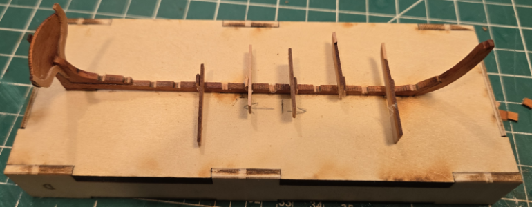

I have decided that my LaBelle will be completely planked and finished on the Port side, and the Starboard side will have open areas showing more of the structure and innards of the ship. This determines where I need, and don't need, the square bolts. On the Starboard side, I've included them everywhere except at the center where the jig frame locator plate is, while on the Starboard side I only include those below the locator place - on the off chance that they will be seen from inside, although most will probably be covered by the ceiling (floor - hate that term), structure and added strakes. Also, note that the square head bolts are now more-or-less recessed. I didn't think it realistic they would sit on the very surface, so recessed them with the tool below. Some went in more than others, which I suspect happened on the real ship too. I think it looks better in person than in the photo above, so I think it's fine.

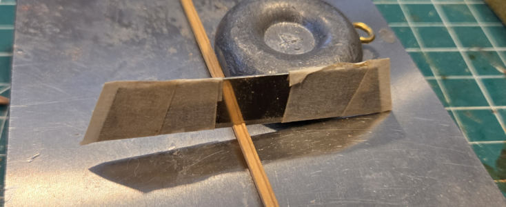

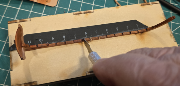

I mentioned a tool to help me align frame pieces better. The problem is we're placing one part over another, and it's supposed to match all around. I've tried using a square, which was clumsy, a block of wood against the side, and in the end my "sensitive" fingers and so-so eyes. I thought I'd done well, but the photo above shows that isn't always the case, and I want to do better. So I bought these half-round/flat parallel jaw pliers. I hope to use them to move the upper futtock to be in line with the lower by pinching from above, with the half-round side to the inside of the curve, to prevent marks. I think it should work well. In the meantime, I'm using the pliers to seat and recess the bolts, for which it has worked pretty well (except I can't see what I'm recessing, so it varies a bit, like real life I hope).
That's it for now. I'll occasionally show progress photos as my bevy of frames multiplies in number. I probably won't add much detail until something changes in the frames (it will) or I work on something else worth posting.

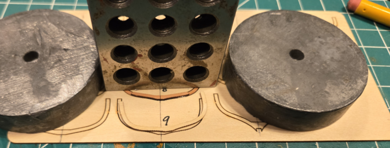

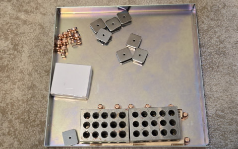

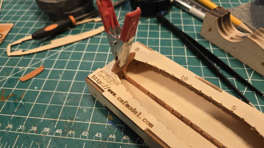

I think I previously mentioned a tool to help keep the layers directly atop each other. This is what I got:
I'd always wondered about pliers in which the jaws stayed parallel to each other. Using regular pliers to force two pieces together, etc. never worked very well. When I had problems making the two layers of the frames exactly in line with each other, I bought the pliers and used them for this method. It actually works pretty well. I let the glue dry just a little bit (Ponal Express can be repositioned for 5 minutes, so they say), then use the pliers vertically over the drying frame, and it moves the upper layer in line with the lower much better than I'd be able to. Also, the tool works works well to seat the "bolts" into the frames.

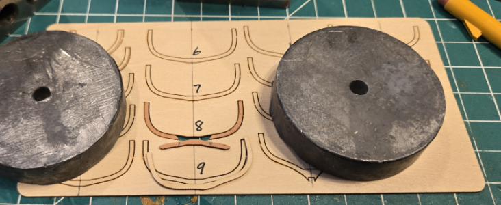

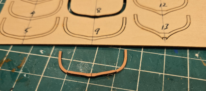

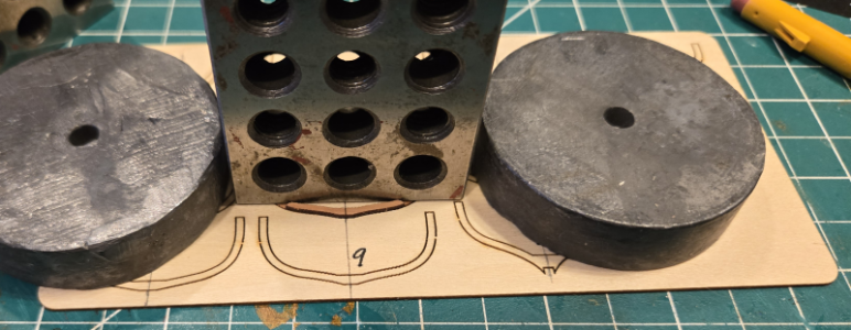

I continued on with frames toward the bow, frames 9 and 8:
Frame 08 is to be cut out for the gun ports, either now or later. I'm not that confident in the exact location of these ports (the top and bottom are shown horizontal, for example, but should be parallel to adjacent wales and strakes), so am not cutting them now. However, I did just put a spot of glue at the top, and left glue off the port area, so it should be easier to remove cleanly.
Frame 9, like the others I'd done so far, had no bevel to the sides due to hull curvature, so like the others, I put them together backwards, so the unnecessary and wrong laser engraved lines were to the inside; the laser burn was easily sanded out. Starting with frame 8 forward the edges are beveled, inside and out, in accordance with the laser engraved lines along the periphery of the frames. So frame 8 above is assembled the "correct" way as shown in the instructions. Or at least in the manner expected.
Here are the finished frames, with the square bolts on the aft side and the square bolts with square roves on the forward side.

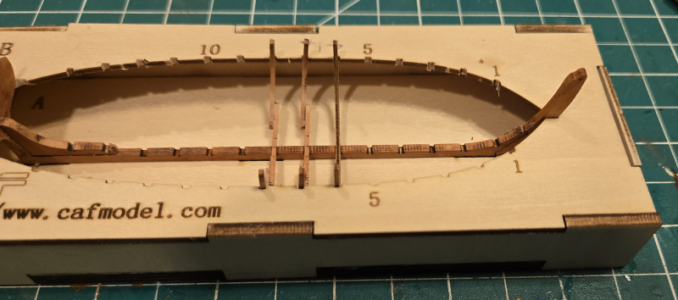

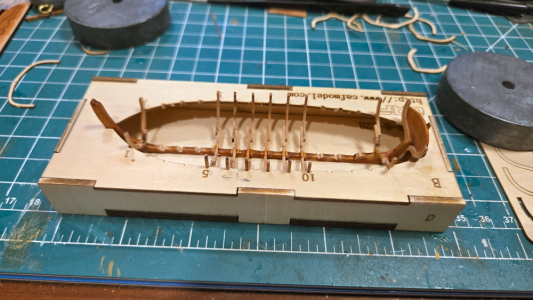

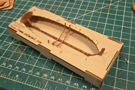

I've left the unnecessary laser lines on frame 8. I toyed with sanding the whole thing down to remove them, in retrospect I probably should have done that. Maybe I will on the rest. As on the other frames, I've left bolts out of the middle which ends up just below the lower wales and at the notch in the jig that locates the frame, and would therefore interfere with the frame sliding into the correct position.

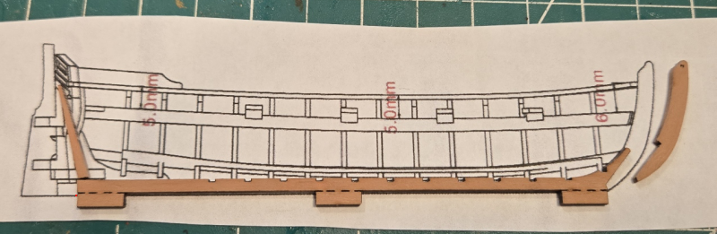

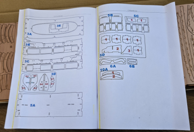

In the meantime, I've taken the advance drawing that Tom sent me and made some overlays of the inner details, structure, and outer details to determine what I want to show without planking, and with portions of frames removed, to make openings for inside detail. This is what I'm currently working with:

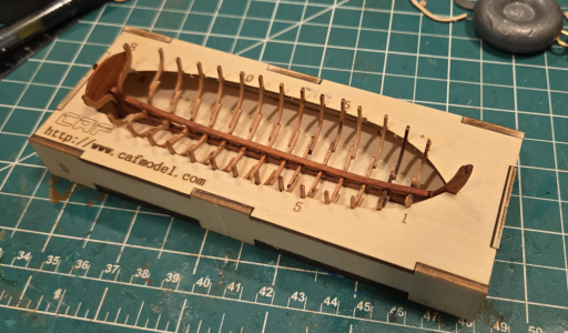

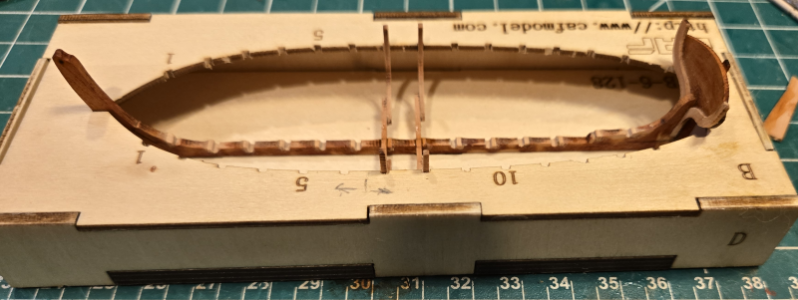

On the above, frames 7 through 12 are in place, but I might end up removing portions of 8 through 11. I'm unsure, though, as there won't be that much detail that area that won't be shown elsewhere. We'll see - I have lots of time to decide.
I'm enjoying the model so far. I like the pearwood. and the pieces and contours match Boudroit's monograph very well.
