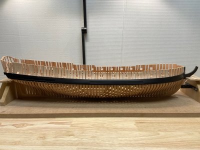

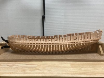

Planking continues - 6 strakes left. No stealers or drop planks will be needed. I am going to simulate nailing after and have attached the sample I have chosen. On the left I did try alternating the historically accurate pattern with one nail and trenail alternated. Instead I am going with the pattern on the right - which is simply holes filled in by wet sanding the Liberon Finishing Oil. Its a bit more subtle and to my liking.
I need to drill all the holes next to use the frames as a reference for the necessary lines before completing the planking.
Chris,
The planking is looking great!
I like you decision on the right side.
Did you use different size drills to simulate the wood/metal pattern or is it just an optical illusion? The red circles appear slightly smaller diameter?
If purposedly done, I like it!
I did use two different size bits - 0.4mm which is the nail size and 0.6mm which is the treenail size at 1/48. The larger bit does give that effect - the trick is shallow holes. I believe I twisted the pin vise 3 times on both holes. The oil saw dust mix does the rest.
