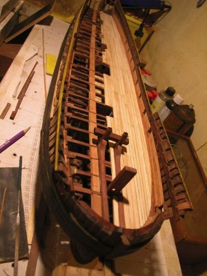

Le Gros Ventre 1767 1/48 POF from Ancre plans

Great work and the Jarra wood is interesting. Love how it aged during your hiatus. Side note, your break was half as long as my break on the BHR, while we raised two daughters.
Your joints and deck construction is looking really good! Thanks for sharing.

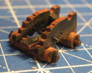

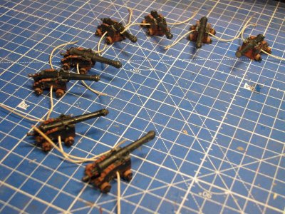

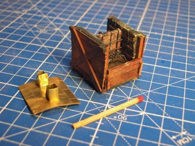

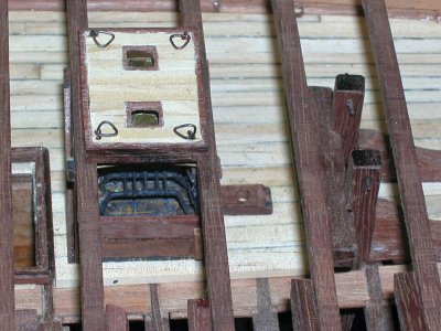

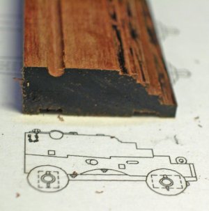

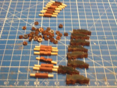

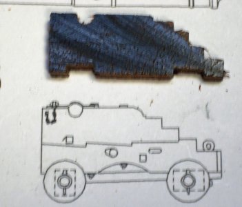

Here are the guns. The Gros Ventre had 16 4-pounder pop-guns and as I am only decking the larboard side, I have made only 8 guns. The guns were molded from resin and the carriages from jarrah according to plans. I will install them just prior to permanently attaching the maindeck
DSCN2927a.jpgDSCN2926a.jpgDSCN2929a.jpgdscn2936a.jpgDSCN2940a.jpgDSCN2944a.jpgDSCN2948a.jpgDSCN2949a.jpgDSCN2964a.jpgDSCN2965.JPG
Cheers
Dick

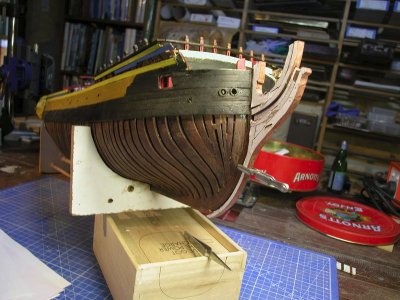

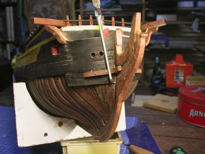

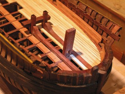

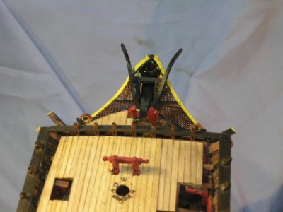

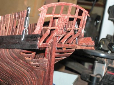

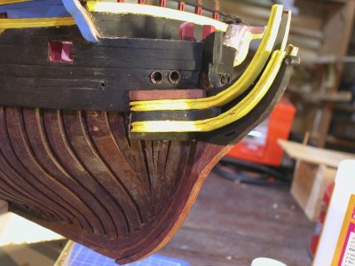

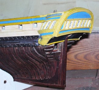

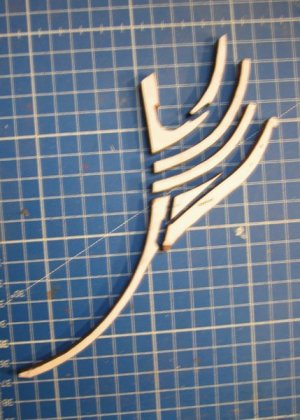

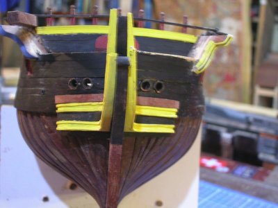

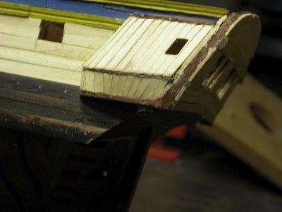

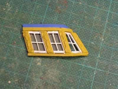

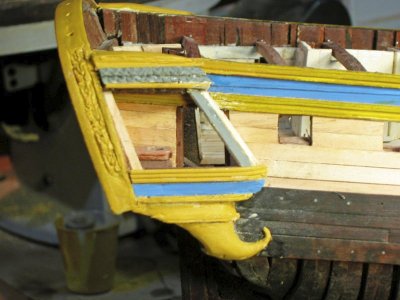

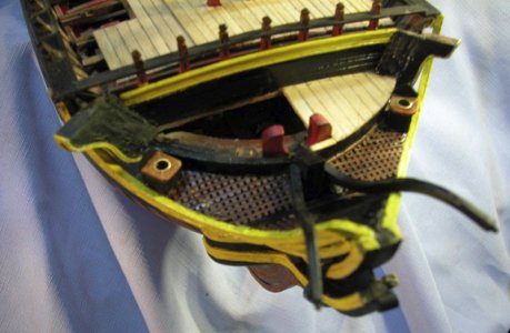

These pics show the piecmeal construction of the head of the ship. As far as I can tell the reconstruction is accurate although I query the use of gratings instead of carlings in the deck of the head. The boomkins are shown as per the plans
I will show the fierce lion in the next post
