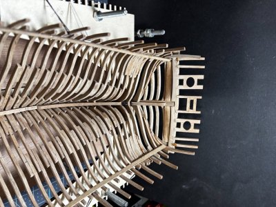

Good afternoon, all, I have not accomplished much this last 3 weeks as far as the Zebec goes. I have accomplished a lot around the house and even made a little extra hobby cash doing consulting work for my former employer (even have a new desktop disk sander on the way). For now, I have finished the framework on the transom and added the odd angled final ribs in place along with those special short rib pieces that form a solid hull area for an oval port hole type opening. I hesitate to show this picture right now, the whole aft end is looking very rough, so I plan on some aggressive sanding, at least as much as I can get away with considering how small the ribs are (2 to 3mm sq.). I will have to rely on my skills to make the exterior appealing, I do not plan on exposing much of the interior. All my efforts at glueing up the frames on the aft end were futile, they simply do not match the notches in the jig and keel at the same time. So, I shall make all this work out and look good to the best of my ability.
Thanks for keeping tabs and until next time hope you have a great time.
And here I thought that after having build the Bluenose another POF would be a walk in the park. Apparently not.
Nevertheless it does look good enough to me and a little sanding will work wonders.
Thak you for your observations Johan, what's disappointing to me and apparently not apparent in the photos are the discontinuity between the aft 6 to 8 rib sets. That is the elevation differences are too great to fare them smoothly. I do have workarounds in mind, and it is going to be an interesting challenge to pull this off.
Your description of the fairing and discontinuity problem seems to be endemic to the process of wood ship modeling!

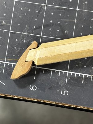

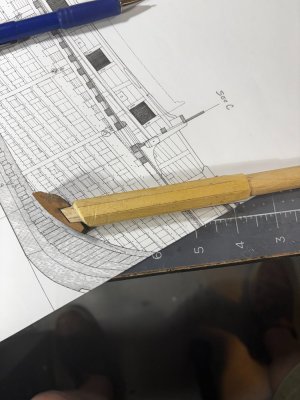

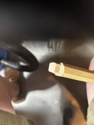

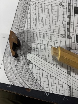

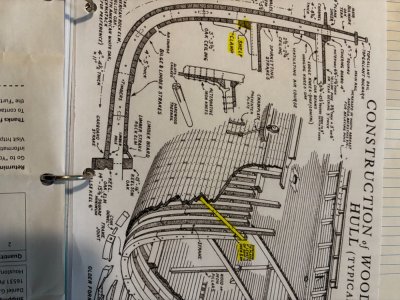

It's been a couple weeks since my last update, not much to show but have added the starboard shelf strake or maybe it's the clamp strake, see drawing below. There are two oddly shaped pieces that go in as fillers I suppose just below the transom beam, not the most pleasant thing to look at but it all gets covered with hull planking. Check it out.

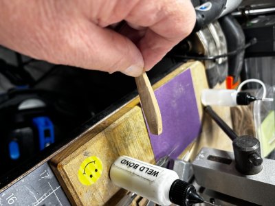

The filler pieces themselves were made up of three pcs. of laser cutouts, glued together then ground down to fit.
This next PDF I copied off the internet showing typical hull wooden hull construction and their names. I always thought the clamp strake went where they show a shelf strake, anyway I call it the deck beam support. The other interesting thing I highlighted in yellow is the use of diagonal tie plates if the ship is over 58m. I've not seen this before. It would need to be counter sunk in the frames to accommodate the hull planking.

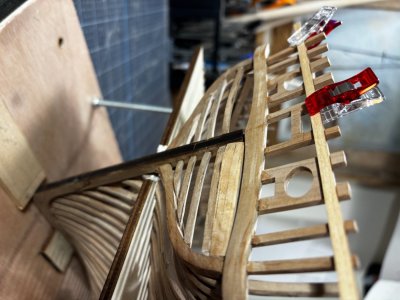

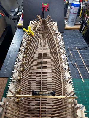

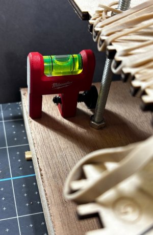

Here is a quick how I did it. After setting the upper and lower starboard deck beam supports, I made sure the base support was level in the transverse direction at both ends. Setting the port side beam support was accomplished by leveling over from the starboard side then gluing the strake in place. I'm counting on this method to provide a symmetrical deck once I have it planked out. Check it out.
As a side note my worktable is just a 4'x2' folding table set up on carpet. During some aspects of my build, I have to level up my jig base board to help insure good symmetry.

It remains an imposing appearance, all those frames in line, Daniel. Now she is getting more strength.
