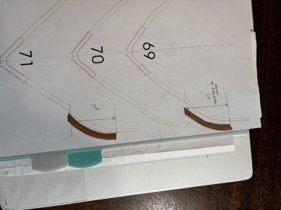

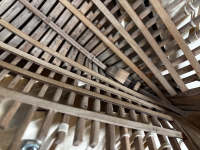

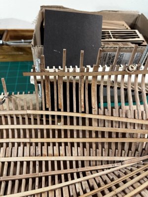

I've been working the 4 gun port openings under the quarter deck (2 ea. side) installing the upper and lower sills. Once again, I am using Boudriot's Monograph as the plates it contains are many times neater and clean than the kits drawings. The kits drawings are poor quality copies of Bourdriots drawings. You will see where I lightly colored in the added ribs used to support the sills via rabbits cut in their sides.
Since these 8 pieces were not included I went back to the rib drawings and traced the section I need on paper and used scrap pieces to fabricate what I needed and glued them in next to their partner rib.

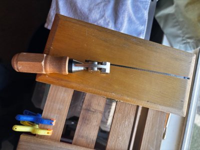

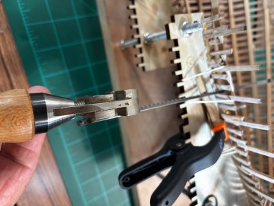

After a lot of careful measuring, it was time to remove portions of the ribs and cut in the rabbits. I made a special hand saw just for this process.

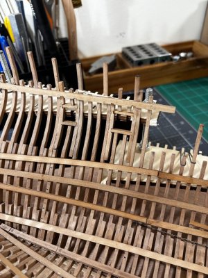

The result on the port side.

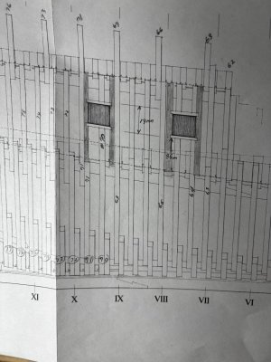

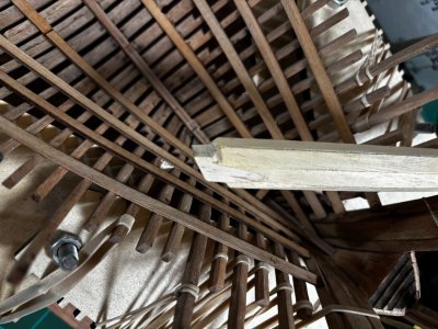

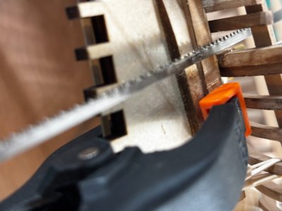

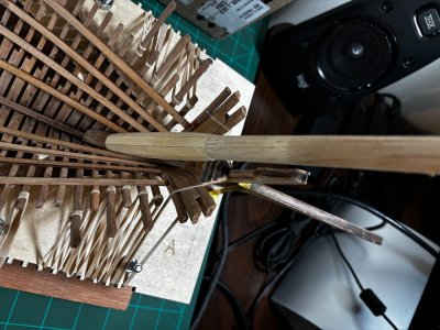

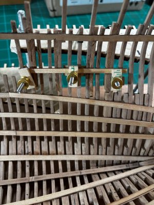

I also set the step for the foremast.
