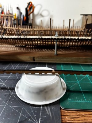

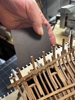

I know what you mean Grant. I have now spent 3 days on 4 little gun ports, the jig itself runs through the ports hindering access which I can't remove just yet, I need to install the rear deck beams first. Oh well, enough wining on my part, next I get to set vertical supports down on the center of the keelson in preparation for the deck beams.
Good evening all,
I reset the vertical partial ribs by filling in with additional ribs sections, this made more sense than removing and replacing the pieces. The width of the aft openings is still 2mm too narrow. I will adjust this after I remove the upper section of the jig giving me room to operate.

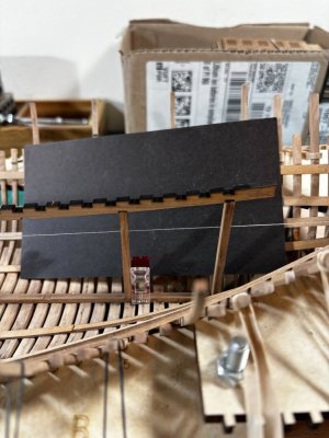

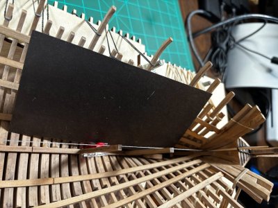

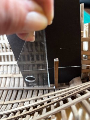

I began setting the lower support columns, they are heavily charred. For alignment I set a stringline on the port side of the keelson and used a 90deg angle off the top of the keelson.IMG_1337.jpgIMG_1338.jpgIMG_1339.jpg
This shows the layout. Typically, one would need to wait till all columns are set and the top longitudinal beam set on them before you would know for sure if the deck beams will set in correctly. I'll need to find a way to periodically check this deck beam fit, it's a lot of work to go through to not have a good fit.
Thanks for checking, till next time!

Good morning Daniel. Whew some serious accuracy needed here. Look like you have it sorted tho. Maybe check each beam as you lay each column - just in case? Cheers Grant

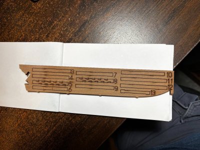

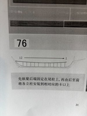

Hi Daniel. Don’t the heights of the posts need to be customized for each deck beam before gluing them in place?

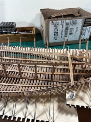

Thats a great question Paul. The post are numbered and have differing lengths. This leads me to assume they have been pre customized but I will not make that assumption. I've set post 1&2 so ill jump over and set the aft post #12 then dry set the longitudinal beam on and check the fit not only of the rest of the post but the deck beams as well.IMG_1344.jpg
Hi Grant, the way I see this now is it's not 1 deck beam per post. I have to set a notched longitudinal beam down first, notched on the bottom to match the post and notched on the top to match the deck beams.

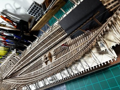

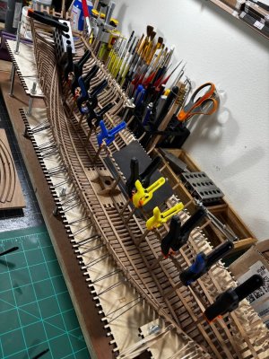

Good afternoon all,
I installed all the post and the main longitudinal timber that sits on them. A whole lot of de-char with a file.IMG_1348.jpgIMG_1350.jpg
Then it became time to check cross beams and sure enough the built in curvature did not work with the center support and the clamp strakes. I used the monograph to get my clamp heights and obviously there is a disconnect between the kit and ANCRE. Not to be detoured I carefully laid out the new required clamp strake alignment, cut the repair piece which is a long-honed strake and glued it down on top of the previous clamp. Towards midship the deck beams fit just fine as you can see by the shape of the fix.
Then I set the first deck beam in, trimmed it to fit and she's good to go. I chose every 5th deck beam to determine the profile of the honed addon clamp.
These challenges weather due to the kit, ANCRE, or bad judgement on my part will not hold me back. Its wood, I can deal with it.
Thanks for looking in on me, have a great one!
