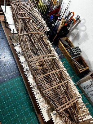

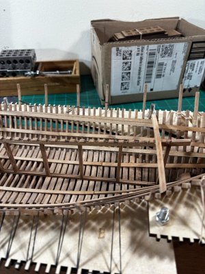

Good morning all, I began placing the deck support beams after making adjustments to the clamp strake layout fore and aft. The ones you see so far, I call the set-up beams, they add rigidity to the longitudinal support beam. Once I finish the set-ups, I will fall back and fill in all the rest.
The cross beams are always longer than they need to be giving you a chance to trim them down to fit. If they fall between 2 ribs, it's a simple matter of marking on the beam next to a rib where to make your cuts. If they hit a rib, I found making a copy of the beam onto a thin piece of basswood, cut out the shape then you can place it between the ribs and mark your reference cuts and transfer that to the actual beam for final trimming. The trimmed piece has to conform to the slope of the ribs and the slope of the hull exactly at the top of the clamp strake.

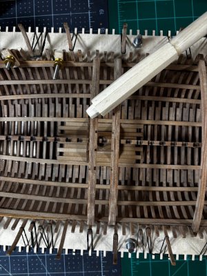

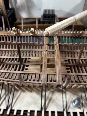

Unfortunately, the mast step does not line up with the opening provided between the two laminated deck beams. I will need to sand down as much as possible on the mast faceted pieces and relocate slightly on the longitudinal beam the notch for the cross beam to accommodate the mast opening through the deck. The first picture below comes from the plans which shows the cross beam slightly covering the mast step below. Now I may be seeing some parallax in their picture but in my build, there is a conflict.

On the Kingfisher the beam locations needed to be precise all along the length of the ship so that other vertical structures could be properly placed (not just the masts). Are there other structures (bitt pins, capstan) you could use to check the placement of that notched center longitudinal piece? (Sorry to be poking around your business - I'm sure you've already studied this extensively - but that central notched bit is where I would begin looking for a solution before I started reshaping things built according to the plans).

I always appreciate your advise Paul. Yes, the logical thing to do is exactly what you say, look ahead for unintended consequences and that is what I will do. There are options I can try, like leave the deck beam where they show it and cut into the beam as required. I need approximately 4mm more of room.

Good morning Daniel. I've said it before I'm sure these kit manufactures deliberately add some Gremlins in just to challenge us..... ROTF . That being said this looks like a really cool kit to build and we all know what a beautiful ship the Le Requin is. I would have a look and see if there are any bits, pumps etc which do go down at this beam. If not and you are going to plank the entire deck then I would cut/sand/drill the beam a little to accommodate the mast. I would not move the beam as this could change the curvature of the deck and the length of the carlings etc ?. Just my 2 Cents. Cheers Grant
