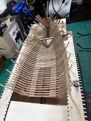

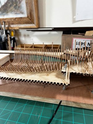

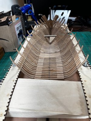

Most definitely Grant. There is something about building a fairly stout structure out of sticks that is very rewarding. Even though the char is a pain in the butt, it does serve as a sanding guide along with the fairing lines.Dremel and dust… must be fun or we wouldn’t do it, right![]()
The Dremel is definitely your friend!Not nearly as boring, tedious, or mind numbing as one might think.Applying a fast sand down with my Dremel almost to the reference lines takes out most of the char then file and sandpaper to fit. Once glued into the keel then just some minor sanding to fair out the frames, internal sanding for fairing is a bit more uncomfortable due to limited access though.

I made a decision a while back to of course fully plank the port side but on the starboard side in lieu of total exposed ribs I will fashion a large window of sorts focusing on the mid-section only. I will still end up sanding out a finish to the fairing process.The glue actually holds better on a filed surface than on a sanded surface. Something else to consider as well is adhesion if it’s a bond surface.
Indeed, it does Peter.I found fairing a hull always requires some serious eyeball and adjustment.
