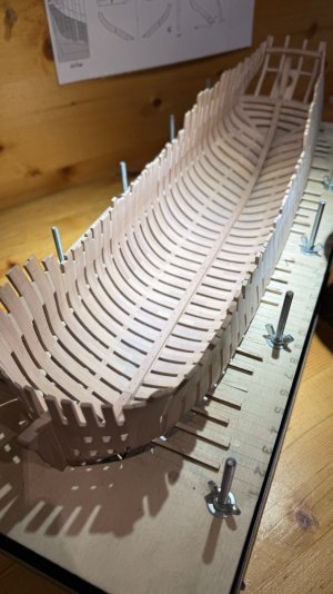

Le Rochefort yacht de port de 1787 au 1/36 ( monographie ANCRE)

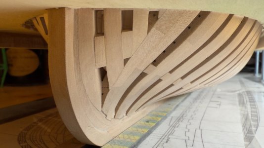

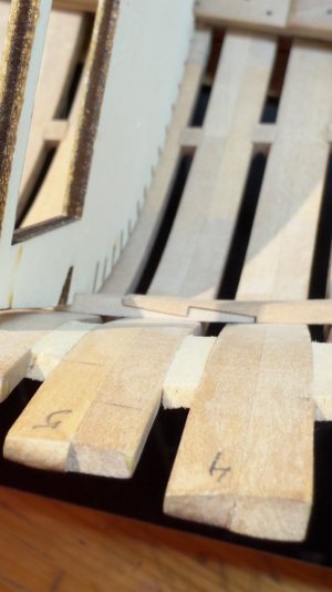

Wow, great results! Hope you don’t mind it a bookmark these photos as reference and inspiration since I’m building the transom and counter now…
Hello merci beaucoup oui bien sûr pas de soucis .
Expliquer moi si vous voulez bien comment les mettre en références
Hello thank you very much yes of course no worries.
Explain to me if you want how to put them in references
To bookmark has to be done by the watcher looking at your posts and not by the author......
BTW: I agree with the words by the others - very good timber work at the stern structure - I like it very much

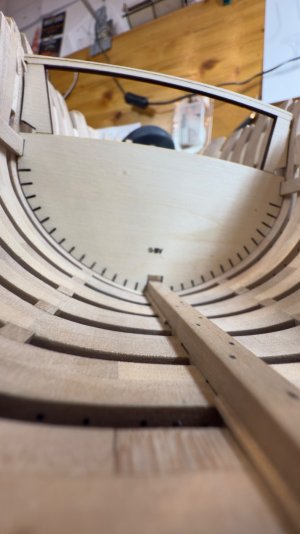

Hello tout le monde
J’ai pas pu travailler beaucoup ces derniers jours
J’ai une nouvelle machine qui vient en renfort par contre quel plaisir de travailler avec
Et bravo à tout le monde , bon salon Tobias
Hello everyone
I haven't been able to work much in the last few days
I have a new machine that comes as a backup, but what a pleasure to work with And congratulations to everyone, have a good show Tobias

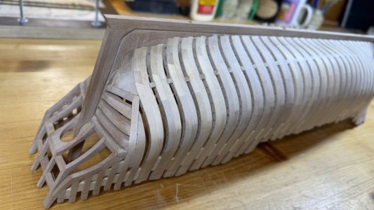

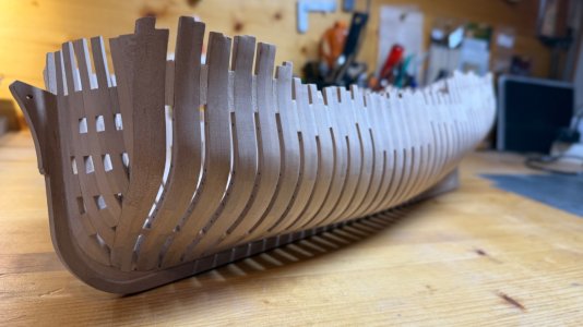

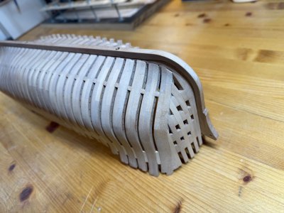

Just great work. Very neat and I like it very much. Good tools and good use of them! For the coating I use artistic linseed oil can be bought in an art store. It is refined and does not spoil, and you do not need to boil it. But if you want, you can boil it) Good luck, I will follow you, very interesting!

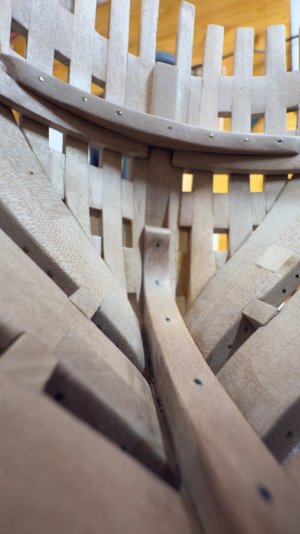

The fairing, sanding and lines are superb!! The detail of the bolts on each frame (10-12 per frame) show your attention to detail and dedication to perfection.
Thank you for sharing the wonderful photos. By the way, your clean uncluttered workshop motivated me to do a little cleanup in mine, in the hope that my work will somehow improve.:)

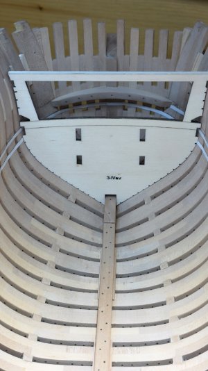

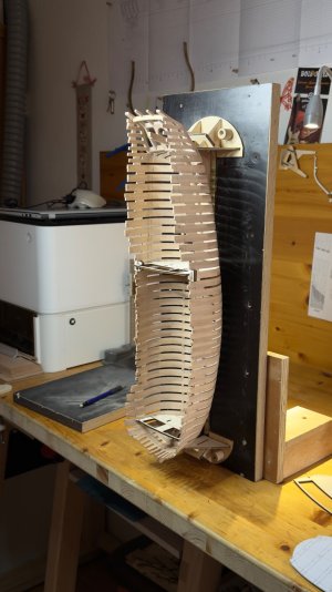

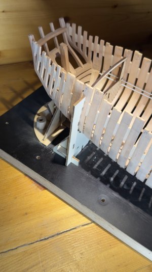

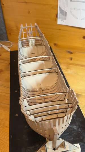

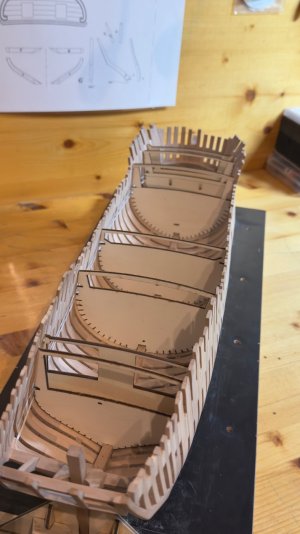

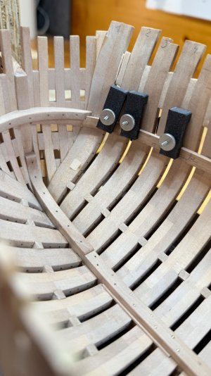

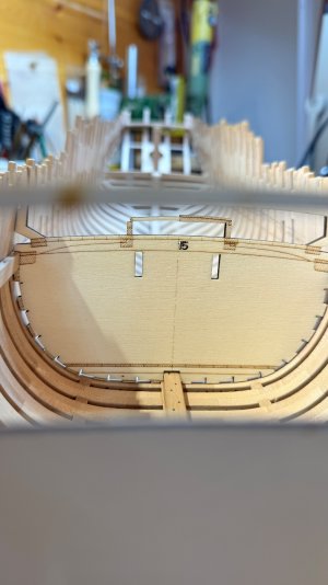

Hello j’espère que tout le monde va
Je traîne j’ai très peu de temps à consacrer à mon Rochefort ces derniers temps
Il faut que j’arrive absolument à mettre les serre-bauquieres

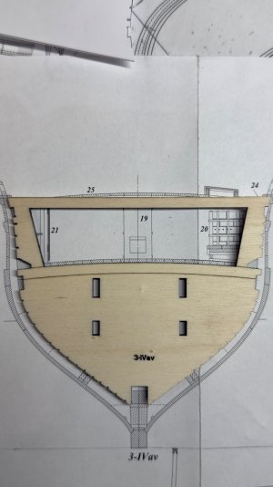

J’ai du mal à trouver le bon niveau, j’ai découpé les gabarits de la planche numéro 11 pour vérifié et tracé les différents bois
Hello, I hope everyone is doing well.
I'm hanging around; I have very little time to spend on my Rochefort lately.
I absolutely have to get the clamps in place.
I'm having trouble finding the right level. I cut out the templates from board number 11 to check and trace the different woods.

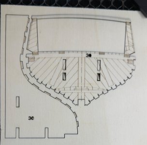

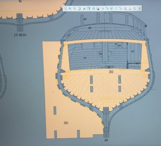

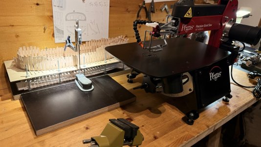

Pour l’extérieur ça marche également.Oui j’ai une petite découpe laser, c’est la partie la plus simple je pense.
Le plus difficile c’est de scanner 100% idem que les plans originaux, bien redessiner et aligner les contours, les exporter vers le laser, etc… avec différents logiciels et du temps ⏰
It works for the exterior too. Yes, I have a small laser cutter; that's the easiest part, I think.
The hardest part is scanning 100% of the original plans, carefully redrawing and aligning the contours, exporting them to the laser, etc., with different software and time.
Merci pour ces précisions ,tu exporte les scan vers quel logiciel ? si ce n'ai pas trop demandé;)
Merci pour ces détails, vers quel logiciel exportez-vous les scans ? si ce n'est pas trop compliqué ;)
Thanks for the details, what software do you export the scans to? If it's not too much to ask
Je récupère les scan dans Creo , après la création de la pièce ,je crée un DXF que j’importe dans Lightburn, que je réexporte en Svg pour pouvoir l’utiliser dans le logiciel de la Xtool
I retrieve the scans in Creo, after creating the part, I create a DXF which I import into Lightburn, which I re-export in Svg to be able to use it in the Xtool software
