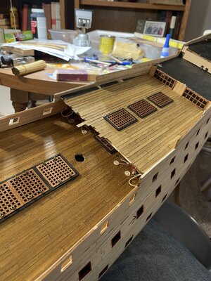

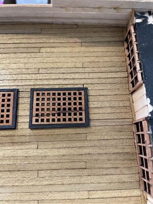

Bad news. I just went through about a hundred pictures of hatches and guess what? None of them have eyebolts and rings. All that work… I thought I had seen a hatch cover with them once and thought they looked pretty cool, but I must have been dreaming. All is not lost, though. Now I know how to make them using two eye pins. These will be covered by a deck or life boats anyway. No loss. At this point I’m not envisioning adding them to the three hatches that will show unless I find some evidence they actually existed on real ships of this period.
Vic, hello. As far as I know, such rings with rings were only on hatches with transverse boards. On the bars, I personally have not met.
Sasha, I guess it’s a good thing they’ll be covered, huh?
How? No more decks are foreseen. Boats? It will still be visible. I propose to carefully get them (eyebrows with rings), and seal the holes with pieces of wood. And then grind the entire grate. Then it will not be so striking. An extreme option is to change the grilles.
I guess made a new one, or replace some parts would be too extreme (I agree with Sasha) but...you can remove the rings and insert dowels into the remaining holes with the same type of wood you have used for gratings or use putty with a similar color. How about that?

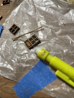

Planking the next level deck. The instructions have it buried somewhere towards the back of the book that I should plank the deck after planking the sides and windows. I’m glad I accidentally saw that. Otherwise, the windows would have been too high. But I’ll plank the inside of the hull afterwards because it will help fill in any .5 mm gaps. A0356FCF-1A97-4947-851B-B8DE45484CCA.jpeg

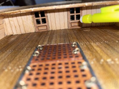

Can anyone tell me why these doors…View attachment 258791
Are so much smaller than these doors?
Doggy door, maybe?View attachment 258793

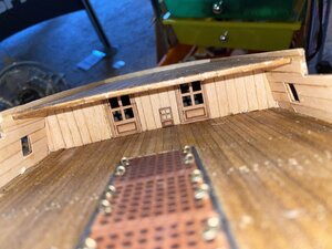

These doors are under the poop deck (4 windows and 3 doors)
See my log: https://shipsofscale.com/sosforums/threads/1669-soleil-royal-zhl.6332/page-4
In fact I lost 1 of the doors (probably dropped inside the hull) and I decided to replace the center door with stairs going to the poop deck
Makes sense?

What you did makes sense, but having doors this small does not make sense to me. When you compare the sizes of the two doors, one must be for Goliath and the other for baby Jesus.
