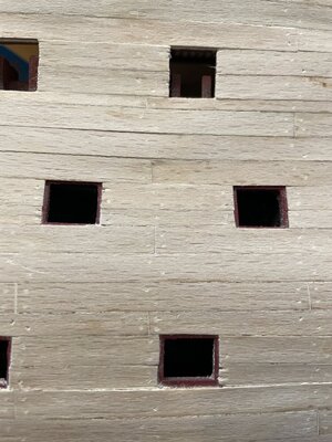

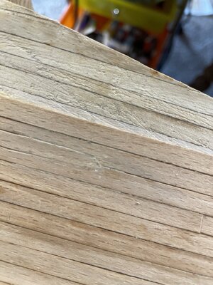

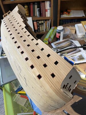

Well, I’m trying something new for me. I cut fake treenail holes in the planking and filled them and the small cracks between boards with putty to simulate caulking . Then I sanded the hull down to the bare wood. After I poly the hull, I’m hoping it looks better than this. image.jpg
Yes, Vic. This is one of the methods to simulate treenails. Personally, I use this method on a small scale, where impossible to make actual wooden trunnels. It should look better, meaning should look darker, but...it is advisable to test on a scrap of wood to avoid surprises after applying the finish. ;)
I totally get it, Jim. I think the Constitution treenails were darker than the oak planks. This is really a compromise. The Admiral doesn’t like treenails at all. I was looking for a way to make them less obtrusive. This seems to work. I did actually practice on a piece of the deck that would be covered with a roof. The color of the planks was different, though. There are two technicalities involved here as well. If I’m looking at a ship from more than 30 feet away, I probably won’t see treenails, and the scale of the ship assures that viewing perspective. Secondly, I can’t imagine there would be any bare wood showing. They painted them, right? So much for realism in our models.

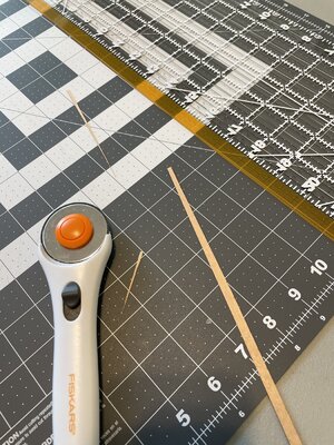

Fiskars makes a clean, straight cut of thin planks. View attachment 261422
Yes, we've used Olfa Rotary cutters (similar to Fiskars) in our bookbinding business for years and I've recently started using them on deck planking as well. The wood grain has to be very tight otherwise they tend to wander but keeping the pressure of the blade against the straight edge is the answer. Certainly a lot more accurate than sanding.
