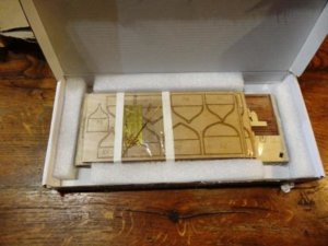

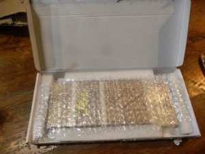

Let's open the packaging ...
and now, let's open the box...
Everything is well packaged, no problem ...
I did not take the picture (sorry), but some boards were very (very) slightly veiled. One night under a stack of books and the next day everything is back to normal.

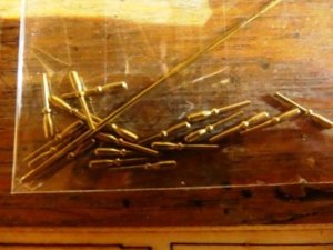

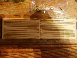

The boards are made of plywood (ribs, positionning plate), sapele (deck, keel, rudder...), maple (oar), cherry wood (hull and some other ship parts)

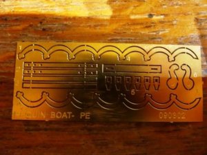

There are also some metal parts in photoetching and others CNC machined.
The laser cutting quality of the wood is good and all the parts seem to be of good quality.
The pieces of wood, for some of them, are extremely fine. Ribs must be 1mm thick. You have to go very slowly when sanding. I only sanded the inside part (visible) so as not to take too much risks ...

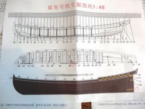

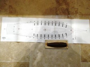

Here are some pictures of the construction manual and the part list of the model :
And here is my little boat next to the shark (in french Le Requin). Who will eat who?
Next time, serious things will start with construction ....

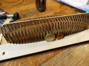

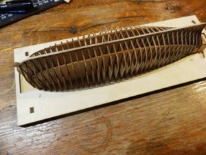

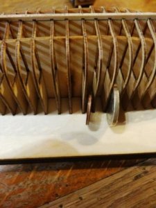

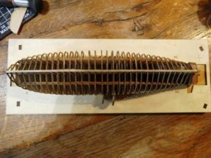

The construction platform has been assembled and all couples are in place.
The original editing system but it does the job. We see that it was well thought out. I do not see how one could achieve the planking without this system.
I just added two small cleats to maintain the squareness of the first rib.
The elements are extremely fine. The ribs are 1mm thick. I sanded them on their inner side in order to make disappear the traces of burns due to the laser cutting. (I am definitely convinced that I have too big fingers ;))
I did not do it for the outer face to not take any risk. Indeed, they are plywood and sanding on the edge is delicate.

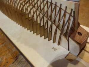

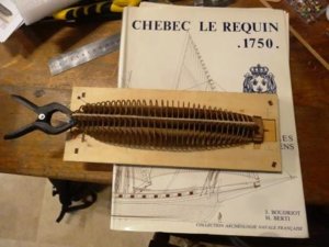

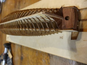

I started to realize the stern. I did not respect the instructions of the manual (text). I realized first the planking of the outer face of the stern so that the boards on the side rests on those of the stern. Obviously, that's how it was done in Boudriot's excellent book on Le Requin
Note that the boards of the stern are not sided or sanded yet.
A photo with the book that is my historical source. I do not advertise but it exists in English and french. Although a bit expensive, it is absolutely reliable.
The link to the publisher's website : https://ancre.fr/en/monograph/18-monographie-du-requin-chebec-1750-.html
