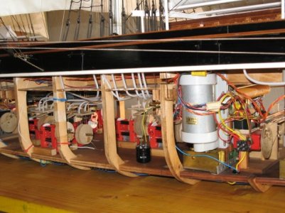

I've looked at loads of convoluted, over-engineered, cat's-cradles and simplified it while still getting the functionality and appearance I'm after.You've created a complex engineering solution that will demand increased maintenance and presents multiple failure points.

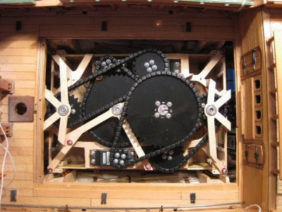

How complex is my set-up compared to...
View attachment 588508 View attachment 588509 View attachment 588510 View attachment 588511 View attachment 588512 View attachment 588513

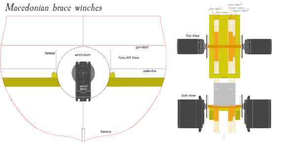

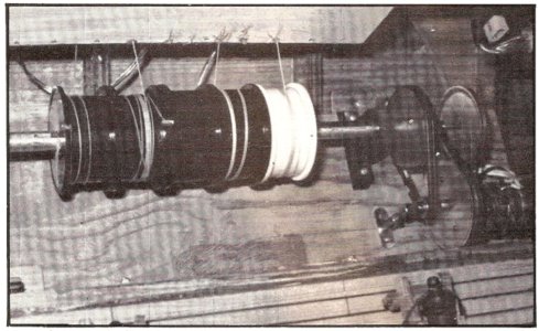

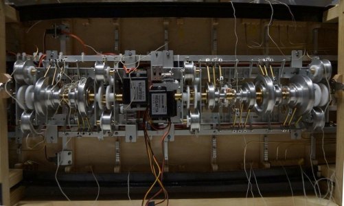

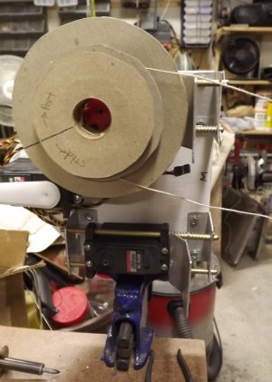

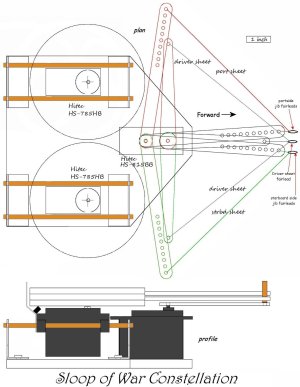

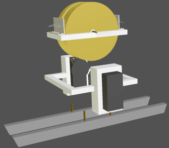

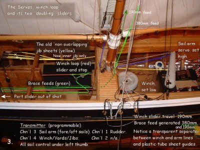

What you see as complexity is no more complex than remote controlled window blinds. I'm controlling only three of 12 yards, with two winches,designed to be accessible and removable if something needs servicing. I'm not bunting or furling any sails, no search-lights, radars, running lights, sound effects, firing guns, or any other fuwafuwa gimmicks.
The level of complexity is higher than a one meter yacht because remotely controlling a 19th century full-rigged ship model that weighs 80-100 pounds is more complex than a 2-sail sloop with a self tending rig.
My Constellation already successfully uses a more complex set-up than I'm planning for Macedonian, and both models use only 4 channels (rudder, fore-n-afts, fore-mast, main/mizzen-mast).
I, and I'm sure others reading here, would like to see your idea of how to set this up on-deck as you suggested.
Macedonian won't have deck houses to hide winches in, and I'm certainly not going to have exposed servos on deck. Why do you assume my set-up will be prone to fail and unserviceable? I already have a model that's sailed several times successfully. I want my models to operate realistically, and that means braces routed as the prototype was, and fore-n-afts not sheeted right to the centerline.

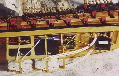

You do realize pretty much every traditional style RC model boat has it's controls below decks; even the Bearospace boats.

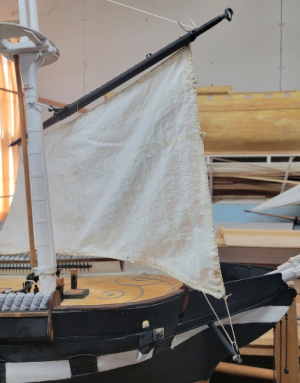

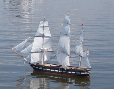

The only failure here was a t'gallant clew coming unhooked: Constellation on the Miles River
for waterproofing try uv resin sometime.As noted; this will be a working-sailing model 1/36th the size of the original. All my labor should net a model with the following dimensions:
This model will be smaller than Constellation which, in fact, is about the size of United States compared to her.
