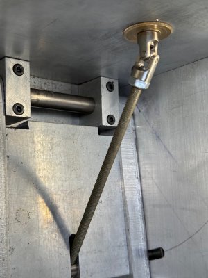

Byrnes Inspired Saw - the height adjusting mechanism
After considering several alternatives, I decided that the Byrnes method was the best fit for the purpose of adjusting the height of the sawblade above the worktop.
It does require a universal joint, which I purchased from AliExpress, but has proved to be the weak point of the mechanism. The pins in the joint are fairly loose in their holes, and they make a noticeable creak in some positions. Quite disconcerting. I am considering removing the pins and installing larger, better fitting ones. Also, the "Allthread" rod needs to be changed for some silver steel, lathe threaded only at the main spindle end, because the Allthread is a bit undersized, and is a bit eccentric in the universal joint socket. . (This confession is in the spirit of my previous comment about admitting difficulties and failures.)
The mechanism works OK. It is just not as smooth as I would like.
The photos show the upside down saw bench.
The locking mechanism works really well, and I think that it is a better method than than the original.
The close up photos reveal that my knurling is a bit rough, but I can live with that.
