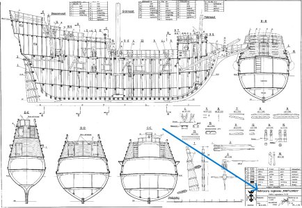

The Chinese promised to send the electronic drawings on Monday. I'll hold off on assembly for now. The existing drawings are simply awful. It's impossible to measure a single distance (poor print quality). I made blank gun ports for one side. I hope I managed to measure them correctly. I won't install them. I'll wait for the electronic drawings.
I received the drawings from the Chinese. It turns out there was one drawing missing from the set. A very important one. Therefore, the deck planking will have to be redone. It's as shown in the instructions (item 44) and as it should be. They pointed this out to me yesterday. And, as it turns out, the Chinese copied the drawings from a Polish model from 1976.

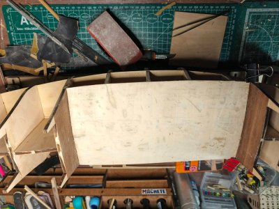

1. The keel frame doesn't have any mast mountings. According to the instructions, the holes are drilled after the planking and deck is built. This is probably not entirely correct. The plywood will delaminate. While the sides are open, I'll probably drill them now. I'll also file the mountings to the correct size for the masts. I need to check the length of the mast blanks to understand the groove depth. I'll also cut out space for the roof grating on the upper deck.
2. I don't know why I decided to measure the deck length. The fact is: According to the drawing, its length is 276 mm. In reality, it's 255 mm. I'll probably have to recalculate everything.

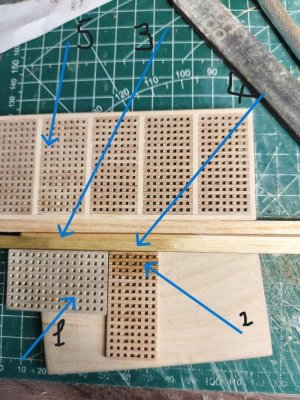

Был в командировке. Решетка из набора мне не понравилась. И материала не хватает. Сделал рустерные решетки из бука. Палубу буду переделывать. Пока не определился с цветом решеток. 2,3,4 - морилка орех. 5 - решетка без покрытия. 4 - палуба. Что посоветуете?

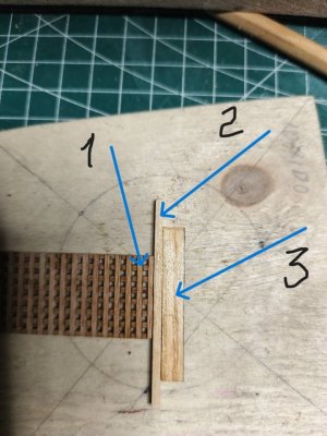

Continuing my experiments. Only tung oil. 1 - grating, 2 - coaming and waterway, 3 - deck. I like it. One more question. What do you think? Should I cut openings for the grating in the deck? Or just paint the area under the opening black?
The tung oil looks good. The wood grain is visible. Cut the openings, leaving and thin edge all around to support the grating on all four sides. Leaving the black painted deck underneath can sometimes remain visible up close. Opening the deck and painting the visible surfaces of the hull interior black creates the illusion of spaces and decks beneath the grating, even if they are not there.

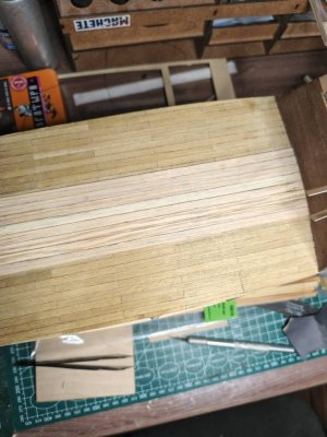

I'm very upset. The deck is turning out very ugly. The tone is different. It's not glued yet. I need to find a different wood. I have oak. I'll try that.
What sort of appearance are you looking for? do you have any pictures as examples? Oil and stain have great influence on the deck appearance, as does choice of wood. The planking port and starboard looks acceptable to me, but the long strips in the center have long straitions of darker course grain that are far out of scale. Oak is a porous wood, and that may not look good for a deck because thes larger, dark streaks will appear as large darker stains on the deck of a small model.
Not quite so. I didn't remove the old deck. The port and starboard sides are it. The middle is the new deck. I don't like it. I removed everything. I'll try oak.
If you can find photos of the Vasa, (approximately the same time period) you will note that the decking has a haphazard, random appearance. It appears that the builders were more interested in making use of available timber than following planking rules.
