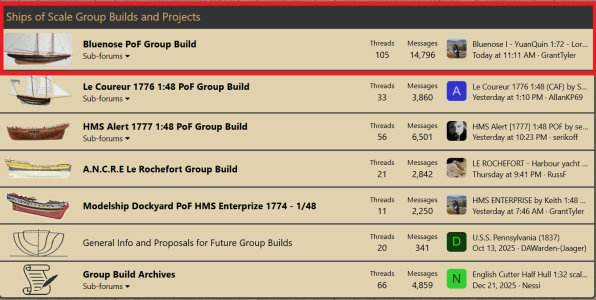

See below the group Build of the YuanQing Bluenose which has been built by more than 60 SOS members.

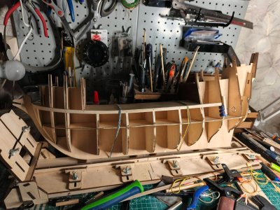

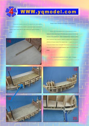

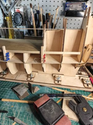

I'm building the upper deck. I'm studying the instructions several steps ahead. They recommend installing gunports on the lower deck. There are no guns included. Question: Was the ship armed? If not, why cut gunports? They are covered with covers. If the ship was armed, I should probably buy 17th-century guns and install them on the lower deck. This needs to be done now. After the hull is planked, this will be impossible. The anatomy of the ship "Susan Constant 1605" lists eight guns. These are similar ships in historical period and design.

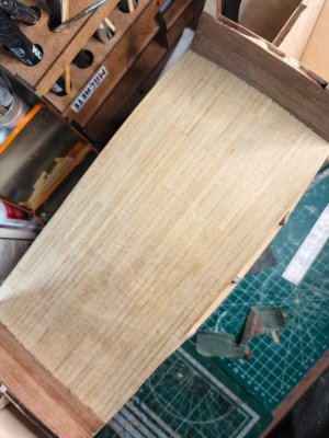

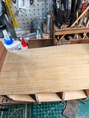

This is how it turned out. I don't like it. I'll have to redo it.
This appears quite salvageable. Don't sand in a cross-grain direction. Sanding those cross-scratches out will be some work. I suggest you use a razor scraper to scrape the deck until those scratches are removed. Take your time and scrape in slow, even, overlapping strokes. Scraping the deck smooths it and evens out any offset planking seams. It will look BETTER than sanded. Use sanding sticks to get close to the bulwarks and in corners and always sand along the grain (fore-aft). After that, finish the deck with oil or varnish and you're good.
Use this: $12 on Amazon.com
It's not actually sanded yet. I use a regular metal straightedge for sanding. I just don't like the deck. Thanks for the advice. I'll be looking for such a device.

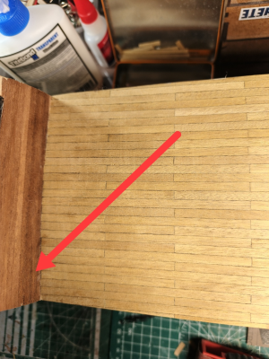

I don't like the place where the deck and bulkhead meet. There shouldn't be a gap there. Maybe I should install a baseboard? Was that what they used to have on ships?

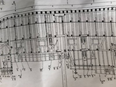

Not very funny. I think the chamfer worked. I haven't decided on the gun ports yet. I'll probably do it myself. The kit is quite complex. A lot is unclear. I compared the plans with galleon plans from the internet. The Chinese made the kit, as I wrote above, "Made from scratch." We'll give it a try!!!

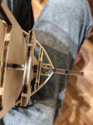

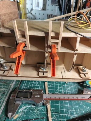

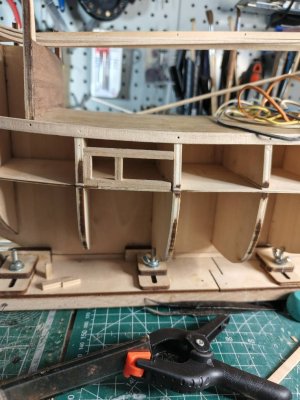

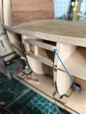

I have a friend. He assembled a model from "MarisStella (Croatia)". These models are more like blanks. You have to think a lot. He spent about two years making this model. Our model is very similar. The drawings are of very poor quality. I requested them by email. I decided to make the base for the gun ports according to the instructions. I asked about this above. How does it turn out? See the photo. It doesn't look anything like the instructions. I'll have to saw it. I didn't use the 3x4 planks from the kit. I had some 1.5x4.5 planks from "Oссre" left over. I glued them together. The size turned out a little larger.

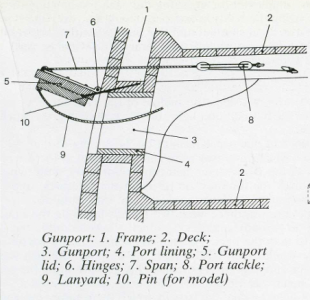

I don't understand the purpose of this design at all. None of the authors (Hoving, Laveri) have it. It's in the drawing from the kit. If this is historically accurate, it should be done. But this detail won't be visible on the model. Maybe we can do it this way? And it would be easier to correctly set the distance between the gun ports. That's strange. They differ in the drawing. The documents provide precise data between the gun ports depending on the gun caliber. They should be the same.

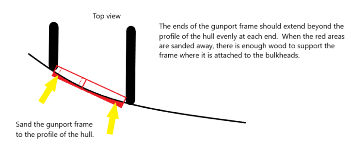

The wood used to frame the gun ports on your model does two things. 1) It makes the hull appear thicker on the model, because you will not be making the interior planking. 2) It supports the ends of the outer planks around the hole of each gun port.
