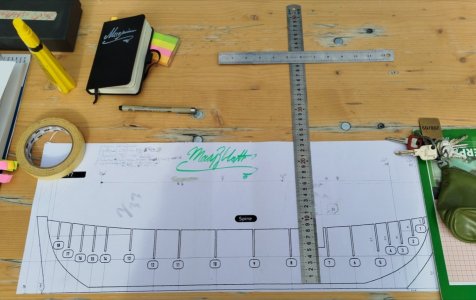

I ordered DIN A2 bookbinder's cardboard and the spine doesn't fit - even laying diagonal by some millimeters.
So I cut the spine into two and placed her on top the 1mm cardboard:
I could not go to bed this night before the very first layer was cut out. The next layer is cut near bulkhead four - and so the laminated spine-parts do fit together giving a stiff 5mm thick centerboard. Being glued together, than the slots for the bulkheads will be added by the use of my trusted Proxxon table saw.
So this night I worked it out this way:

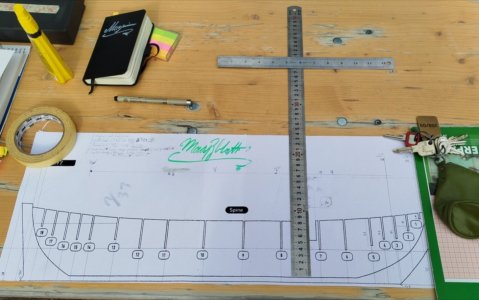

Hello colleauges, fast steps foreward are a great thing to have - after my experience in 1/44 a lot is easier here in 1/33 scale.
Today I worked with the spine. As my centerboard is a bit longer than the DIN A2 sheets - I decided to change to my pile of 2mms bookbinder's cardboard. By this the hole 5mms thickness is build by three layers.
I also was in need of a single sheet per part:

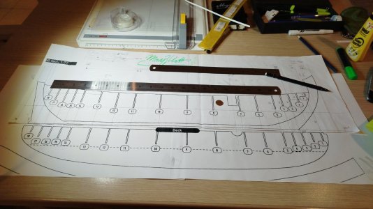

I positionated the parts in an overlapping pattern for more stability. I measured the mid between stem and stern and took there just the very half at 162mms for my slots outside:
and also added the stand's pair of slots of 5×10mms stanchions to keep the boat upright:
So now I am awaiting my glue to bond.

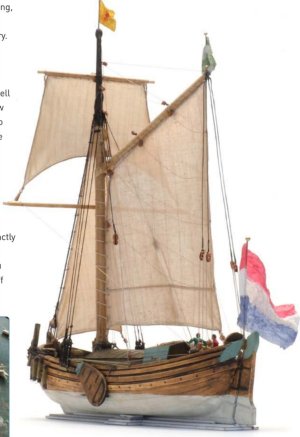

Hello Chris,
I see you chose the standing gaff rig for your wide ship. This rig is actually the same as what was used for Statenjachten. Here is a picture that is applicable:
As to reinforcements of the hull: I suppose you have cut the hole for the mast into your spine? If you execute the foot of your mast as a fork, fitting over the spine you are sure that the mast is upright. It might be wise to reinforce the location of your channels, because you are building at a relatively large scale.
The ratlines on the shrouds are not necessairy.
Good luck.

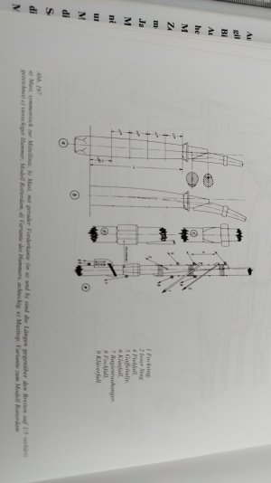

According to Ab's great advice, I started leafing through my books shelf I found Werner Jaegers highly detailled book
"Die niederländische Jacht im 17. Jahrhundert" (The Dutch Yacht of the XVII. Century).
In there are big table's of yard, mast, and other dimensions, to the very most intrest to MEERMIN are these two drawings on the page 192
and 212 together with all the data that will help...

Dealing with the mast W.Jaeger "Die Nierl.Jacht im 17.Jhdt." p.180

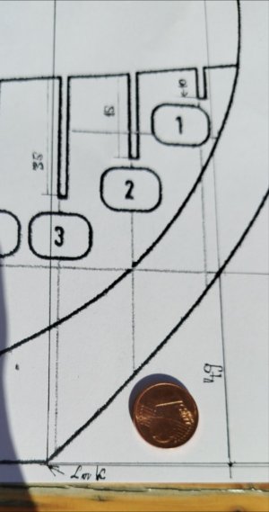

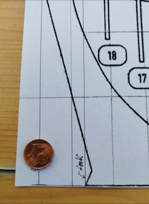

My question is certainly: Is my Length of Keel (LaK) starting and ending in the right point...
...or do I have to change these both or one of them?
Thank you very much fur your intrest and support.

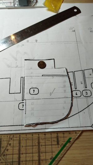

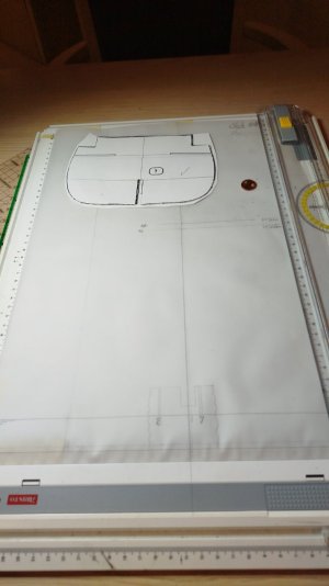

This evenig I was able to deal with my 1/2-scale drawings for the mast and got these:
So here the close up to the bulkhead that dors fit very well into the spine:
Also the testfit of the deck and spine looks very well:
I have figured out some parts are to be enleaged by 100,4 to 102,3% to fit Sick
...yes I know it is all about "allowances"*.
