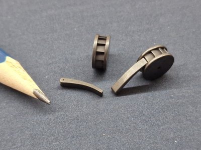

Now I want to show you the results. I'm not 100% satisfied yet, but given the potential, I understand what they could be. But even this result is quite good. I blackened the parts. I sanded some, and not others, to get a feel for how each surface would look. But conclusions have been drawn, and I hope the next test will finally be conclusive... and then it's just a matter of manufacturing all the parts using this algorithm...
