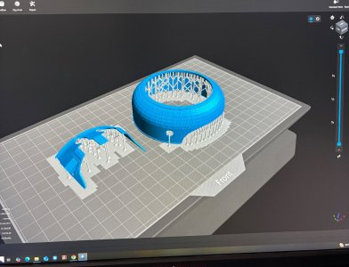

This may be too late, however I now have a resin printer. I have to find those CAD files I created so I can export STL files to use in my slicer software. Then I can actually print some of these for those who may be interested. I will give an update on the status.

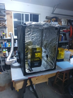

The resin never trips my air monitor. But the IPA wash does. I keep the wash tub covered during rinses. And you could always install a vented enclosure20240106_075019.jpg
Those enclosures are nice, but do take up a lot more space unfortunately. But I’m still leaning towards getting one. ;)
Amazon carries many different models so look them over carefully, you can find a size you can live with. Its important that sunlight cannot affect your printer. And depending on your printer, have enough room to remove the cover. And venting with a fan might be a consideration. (I no longer even run the vent fan.)
