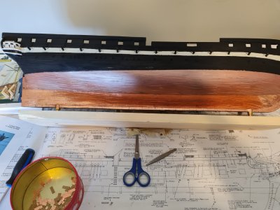

I decided to break up the coppering of the hull in two bands. Band 1 is rows 1 to 7 and band 2 will be row 8 to end. The reason for this is because I don't want any crowding at the bow, amongst other things. So what I did is at row 7, I used some pinstriping tape to get a straight line between row 7 at bow and row 7 at stern. I still used rectangle tiles just made more overlapping.
One thing I noticed is that when I rub the copper plates with the handle of a screwdriver, some of the shininess goes away. I still want to simulate verdigris, but I found this little bit interesting.
Here is a photo of my progress

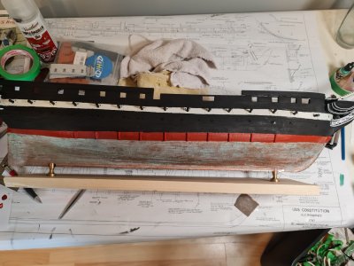

So after some testing with salt water and vinegar, I decided that I wouldn't dilute the vinegar. I put one teaspoon of salt in some vinegar and used that as my solution.
I then applied the vinegar solution to the copper plates on the hull using a paintbrush.
Over a period of 24 hours, I applied several coats of the vinegar solution. I am going to let in react for another few hours, and I may need to add more of the vinegar solution to the copper. I noticed that there are some copper plates that need to be replaced because I think the liquid got behind the plates and dissolved some of the glue. No big deal I have tonnes of tape and patience.
Once I am done the patina stage, I'll go ahead and apply a coat of clearcoat, matte finish, to lock in the colors of the patina.
I will add that the nail pattern on the tiles is completely overshadowed by the patina. That's ok with me as I didn't like it anyways.
One thing I am not sure of is the uniformity of the verdigris. I mean on a real ship, can one expect the entire coppered hull to be uniformly rusted? I don't want to do this for days and days. I applied more of the vinaigre/salt solution and I think that will be the last. Next once it is all dried I'll apply some poly to protect the look.
A natural patina is going to have quite a bit of variation to it, but at scale. Yours looks quite good. If you wanted to even it out you could try a gentle wipe with a soft dry cloth.

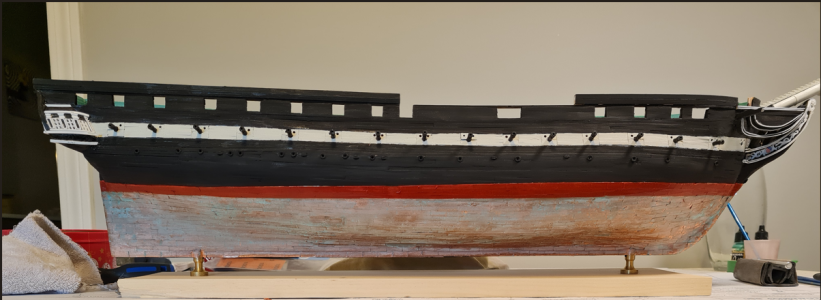

Just have the fenders left to install on the starboard side. The red stripe shown is 1/2 inch wide. I know that it looks crooked but that's an optical illusion. I checked the width many places and it's 1/2 inch. It's a little annoying that the photos come out this way. It doesn't show the complete picture of what is actually going on.
It is said photos don't lie. They do all the time. I can relate to the frustration of "Why don't these photos show what I see?"
She's looking good. Forge ahead.

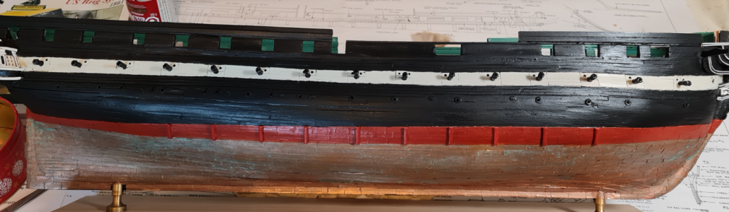

Here we are. The fenders have been installed on the starboard side and painted. I will put some poly on when the paint has dried so as to protect the patina.
As you can see the reaction has gone further. I am pleasantly surprised that it turned out like this. I thought it was going to be "blotchy". I guess properly cleaning the surface before applying the vinegar/ salt solution helped. I took some liberty with the width of the red stripe and the fenders. The fenders are 5/8 and the stripe was 1/2. I decided to make the stripe the same width as the fenders. I find it looks better. Also, I painted the fenders red.
So because the fenders had to be glued to the hull, I had to shape the backsides so that they sit flat on the hull. To do that, I put a piece of sandpaper on the hull and sanded the fenders until they took shape of the hull.

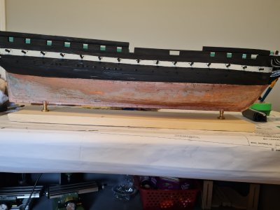

Well, as expected, the poly reduced the amount of verdigris on the hull. I like the look better than just verdigris because it shows the copper as a brown with a little bit of verdigris. Now onto the port side. I must say that I am not really enjoying this step. It's boring
