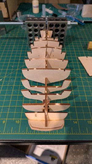

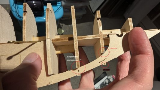

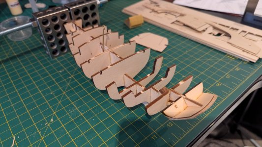

I've recently just begun the planking stage, but rather than jumping right in there, I'll preface with a few posts from the original log pictures I took. This kit has a decent amount of quality control issues so some of the pictures may be a little hard to understand without the text context, and I'll leave some of those out. Feel free to ask for any clarification, or if I have any specific photos.

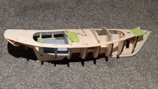

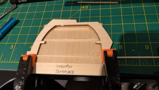

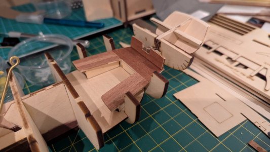

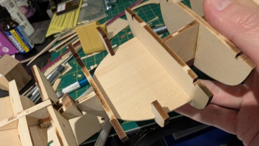

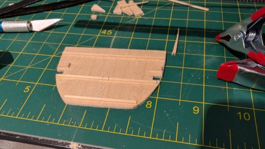

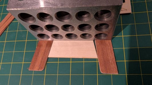

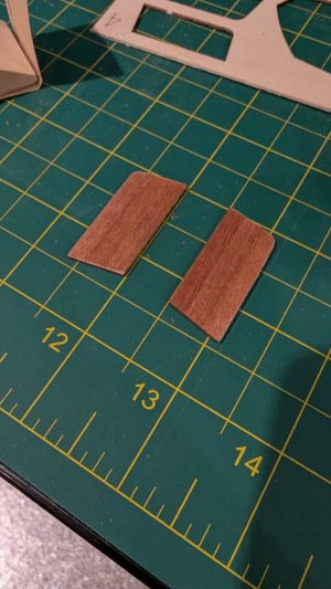

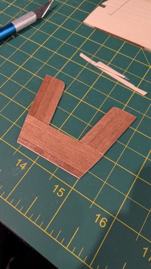

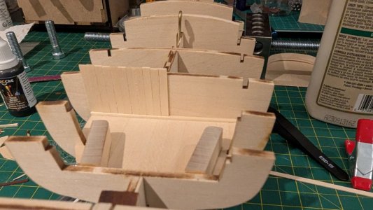

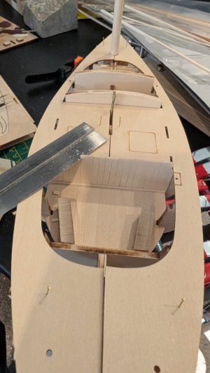

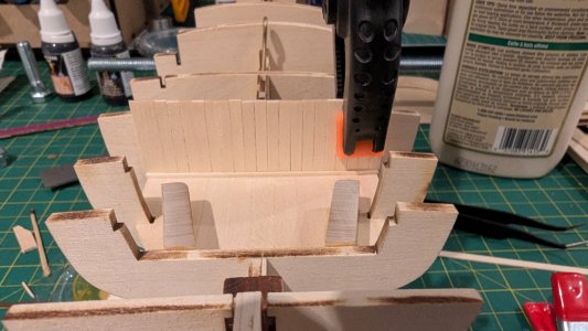

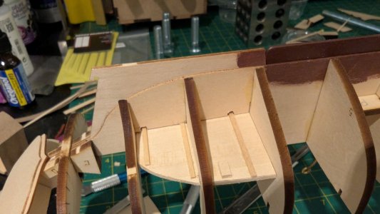

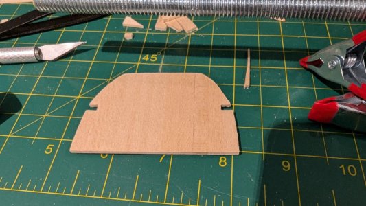

Shown above, I planked the seats with mahogany strips. Coming up, I also scratch built the cockpit floor out of strip wood.

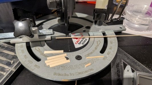

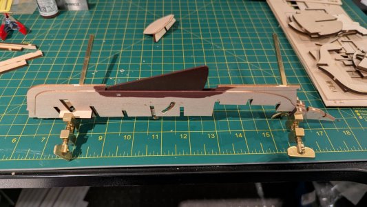

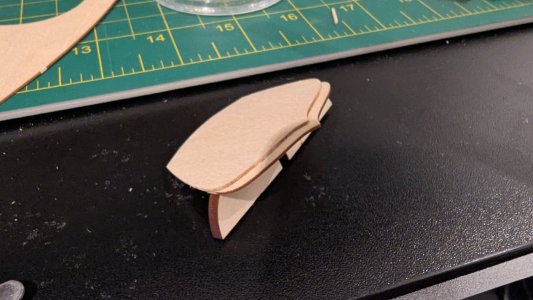

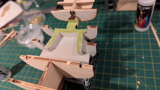

Slicer is lovely

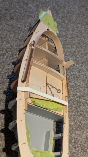

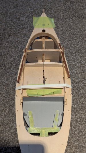

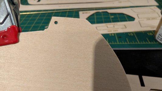

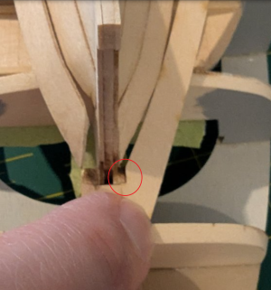

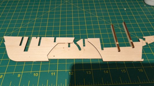

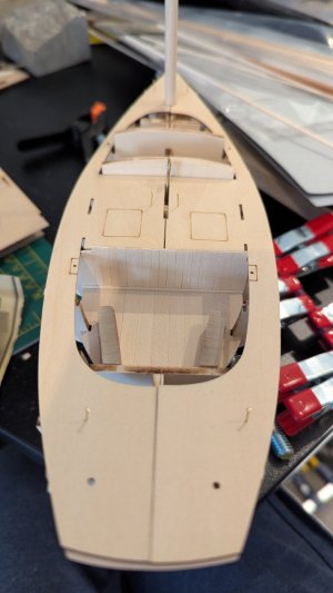

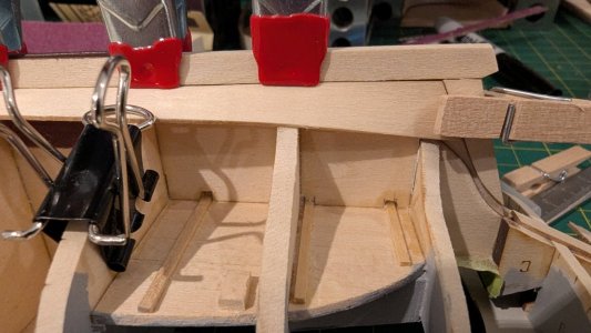

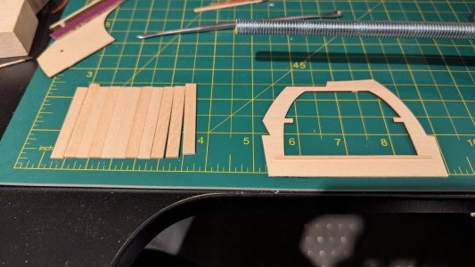

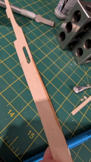

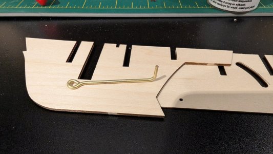

More QC issues, the cabin walls had some sort of oil and laser burn at the same time. The wood was stained, and crumbly.

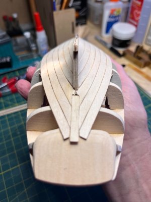

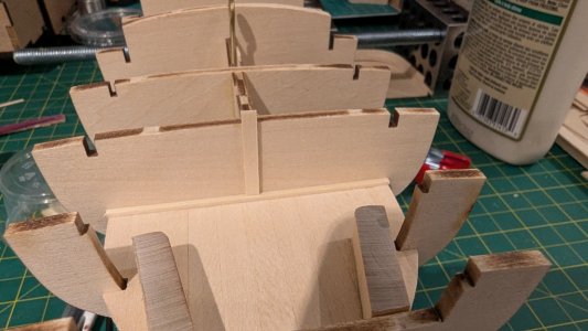

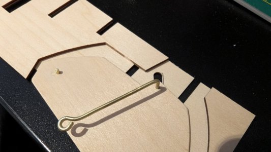

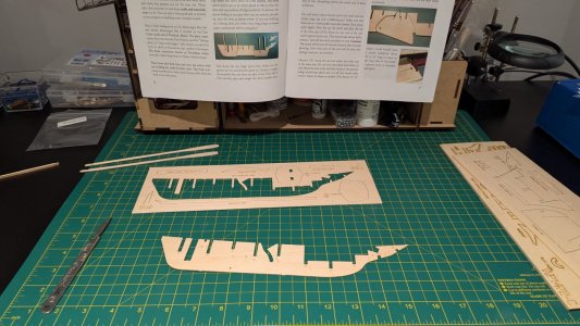

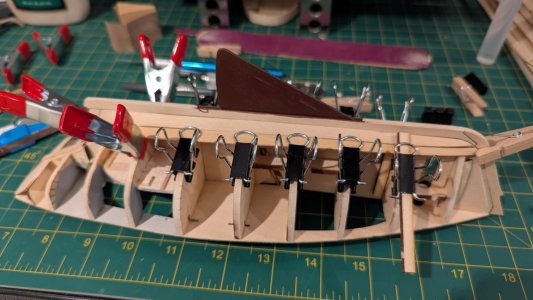

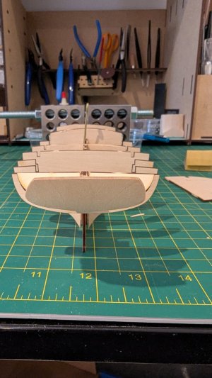

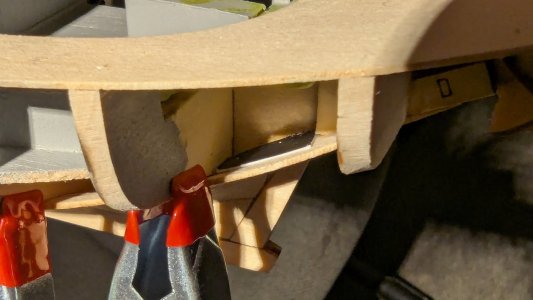

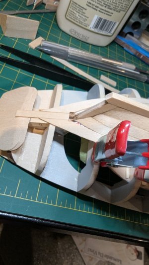

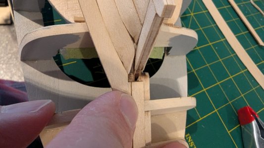

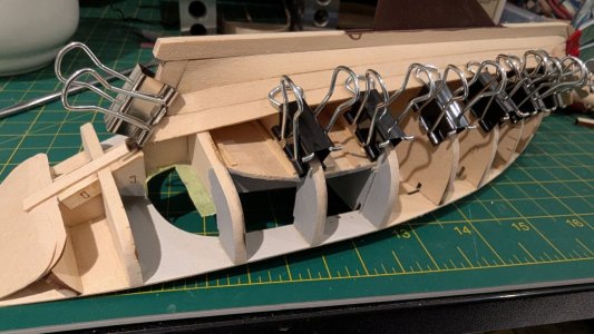

On to the planking. The presplied planks aren't the most ideal since they rely on a 'perfectly' faired hull and no two hulls will be identical. Nevertheless, trimming, sanding, bending and finally filler and paint will eventually do the trick.

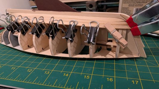

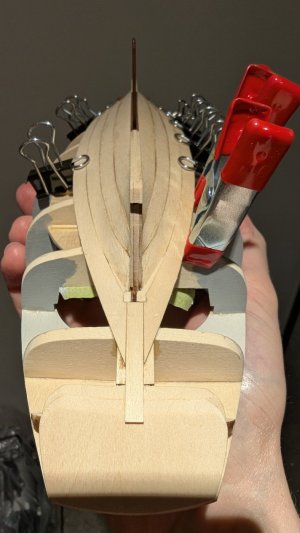

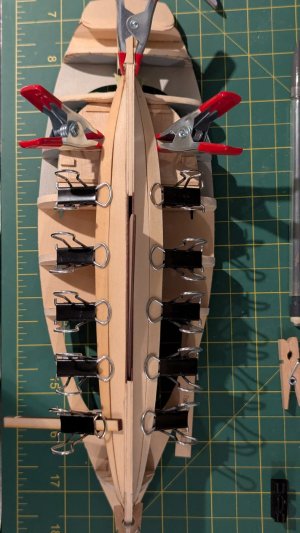

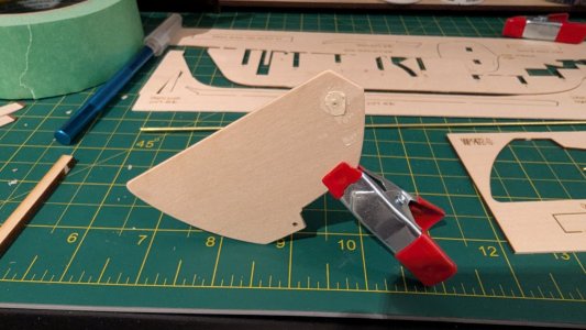

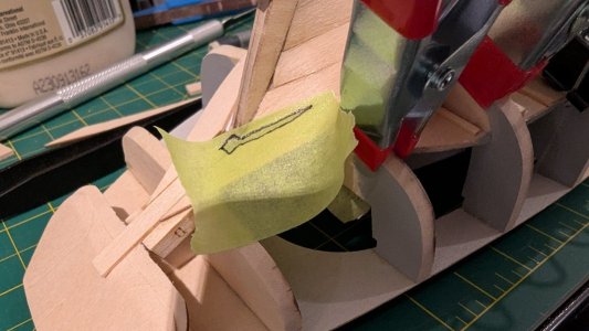

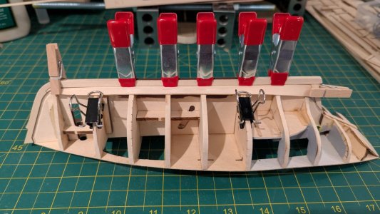

I formed both garboards and both first strakes before I glued anything in.

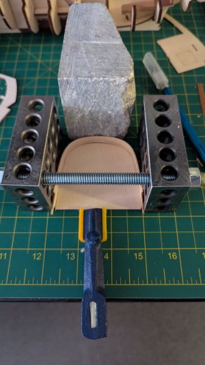

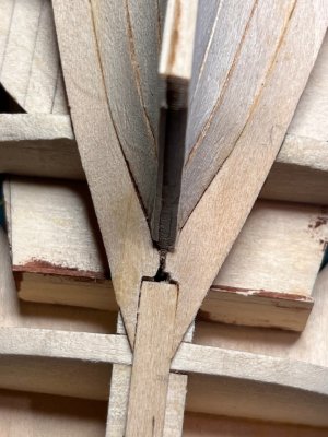

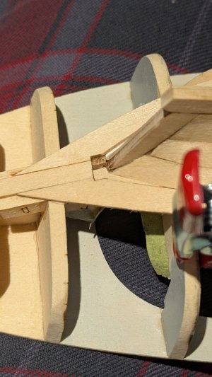

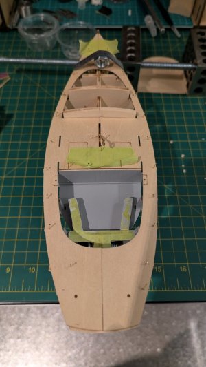

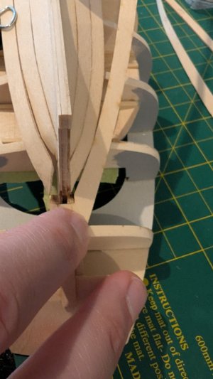

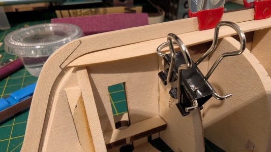

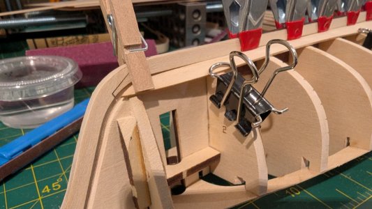

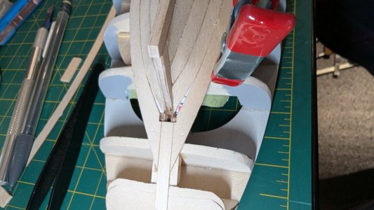

And we're basically up to date. I've trimmed in stern end to fit the rabbet, and needed to wet and reform them since they weren't in the rabbet the first time the bend wasn't quite enough. I think I'm going to have a bit of a bad fit on these ones, but we'll see in the morning.
