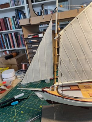

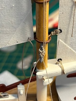

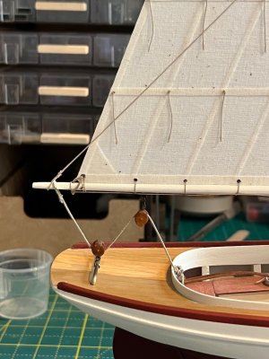

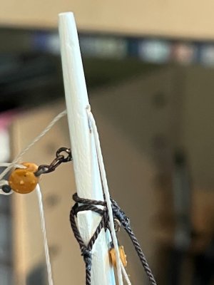

I added the topping lift this morning.
View attachment 609654 View attachment 609660
I think I even belayed it properly.

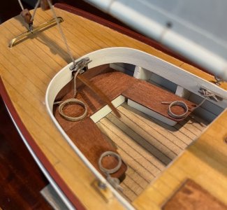

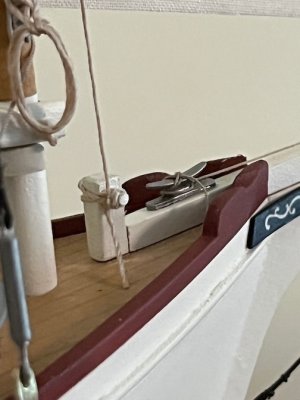

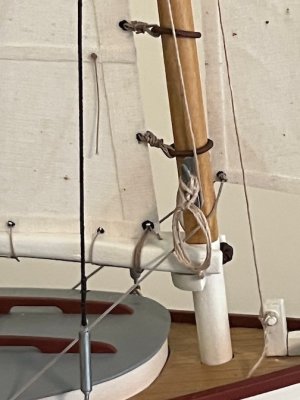

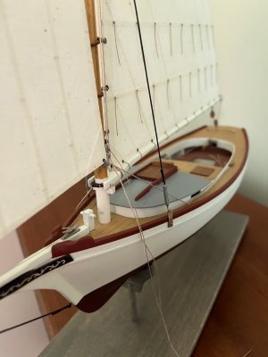

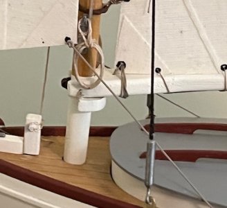

After that I worked on the rope coils and hanks. I used the Syren coil and hank making jigs, which worked well, especially after I realized PVA glue doesn't stick very well to polyester thread! Getting the coils for the main and jib sheets properly situated was tricky. I used 5 minute epoxy to fix the lines where I wanted them, and then added the coils. The epoxy was probably a mistake, as it is shiny, but I wanted to have some time to maneuver the coils.
I then made two hanks for the throat and peak halyard.
View attachment 609655 View attachment 609656
I decided the port cleat was crowded enough, so I took artistic license and left out the hank for the jib halyard.

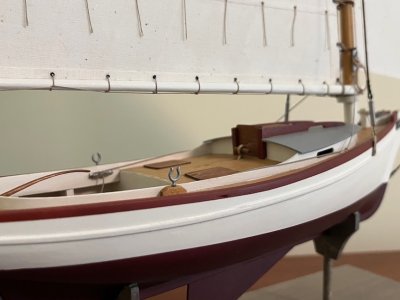

I then cleaned up, painted and installed the oarlocks.View attachment 609659

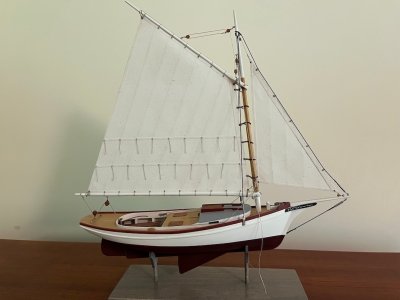

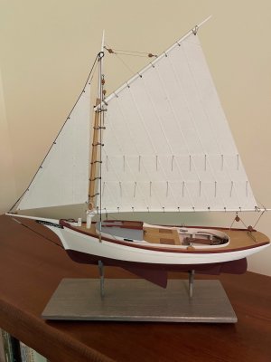

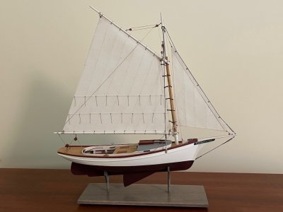

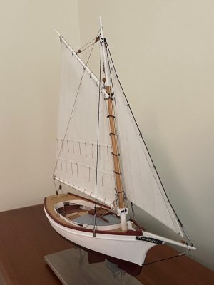

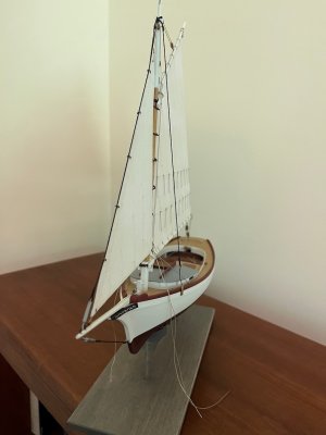

And with that she is complete!
View attachment 609658View attachment 609662

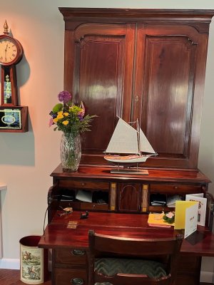

In her temporary berth:
I really enjoyed making this kit, despite some frustrations with quality control of parts and sometimes vague instructions. I learned a great deal about model making, and feel like my skills have improved considerably. Overall, I found this Model Shipways 3 boat kit a perfect introduction to the hobby, and I would recommend it to anyone looking for their first wooden ship model build. I now have the confidence (and more importantly - the skills and understanding of how kits are put together) to tackle much bigger projects.
