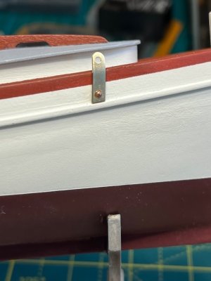

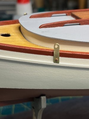

It was a glorious weekend here in New England, so most of my time was spent outside, in the yard or on my real boat. I did manage to make the second chainplate (and center the holes much better) and install them both. I bent them before installing them 2.25" behind the trail boards. I marked and drilled holes using a #70 drill bit, and trimmed the brass nails before inserting them. They are only going through the sheer strake, so are mainly there for show. I used CA glue to attach the chainplates before inserting the nails.

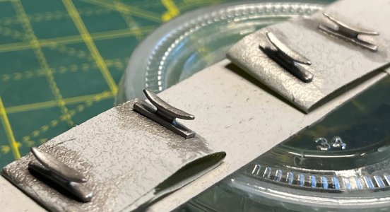

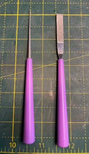

I then cleaned up the cleats using diamond jewelers files. They did a great job. You can get a set of 5 different shapes very cheaply on Amazon.

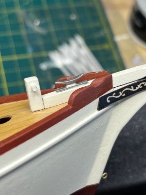

I sprayed them with gray primer, and then painted them with Folkart Metallic Nickel craft paint, hoping to mimic galvanized iron. My research indicated that bronze was also used, but I that seems excessive for a working boat. I understand the iron would eventually turn black, or be coated in tar, but I think of my model as a boat fresh off the "assembly line," as it were. Plus, I like the color.

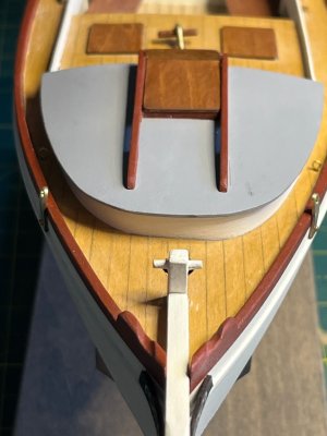

I used 5 minute epoxy to attach them. I'm glad I did, because it took some fiddling to get them where I thought they should be. I did the bowsprit cleat first, as that seemed easiest.

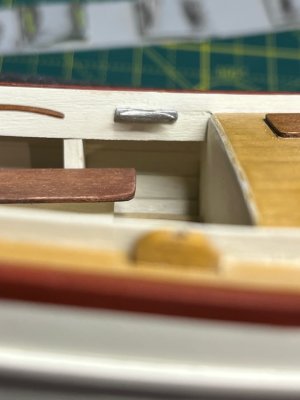

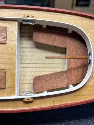

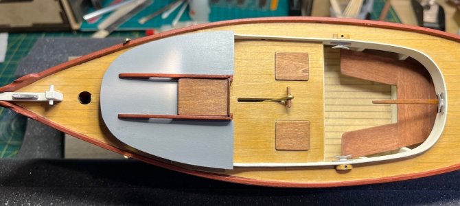

I tried to line the side cockpit cleats with the top of the deck over the wet wells.
I very slightly bent the base of the cleat over the tiller, as recommended in the instructions. It didn't need very much. The final result:

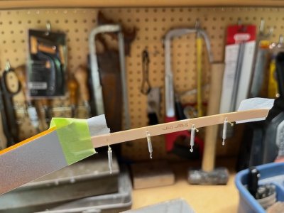

The instructions have you attach the turnbuckles now, but I can't think why. They will only be in the way and continually fall off. I will add them at the appropriate time during the rigging. However, I will clean them up and paint them now, before moving on to the mast.
Post 10 - Spars
I spent the last several days making the final wooden pieces of the model, the mast, boom and gaff. I first cleaned up and painted the turnbuckles using a jig made of pins, scrap basswood and a paint stirrer

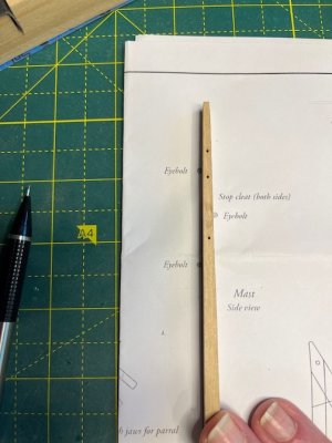

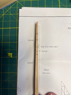

The mast pointed up one of the recurring issues with these Model Shipways kits - the supplied parts don't always match the plans or the instructions. My mast is several mm taller than the scale drawings, and the hole for the eyelets are in completely different places:
The holes, however, match the pictures in the instructions, so I did not change them. I decided to leave the extra height alone. On my previous model with a mast (the Model shipways Norwegian Sailing Pram) I used sandpaper to shape the spars. However, after reading a post by @Bob Cleek exhorting us to use sharp objects to cut wood and sandpaper to make final adjustments, I made the rectangular mast 4 square with a mini Stanley plane, finishing off with sandpaper. It made lots of nice curls!

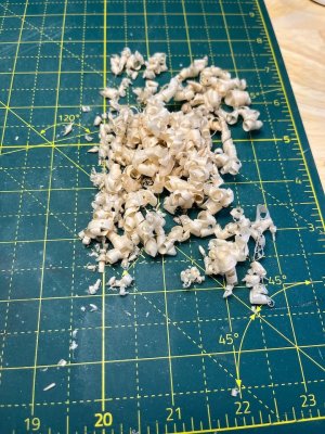

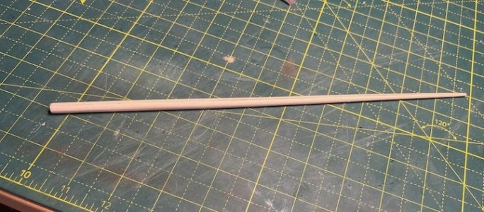

This was relatively easy, as the two flat sides (with the holes) are wider than the tapered, laser-cut sides. I took equal amounts off each flat side until it was square at the foot, and then began to taper the distal end, based on where the taper began on the laser cut sides as well as the plans. I used a digital caliper to monitor my progress. I made it 8 square using a spoke shave that is part of an old Xacto set I picked up cheap on Ebay.

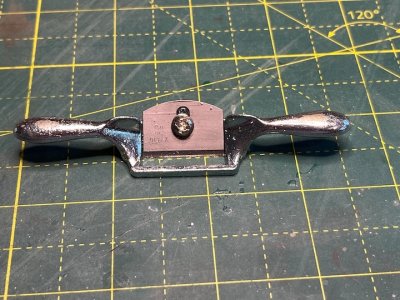

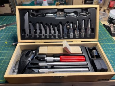

I think it's from the '80s. Lots of scary looking sharp implements! And a really great sanding block!
It worked like a charm, and made more skinny curls.

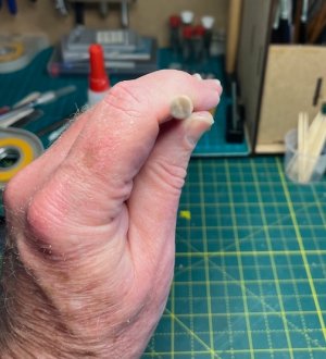

I started to round the mast in a vise, as recommended, but it felt like a set up for a broken mast, so I rounded it by pinching a piece of 220g sandpaper and rotating the mast by hand. Ended up pretty round

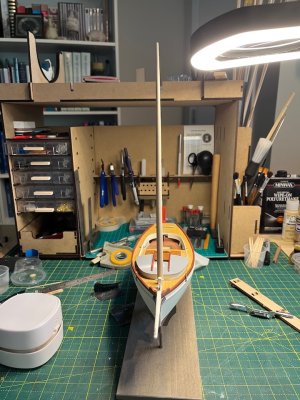

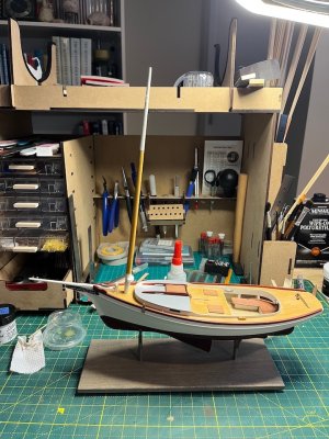

And it fit snuggly in the hull

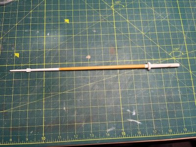

I carefully glued on the stay cleats (I don't know how I did it, but I did, and cut them as well - St. Rosalie came through again).My initial plan was to stain the mast, but then I saw @JacquesCousteau's picture of his painted mast, which I really like. Some quick internet research indicated that Muscongus Bay lobster smacks usually had masts painted white (to be seen in the fog) except for where the hoops for the mainsail were. That area was usually unpainted, but treated with something like pine tar and linseed oil to protect the wood. The boom and gaff were usually white, sometimes with black tips. I decided to do that. I used the plans to determine where the sail would be attached, and painted above and below that Warm White. I used the Tom Lauria paint/stain technique with DecoArt Faun mixed with a little FolkArt Camel craft paint to simulate the unpainted wood. I shellacked the unpainted areas.
I will add the halyard cleats tomorrow. I'm still deciding if I should glue on the eyebolts, or wait until after I have attached the blocks. I'm thinking of buying the new interntally stropped blocks from Syren, but need to determine the size and configuration.

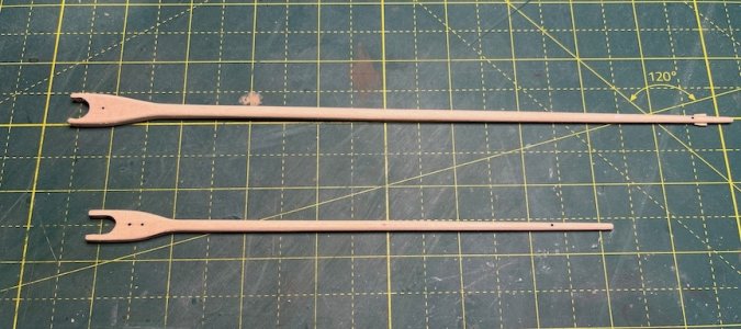

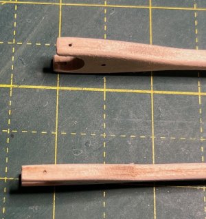

On to the boom and gaff. Again, discrepancy between the instructions and parts supplied. The instructions show spars of even diameter until near the end, but the supplied parts start to taper about 1/2 way down the spar. I decided to do an even taper along the length of the boom and gaff. The boom was a challenge to make 4 square, as the width was wider than the height. This meant I had to plane all four sides - the laser cut sides nearer to the jaws, and the flat sides nearer to the end. After rounding it I added the very small and very thin stop cleats (again, through the intercession of St. Rosalie - she never lets you down!). The gaff, like the mast, needed to be thinned down along the entire length of the flat sides before tapering. I ended up with two very nice looking round spars.
Another Model Shipways WTF, the plans show stop cleats on the gaff, but there are no supplied parts, and they are not mentioned in the instructions. Why don't they take the time to clean up the printed matter to match the kits?
Anyway, my mini drill press made quick work of the holes for the parrels.

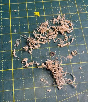

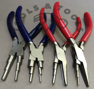

If you haven't gotten one yet, you should buy a jeweler's "bail making pliers." They come in various configurations and sizes and they're cheap. I like the "stepped" ones pictured below which will make a range of diameter rings on one pair of pliers. If you don't have "bail making pliers," you can also take a properly sized drill bit and wrap the wire around the shank to get a perfectly round "eye." With fine wire, you can make eyebolts by twisting the "pigtails" with a pliers around with the wire bent around a drill shank and nip off the end leaving the "shaft" of the bolt (the twisted pigtails). This will actually form a bit of a thread that permits the eyebolt to be screwed into a properly sized hole with a drop of adhesive. If you want to "fake" a mast band, you can glue a strip of black construction paper around the mast and then drill two holes through the paper into the mast and glue a "U" shaped piece of wire into the holes. It will look just like a forged mast or bowsprit band when you are done.
Now, one reason I prefer copper is that it is soft, unlike brass or ferrous metal, which can be springy. That makes it easy to work with. If the copper you have is too stiff, you can always anneal it by heating it until it starts to glow, then quench it in cold water. It will then be soft and easy to bend when it's cooled. (Copper will harden if it's "worked," i.e. bent or hammered. If that poses a problem, just anneal the piece again as your work progresses, although annealing shouldn't be necessary for stropping blocks or making eyebolts.)

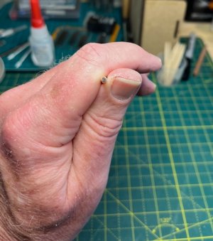

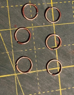

I finished manufacturing the spars today. Model Expo neglected to include the proper number of brass eyelets, but it was easy enough to make my own from the stems I clipped off the eyelets to get them to fit in the spars. I used the smallest diameter of my jeweler's pliers.
I made the one in the jaws.

I'm about to start stropping the blocks. I don't like the supplied copper wire - it's too big and they should be stropped with rope. What would be the appropriate diameter scale rope to strop 1:24 scale blocks? The supplied blocks are 7 mm (probably shaped down to between 5-6 mm). I have 5 mm blocks from Syren that I plan to use. How about the gauge of wire to make the hooks? I also understand that a ship of this period probably had internally stropped blocks. I'm thinking of buying them from Syren Ship Models as an experiment. They come in 1/8, 3/16 and 1/4 inch sizes. Which would be in scale? Chat GPT tells me smacks had 5 or 6 inch blocks for the halyards, and a larger block for the traveler, so I'm thinking 3/16" blocks and 1/4" for the traveler if I go that route.
I also plan to add parrels. I know to use seed beads (the instructions show black, I think) but what is the appropriate size? I am thinking 2 or 3 mm. Any input from the collected wisdom of the foum would be appreciated.
Yes, the copper wire is way over-scale for what you want. Get some pictures and do the math yourself. Google is our friend. Go to your local "bead store" or any craft store that sells beads. You should find copper wire in a variety of sizes, or strip scrap copper wire and use that. You can make your own blocks easily enough. Here again, use the SoS search engine. I'm sure there's a block making tutorial in here somewhere. You only have to make a half dozen or so. It's not like you're building a First-Rate ship of the line.
The size of the line dictates the size of the sheave, and the size of the sheave dictates the size of the block cheeks. You will have to determine from your own research whether the block sizes that are being referenced are the diameter of the sheave or the overall height of the block shell. There's a big difference. Do some research. There are tables for use in determining the size of line and blocks if you want to get technical. A wild guess would be that your sloop would be rigged with no larger than 5/8" or 1/2" diameter running rigging cordage and that would mean about a 4" or 5" high block shell. (Note that in earlier references, particularly British naval material, the cordage sizes are given in terms of circumference.) If your scale is 1:24, a half-inch equals a foot. six inches would equal a quarter-inch, so "ballparking it," I'd guess a 3/16" tall block shell would be about right. I wouldn't go over a quarter-inch though. However, "If it looks right, it is right." provided that you know what you're looking at. You can do the math if you have the schedules or you can "eyeball it" to determine the proper size of the wire you are going to use.
Making metal stropped blocks is easier than making rope stropped blocks by a wide margin. Just drill two holes in the top of the block and insert a properly sized "U-shaped" piece of wire into the holes with a bit of adhesive and you're in business. For a bail on the bottom of a block, you can place a single eyebolt if you want. If you want to get fancy, and at 1:24 scale, you certainly can, you can make shackles to fasten the blocks to eyebolts were necessary. To make shackles in 1:24 scale, take some "telephone wire" (as described in my earlier post above) and cut off a length suitable to make a "U-shaped" shackle (or a rounded one, if that's what you want.) Before you bend it to form the shackle, take a flat faced punch and a heavy hammer and place the wire on an anvil and the punch over a shore length of each end of the length of wire and give each end a good whack with the hammer so that the flat punch face (or whatever you're using to mash the end of the wire) mashes the ends of the wire flat, forming a flared shape. Drill a hole one size larger than the diameter of the wire in the center of each flared wire end. File the flared ends with the holes in the middle to a rounded shape as the ends of a shackle. Bend the wire with the rounded flat ends with the holes drilled in the center of each into a "U-shape" to form the shackle. Take another length of the same copper wire and smash one end of that and file the squashed spread end into a rounded shape to form the pin of the shackle. To assemble the shackle, place it as a real shackle would be to hang the block and run the pin through the holes in the shackle. Fasten the pin with a drop of shellac or CA. Trim the surplus end of the shackle pin off flush with the shackle hole.

It’s my Engineer side but rather than the stepped jewelers pliers, I make simple dies; brads or wire in a block of wood held in a vise. I like Aluminum wire for dies as solder does not bond to it.
