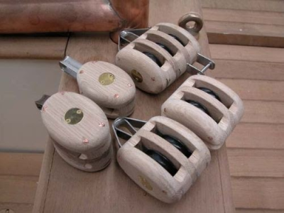

Nice work! As you've seen, I've been experimenting with ways to do internally-stropped blocks and trying to work out the block sizes and rigging diameters on this boat type.

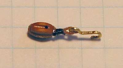

Yes, the copper wire is way over-scale for what you want. Get some pictures and do the math yourself. Google is our friend. Go to your local "bead store" or any craft store that sells beads. You should find copper wire in a variety of sizes, or strip scrap copper wire and use that. You can make your own blocks easily enough. Here again, use the SoS search engine. I'm sure there's a block making tutorial in here somewhere. You only have to make a half dozen or so. It's not like you're building a First-Rate ship of the line.
The size of the line dictates the size of the sheave, and the size of the sheave dictates the size of the block cheeks. You will have to determine from your own research whether the block sizes that are being referenced are the diameter of the sheave or the overall height of the block shell. There's a big difference. Do some research. There are tables for use in determining the size of line and blocks if you want to get technical. A wild guess would be that your sloop would be rigged with no larger than 5/8" or 1/2" diameter running rigging cordage and that would mean about a 4" or 5" high block shell. (Note that in earlier references, particularly British naval material, the cordage sizes are given in terms of circumference.) If your scale is 1:24, a half-inch equals a foot. six inches would equal a quarter-inch, so "ballparking it," I'd guess a 3/16" tall block shell would be about right. I wouldn't go over a quarter-inch though. However, "If it looks right, it is right." provided that you know what you're looking at. You can do the math if you have the schedules or you can "eyeball it" to determine the proper size of the wire you are going to use.

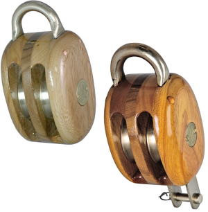

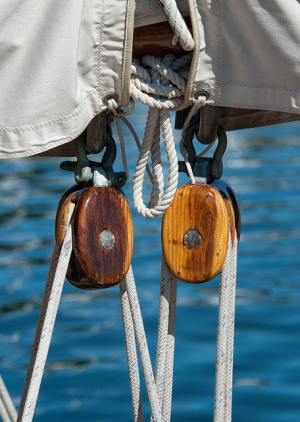

Making metal stropped blocks is easier than making rope stropped blocks by a wide margin. Just drill two holes in the top of the block and insert a properly sized "U-shaped" piece of wire into the holes with a bit of adhesive and you're in business. For a bail on the bottom of a block, you can place a single eyebolt if you want. If you want to get fancy, and at 1:24 scale, you certainly can, you can make shackles to fasten the blocks to eyebolts were necessary. To make shackles in 1:24 scale, take some "telephone wire" (as described in my earlier post above) and cut off a length suitable to make a "U-shaped" shackle (or a rounded one, if that's what you want.) Before you bend it to form the shackle, take a flat faced punch and a heavy hammer and place the wire on an anvil and the punch over a shore length of each end of the length of wire and give each end a good whack with the hammer so that the flat punch face (or whatever you're using to mash the end of the wire) mashes the ends of the wire flat, forming a flared shape. Drill a hole one size larger than the diameter of the wire in the center of each flared wire end. File the flared ends with the holes in the middle to a rounded shape as the ends of a shackle. Bend the wire with the rounded flat ends with the holes drilled in the center of each into a "U-shape" to form the shackle. Take another length of the same copper wire and smash one end of that and file the squashed spread end into a rounded shape to form the pin of the shackle. To assemble the shackle, place it as a real shackle would be to hang the block and run the pin through the holes in the shackle. Fasten the pin with a drop of shellac or CA. Trim the surplus end of the shackle pin off flush with the shackle hole.
Note: metal "coins" (actual coins are sometimes used) with two screws on the edges are used to secure the sheave axle in place. Note: the size of the eyebolt on the deck next to the block. The eye of the eyebolt should be not much larger in diameter than the diameter of the "ring" and "post" of the eyebolt.
Note: shackles below.
Note, poor seamanship! The line through the strop will chafe through and break in relatively short order. The line should be spliced around a metal thimble and the thimble shackled to the block to prevent the line from chafing through.
Note: Rounded bails, flattened out where they enter between the cheeks.

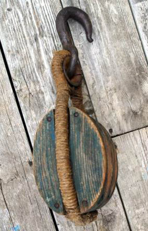

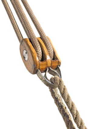

Note: Over-scale eye and hook on rope-stropped model block. Throat seizing too wide.
Note: Full-size rope-stopped block with thimble and hook. (Throat seizing missing.)

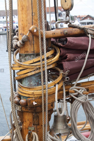

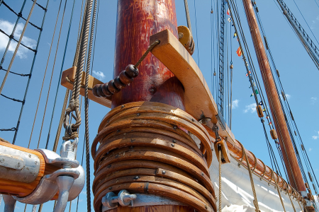

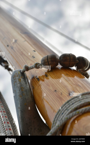

I also plan to add parrels. I know to use seed beads (the instructions show black, I think) but what is the appropriate size? I am thinking 2 or 3 mm. Any input from the collected wisdom of the foum would be appreciated.
I've never seen black parrels on a boat, although I can't think of any reason why not, except that wood which is intended to wear on a boat isn't painted. Oiled or tarred sometimes, but never panted. Usually left bare. The paint would just wear off. I've seen round parrels on some smaller boats, but parrels on larger boats from about the size of your sloop and upwards often use parrels which are "drum-shaped," more "rollers" than "beads." This is probably because it's a lot easier to make the "drums" than to turn the "balls." The parrel will be about six times the diameter of the cord used to string them. In this case, I'd figure the prototype would have about a 1/4" parrel cord, so the parrels would be around an inch and a half or a bit less in diameter, which at 1:24 scale will be around 1/16" in diameter. Wooden or at least "bare wood colored" beads or some sort of seed... or just forget the parrels entirely. They wouldn't be much more than window dressing on a boat that small. The boom jaws will generally be bearing against the aft side of the mast when full. Here again, "If they look right, they are right."
