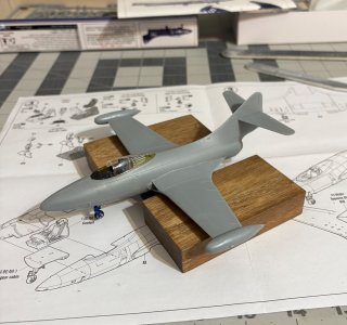

F-9F Panther update…
I finished putting the canopy on and started painting…

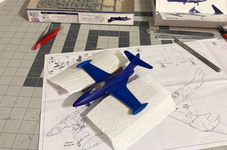

More progress…I typically don’t show painting in progress of the base color because it’s ugly until it’s done.
But I thought I would show that I am obviously using a paint brush. I keep the paint thinned, brush a large area and then dip the brush in some water and brush over it again while the paint is wet. You have to work fast and get the surface to be one big wet area with no brush marks. Once dried I repeat until I get the coverage I want.
If I want consistency then air brushing is the way to go. But I like using a brush when I want variances in color and panels. Because perfection doesn’t look as real. I’m still deciding if I want to put any black in the panel lines.
So I continue to put coats of blue on and once done I can start doing all of the silver.
Then it will start to come alive, so to speak.

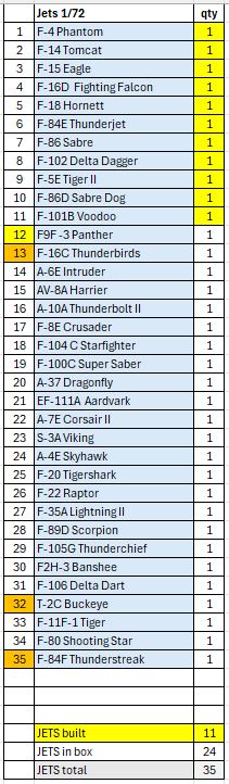

Update on the collection...I just received the F-11F Tiger and the F-80 Shooting Star this week.
I have a F-84 Thunderstreak and T-2C Buckeye on the way.
So my Jet collection has grown from 8 to 35. I have have put most of my focus recently on getting that part of my collection built up. Which consists of finding and purchasing the kits first.
I am currently building the F-9F Panther and will add a F-16C Falcon next, a Thunderbirds version. Then I will build another early jet soon afterwards.
Some candidates would be; F-104 Starfighter, F-100 Super Sabre, F-89 Scorpion, F2H Banshee, F-11 Tiger, F-80 Shooting Star or F-84 Thunderstreak.
I am considering getting some WW2 aircraft done first. But only time will tell. I have a SBD-2 Dauntless I am working on, so it will be first in line after I complete the F-9 Panther and F-16C Falcon. My focus has been on those 3 aircraft lately. So I need to wrap up the Panther build soon! ;)
