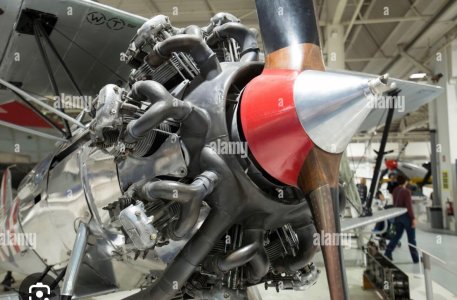

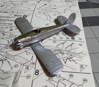

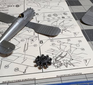

I started working on the motor, as it’s one of the interesting aspects of the Bulldog.
Reference pic…

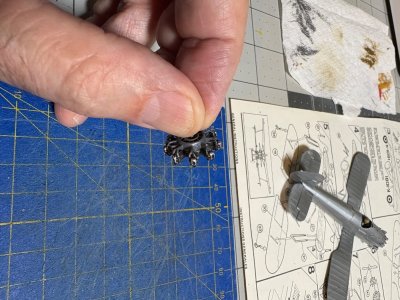

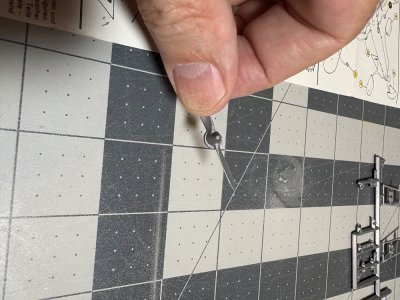

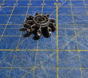

The lack of detail needed to be addressed. So I added the valve springs in 4 places on each cylinder head with a drop of glue on the end of a toothpick. Prior to that I sanded the head flat and added some bolts with PVA glue and a needle tip to the cover. Then it was time to paint and do a little dry brushing. So far it’s looking promising, and better than out of the box.
View attachment 537875View attachment 537876View attachment 537877
At this scale, I can’t get as detailed as I would like. So there is an obvious compromise between what I would like and what’s feasible! ROTF. Although I do have options I may consider. ;)
A beautiful object that deserves some attention. The details looks neat, Dean.
Not being 100 percent happy with the head geometry, I added some 3d protrusions for the cover and valve rocker arm guides to the cylinder head with PVA glue on a needle.
Then once dried I painted on top of that…
This is a very small difference that may go unnoticed had I not mentioned it. Was it worth the effort? I don’t know, but it made me happy! ROTF

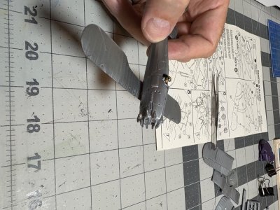

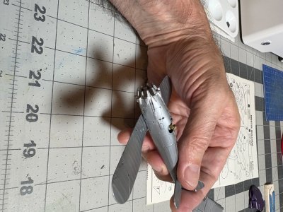

Next I added the surround for the motor that attaches to the fuselage. I have never seen anyone take the time to putty the horrible gaps and I think this will be a vast improvement…
I add putty with a toothpick, then I come back with a wet paint brush, dipped in water, and I brush the putty to smooth it out. ;)

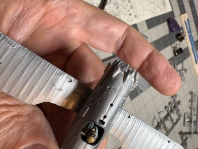

Next was the horrible excuse for machine guns…
They are so small you can barely see them!
Looking at the real airplane, that was not the case at all. So I carved them out and cut the barrels off some spare machine guns I had from previous builds and I glued those on.
This is another definite improvement over the kit offering.

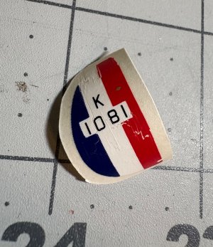

Unfortunately decals have a shelf life. I suspect these were from the 1969-72 era…once placed in water, to my horror they disintegrated! They crumbled into a million little floating pieces.
This is one that was only in there about 30 seconds…
As you can see it’s already starting to crack and fall apart! The others completely fell apart in the water…sigh
They don’t make these kits anymore, however there may be some after market decal kits for it. I need to search.

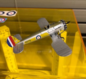

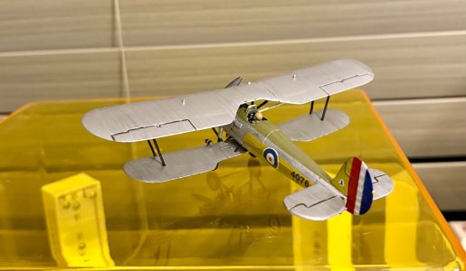

View attachment 538026View attachment 538027
So I’m moving forward despite the temporary set back. I still need a set of rounders for the upper wings. The ones behind the airplane are from the kit, I only saved them for size reference. Since those were common markings for the RAF, I should have no problem finding some online.
Next I will clear coat what I have, to protect the decals, and then do a wash on all the bolt heads, etc. and then start adding pieces as I paint them.
Ps - word to the wise…when purchasing an old antique kit, be prepared to find new decals for it! ;)
See ya next time.

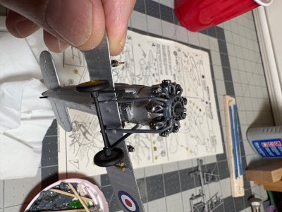

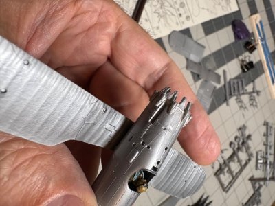

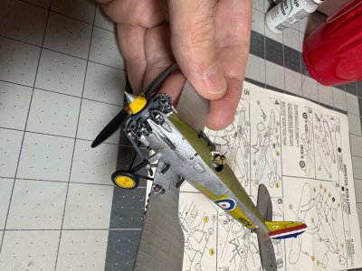

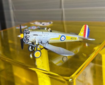

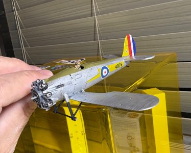

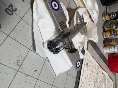

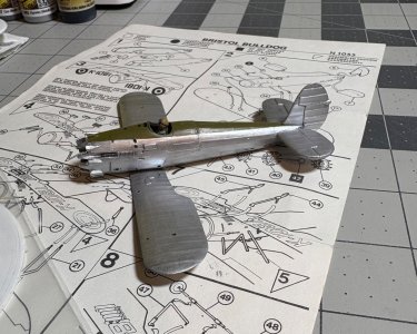

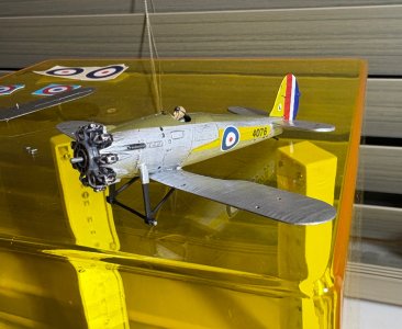

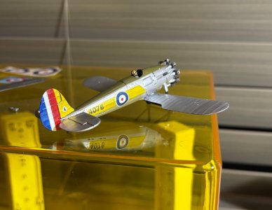

After the decals and some clear coat. I added a wash to the bolts and vents, etc. and I ended up using the paint scheme from a squadron I found online that had some yellow. So more painting and clear coat was added. The wheels and spinner on the propeller will match. I like the additional color.
Then I added the wheel frame, and the tail skid. So I decided to put the motor in now as well. There are two exhaust pipes that come out of the bottom of the radial manifold. Will add those soon.
So much more to add before I start on the upper wing. It should go quick hopefully. ;)

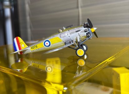

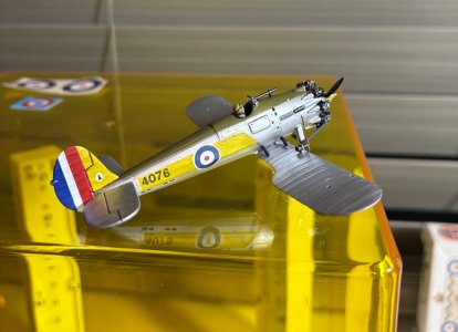

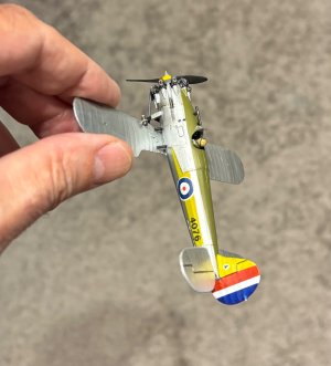

A few pics of my current progress…
It’s taking shape and looks like it will end up being a nice addition.
See ya next time…

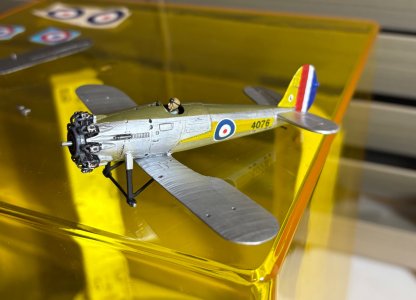

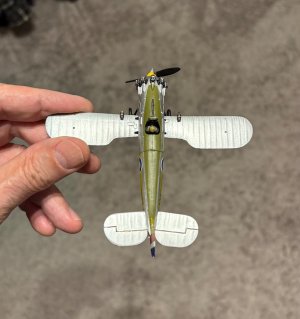

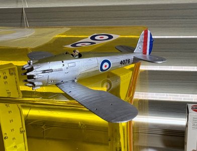

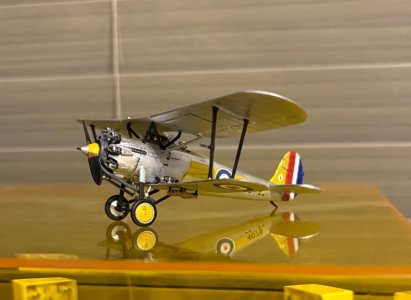

Moving forward…

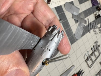

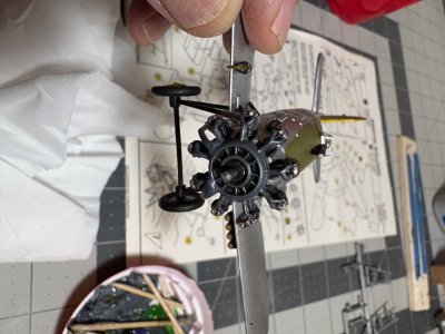

I carved the end of the exhaust pipes to make a hole…

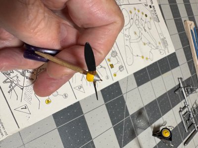

The propeller has a flange at the base of the spinner…not like that on the actual photos…
So I carved and sanded the flange off the spinner…and then painted the propeller and spinner and added the pin on the end of the spinner…
Then the exhaust was painted and added, the bomb rack and bombs, the wheels and radiator…
Then I dry brushed the exhaust to add some heat soaked areas…
Then I had to make a windshield because I lost it…sigh. So I fabricated one using a spare windshield that I cut and heavily modified. Then I added the scope in front of it, the 4 struts on the wings and fuselage, the generator, and another unit on the other side of the wing (not sure what it is)…
I also did some final painting on the cylinder heads…I finally got the look I was after. ;)
Here are some current progress pics…
Next step is the upper wing assembly…
