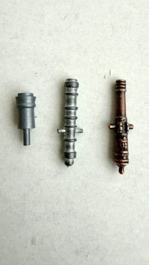

Very nice build so far.
Pay attention that the guns are not accurate for the time period.
For the Trafalgar period you both iron long guns ordnance and bronze naval howitzers ordnance.
Cheers
As sevish says, the one on the right is more suitable; the one in the middle is better suited for a galleon.

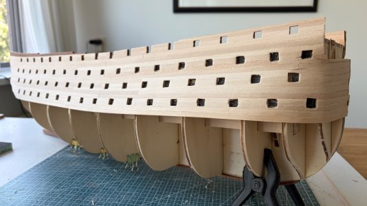

One side done. One side to go…
I found a workaround. I left those gunports that have the bulkheads behind them open.
I also left open the ones where the hull has too much curvature, and glued them last.
I have also placed the baseboards against the walls.

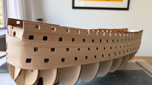

Finally, I managed to spend some time on my ST again.
I have now fully planked the bulwarks and gave them a first sanding to see if there are any major gaps between the planks. Fortunately, I couldn't find any.

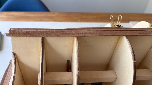

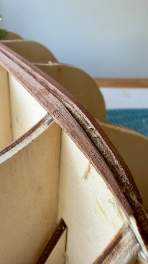

The next phase has started: the planking of the hull.
First, I installed a garboard strake, following the description by E. Baetens (How to: planking a ship's hull).
The sapeli planks are a lot harder than the lime wood planks I used for planking the bulwarks.
I use the clips to check if the planks have taken on the correct shape. Once I'm completely satisfied, I glue them in place.
That's it for now and thanks for following my log.
