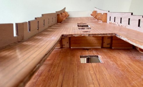

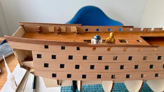

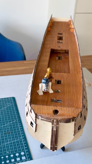

Your deck planking looks neatly done! At this small scale it is great that you are not using spikes or treenails.
I cannot find any information on this so a question maybe you can answer. Were the decks of Spanish ships flat unlike British ships which had various degrees of rounding depending on the deck and ship size, or is this a kit design mistake?
Thanks
Thanks
Hi Allan,
This is indeed a design flaw in the kit, or rather a deliberate simplification by OcCre.
In historical shipbuilding, the decks of Spanish ships of the line, just like British and French ships, absolutely had a distinct camber (transverse curvature from side to side) and a sheer.
In the 18th century (the Santísima Trinidad was built in Havana in 1769), Spanish shipbuilders—including the renowned designer Jorge Juan—followed highly advanced scientific principles. Deck curvature was essential for all large warships of that era for three crucial reasons:
  • Water drainage (Camber): Without the crown of the deck sloping towards the sides, (sea)water would pool on the decks. This would cause the wood to rot quickly and make the ship top-heavy. The water needed to run off to the sides and exit through the scuppers.
  • Structural strength: A slightly curved deck beam acts like an arch. It can support and distribute the immense weight of heavy bronze or iron cannons down into the hull much better than a perfectly straight, flat beam.
  • Longitudinal strength (Sheer): The sheer ensured that the bow and stern were higher, making the ship much more seaworthy in heavy seas.

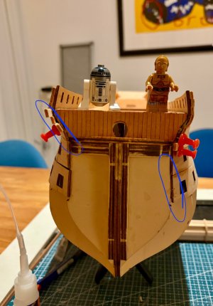

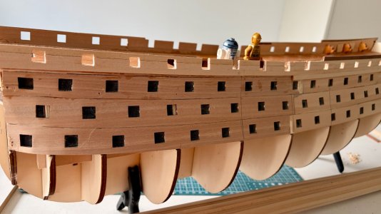

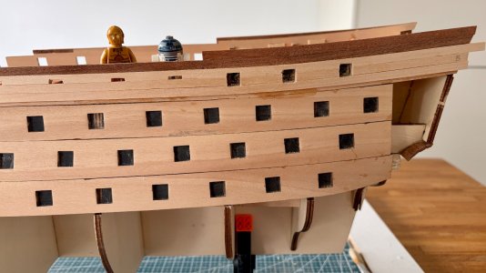

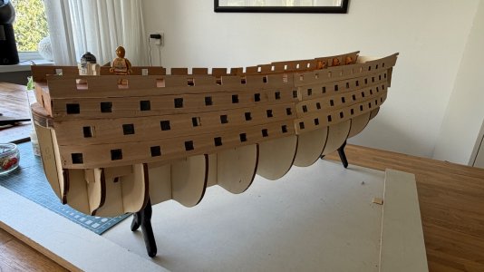

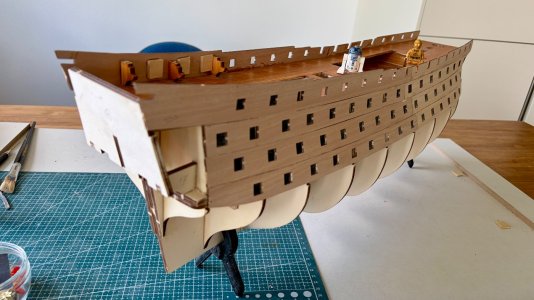

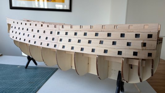

I managed to spend a few more evenings working on the other side of the ship.
The sharp curves of the bow in particular weren't easy.
One bulwark threatened to snap because I tried to bend it while it was too dry. I was able to fix it with CA glue (another lesson learned).
Using a brush and a bit of water, the bending wasn't too bad after all.
With a bit of luck, bending and fitting the planks will be a bit easier going forward, but we'll see about that.
After sanding, the transitions of the bulwarks are smooth, and I hope the planking process will go smoothly now.
The stern plate was provisionally mounted. Next up is to align it correctly.
After that, I can start planking the bulwarks around the gunports.

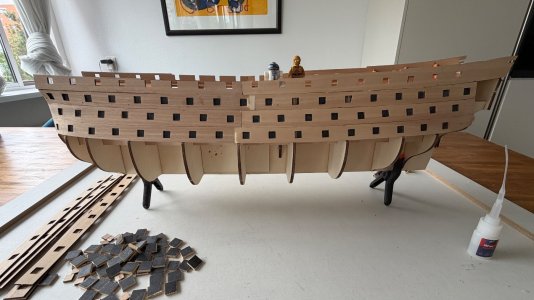

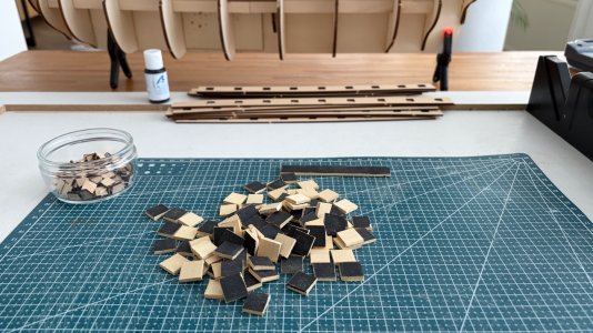

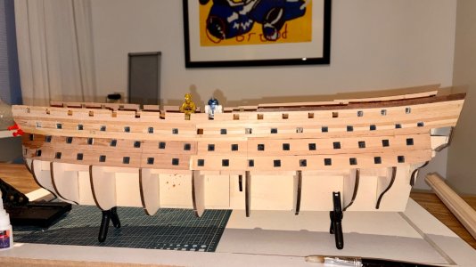

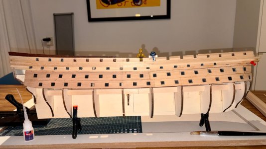

Die ersten Planken wurden mit Sekundenkleber auf die Schanzkleider geklebt.
Die ersten Reihen sind gar nicht so schlecht. Selbst ohne Schleifen sieht es schon recht ordentlich aus (wenn ich das mal so sagen darf).
Von nun an wird es wahrscheinlich nur noch langsam vorangehen, da das Ausschneiden der Geschützpforten viel Zeit in Anspruch nimmt.

Einen habe ich noch Peter. Am liebsten arbeite ich mit dickflüssigen Sekundenkleber. Der ist sauber zu verarbeiten und verbindet schnell und sicher.
Hallo Holger,
vielen Dank für deine aufmunternden Worte und deinen Rat bezüglich des dickflüssigen Sekundenklebers. Leider habe ich noch einen Vorrat von 25 Fläschchen à 20 Gramm, die ich erst einmal aufbrauchen möchte. Die Planken, die ich damit verklebe, werden später lackiert, daher gehe ich davon aus, dass die Flecken, die mein Sekundenkleber hinterlässt, unsichtbar werden.
Ich weiß deine Tipps wirklich sehr zu schätzen und hoffe, dass du mir auch weiterhin mit Rat und Tat zur seite stehst.
Beste Grüße, Peter
