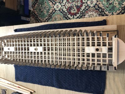

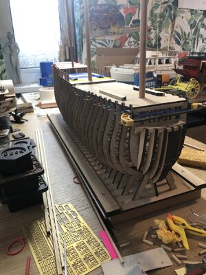

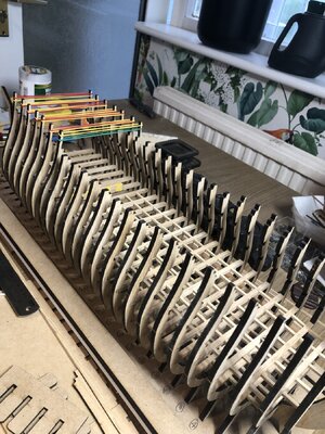

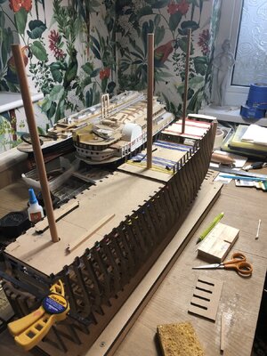

Another really helpful tip for any new builds of this model is as follows…
Early in the build when the basic keel and ribs are installed, drill a small pilot hole in the centre of the mast supports. Stage 49. 112,138, before fitting them.
Then drill and put a pin in the centre of each future mast .
You will always have a true accurate guide position as the build develops because lining up the mast holes through each floor level will ensure everything is lined up.

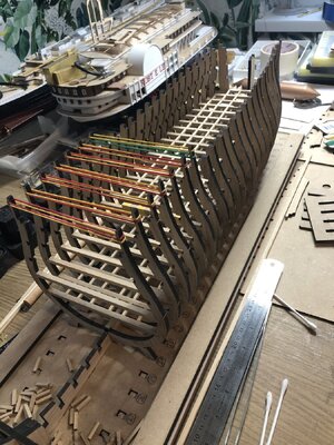

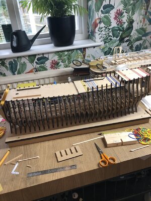

Few pics …

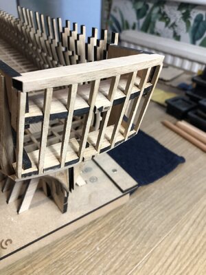

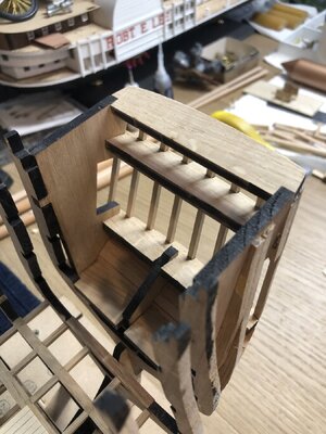

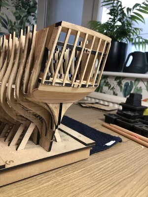

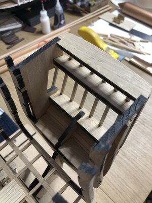

Question?
Should I fill the upper and lower spaces on the stanchions with wood strips to make it look more solid and load bearing?
I would say; "Yes", as they give the impression of 'floating' in the air. Look at some on line photos. Then again I guess you've done all that by now, I'm behind the times picking your thread up!
