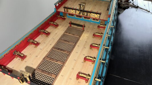

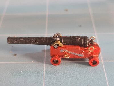

Second thing visible guns look accurate and even have some decorations on them. Same thing on balaying pins-reasonably sized.
And like I said before those elements under the grating aren't available in any other kit and are historically accurate. The downside is: a lot of elements from AL is from playwood that just looks cheep and you have to somehow cover this up.

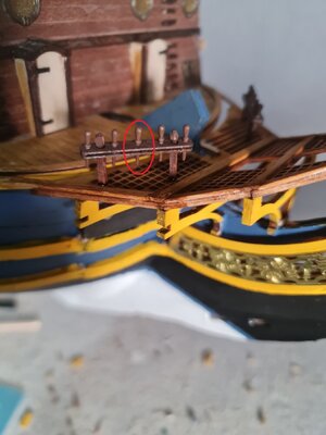

Only in AL model

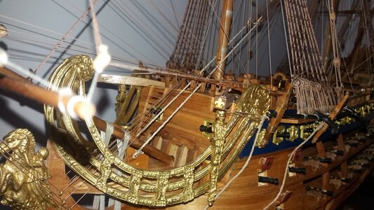

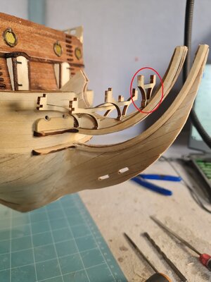

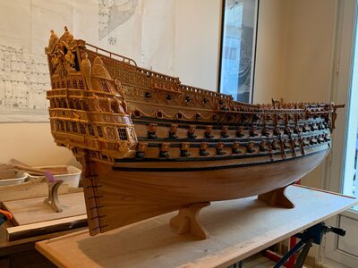

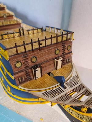

So far only completed model that is good looking

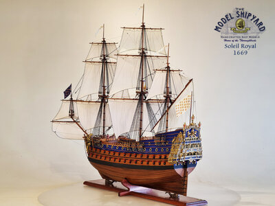

The model AL wanted to base upon
If you have the money to spare, the AL kit is the best basis to build a good model of the ship. All of the deck furniture is fictional and horribly out of scale. Whomever built the version of the kit above, for The Model Shipyard did a good job of fairing the hull, planking in a mostly correct fashion, and correcting the sheer. The gunport spacing, though, is completely wrong because, as mentioned, the hull is much too short. I think it’s a huge money commitment for these kits, but if you can’t be dissuaded, the AL is the best of the three.
