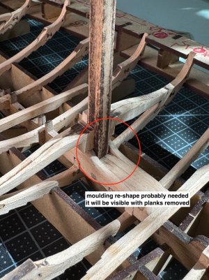

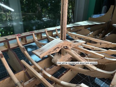

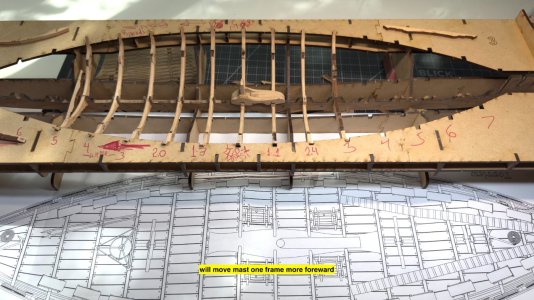

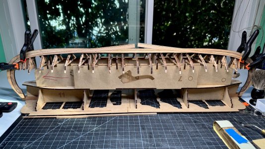

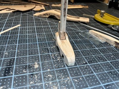

Your work Oseberg log has also been a real pleasure to follow. Went back through your log to again - read your notes about where to locate the mast and the Unimus image reference….., for moving the mast step one frame forward - that was a LOT of work on your part.….Need to consider that as well..

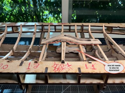

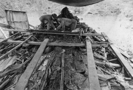

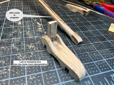

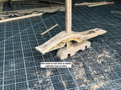

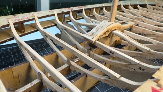

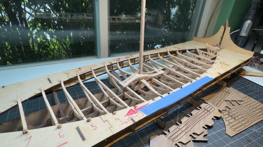

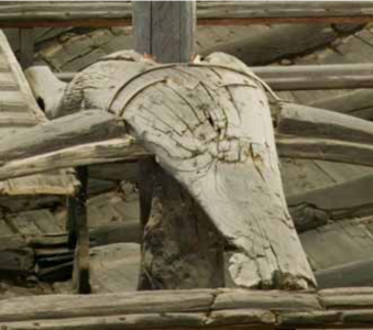

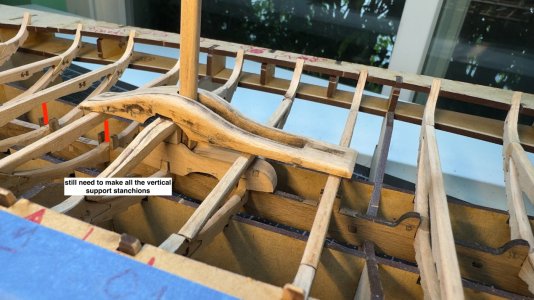

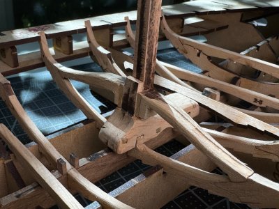

Yes, the partner needs to be shape adjusted - still on my list. That said, I’m not sure - either way - if the deck planking also did continue slightly under the partner on each side of the mast?

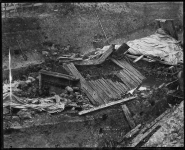

Though most early 1900s images, from the dig site, don’t seem to support that conclusion…Nor do current images of the ship. Need to read more…TBD
Regarding the mast, I intend on leaving it square shaped at it fits into the keelson - then round it just before it fits through the partner.
The other issue is the size of Pavel’s provided keelson - seems too big. I will do some slight reshaping there as well. Lots of learning (for me) about a ship from 2000 years ago. Enjoying the is new learning adventure.
As I learn more, I have also been so astonished about Viking ship building; So excellent

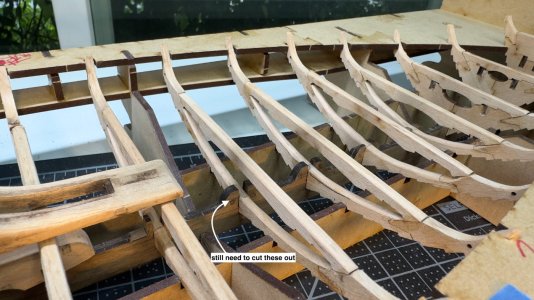

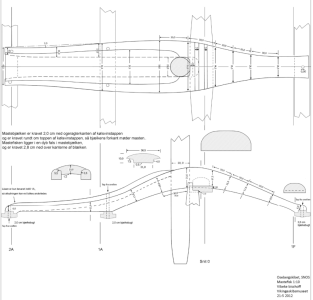

That's really hard to say, John. What we would call thwarts (the uppermost crossmember at each frame) are called biti. If you examine the cross section I sent you, the deck ledge on the aft biti is just below the mast partner, and it is conceivable that the decking could have slid under the partner. The forward ledge, however, is arranged differently, and there doesn't appear to be room for a deck plank under it. Unfortunately, the mast biti was not drawn with the deck ledges, so your guess is as good as mine. I plan on not making the curve on the bottom of the partner arc so high and just butting the planks up against the side of it. If I were doing what you are, I would probably approach it differently, as well as make the mast step more authentic.
My reasoning for not, however, is that all evidence points to all the deck planks being nailed down with the exception of the rooms adjacent to the mast and (if I remember correctly) a room or two at the stems. If I were to leave a room open as you are, it would be one of those, but given, as you say, the incorrect keel as well as the incorrect frames, I decided to leave it as is and fasten the deck down.
Having the decks fastened down is somewhat unusual for a longboat, which is why archaeologists believe the Oseberg was not a typical ocean-going raiding vessel, but rather a ceremonial boat or inland private transport for the apparent high-ranking women who were found buried with her. There would be no need for much storage space below decks and without cargo and supplies, there would need to be more ballast. Dr. Bischoff talks in her book about trimming the reproduction boat by shifting ballast - sometimes this might need to be done at sea. Again, given the role they assume the Oseberg played, there would not really be a need for that, hence no need to access the bilge.
This has indeed created a slight conundrum - wanting to make the Oseberg a bit more representative generically speaking of a fully going ocean-going ship, but understanding that she was apparently not built with that intent. And of course, the knowledge that the Oseberg’s place in Viking history was as a preserved tomb for the deities who were buried aboard.
I may create a very slightly abridged version of this ship being motivated to include ballast rocks.
Russ you are rightfully dedicated to accurately building your example as closely as possible to the original ship’s look even moving the mast forward to its correct location. Good idea…There is also definitive evidence that Oseberg was found with remnants of a sail in addition to wood barrels, an iron tripod cooking pan, along with other related items thankfully Pavel's kit included those bits.
So, the issue for me would be to whether or not to add rock ballasts at my intended open deck locations.
She was however found with a massive number of rocks, with nearly 180 tons of stone placed inside and on top of the vessel to seal the burial mound. Non were noted to be used for earlier ballast.
Oh regarding deck planking - I will just butt up against the stem - not under thanks for your post.

Yes RussF discovered that was certainly needed. In both our cases (you and I) a simple enough adjustment. Russ needed to do a lot of re-fixing in his log
to get his mast position properly changed.

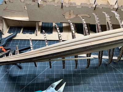

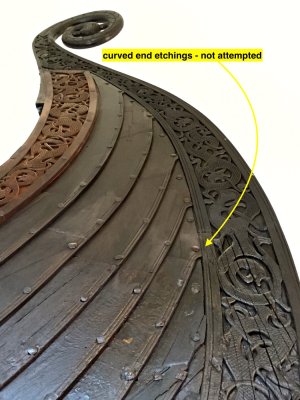

Hi all,

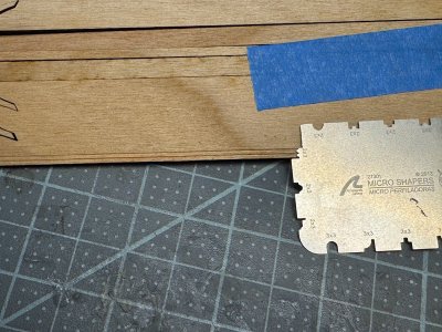

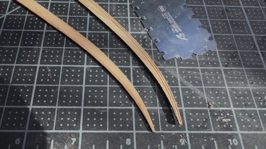

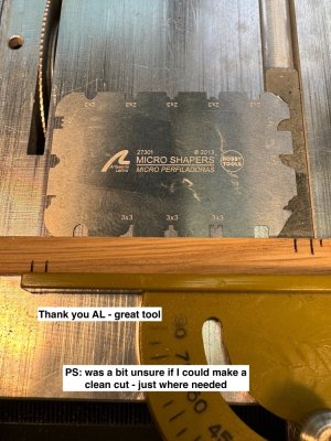

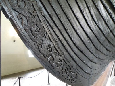

Finally starting hull planks. Wanted to better replicate original that had etched cuts along each plank.
This solution, so far, is working out better than I had imagined with a Slight variation - very curved part was a bit beyond my skill set.
NEED to think about how to add, in scale, the 1000s of cleats yikes Cautious TBD

I want to also add the nails - TBD -- I think that @Willbor237 win's the trophy in that regard - will revisit his brilliant Oseberg work. AND his deck work as well!

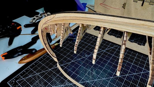

Hi all,

Good morning John. You got those just right- those little details make a difference. I always love looking at pics of the real thing as us modellers always strive for that perfect finish but the real ships never are. Gives me an excuse for my inconsistency’s ROTF. Cheers Grant
