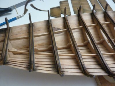

Checking Planking Fits

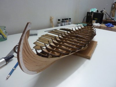

I'm getting back into the swing of building the Oseberg. I have had a few problems along the way and I appear to, and hope it is the case, learnt a good few thing on this journey. The Oseberg is my first ship in very many years and the first with clinker built planking.
The Problems Start
All appeared to be going well until I discover the planks were not fitting as well as I had first anticipated. Turning to forums such as this and others for tips on my problem, I discovered an assortment of comments ranging from the planks as supplied were too short to the ship being of a faulty design or even, the instructions were incorrect. Few people list builder error as the major cause. I will admit, in my case, builder error has caused some issues.
If I consider the works of Pavel Nikitin I would say that there have been errors, but those as far as I'm concerned have been rectified by him before I purchased his Oseberg. I would also say, this is most likely the case with each of his kits. I feel that Pavel creates beautiful ships that with a greater understanding of the shipbuilding process, can result in truly beautiful masterpieces. The fact that people do report pieces missing on occasion, is a different matter.
It's My Fault - I Can't Blame Others

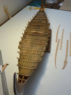

A Challenge in the Decking
A little short on the width! The decking of the Oseberg has been, boring, challenging, fun and rewarding in that order. The laser cut parts have been cut, not allowing for cleanup of the parts.
The Challenge
Let Me Check the Dimensions
Before writing this post, I did an experiment and measured the dimension in the widths of the remaining cut-outs of plates eighteen and nineteen. These are marked on the drawings where I used sections 6-2 and 6-1. Between them the measurement is 133mm. This is the exact measurement required for the decking width of the 4th section from bow or stern. When the parts are cleaned, even slightly, the remaining width is 128mm. 133mm is Required for full coverage.
Drawing and Pavel Video
Though not noted in the supplied drawings of the accompanying booklet, the discrepancy is seen in the video as supplied by Pavel. In the video, Pavel added a small piece of wood to each side of the decking sections. An additional small plate as seen is supplied with the kit for this purpose. Unfortunately, the supplied wood plate, was not matching in the case of my kit. Further, I felt that the laser cut parts were also too small.
Workaround and Potential Model Improvement
It's unfortunate that I did not take photographs of my actions here. However, basically, what I did was to fit the too narrow decking section in place on the Oseberg and then fit a temporary strake at level eight. This gave me the exact positions required for the widening of each deck section. With the temporary strake in place I made a template of the width and shape/s required. In the case of the original Pavel design idea, the deck remains flat to the very edge of the decking. Photographs of the preserved remains of the Oseberg, give me the impression that the deck took a small step up on the very last board on Port and Starboard sides. I recreated this upon increasing the decking widths.
Part of the system showing level how I achieved the widths required
The End Result
Two finished parts
The step as mentioned
In Conclusion
Creating and using the paper templates, plus chamfering the underside of the board extensions permitted me to be able to achieve a perfect join between strake eight and the decking. The boring part was cleaning up each deck section. The challenging part was figuring out how to fix the problem. The fun park was knowing how to achieve my goal and the rewarding part was becoming a better model ship builder.
All in all, I'm more than delighted with the results.

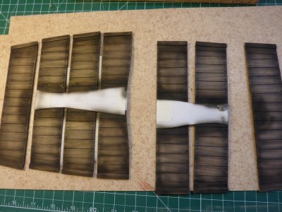

Fun with Colours and the Decking

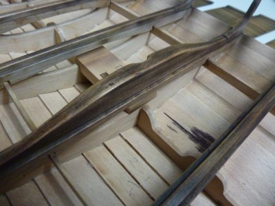

It seems I'm really making progress on the Oseberg with the rate of my postings. That is not the case as I'm simply playing catch up on the progress of my build. I have however very recently stained the deck boards. It is the first time I have used wood stain through my .35mm airbrush and I learned the difference between acrylic paint on polystyrene and stain on wood. I was also concerned that the amounts as supplied by Pavel would not be enough. I'm now sure, adequate is supplied. Below is the result of the first attempt. Far too dark and especially soon in dull light.
The Desired Effect

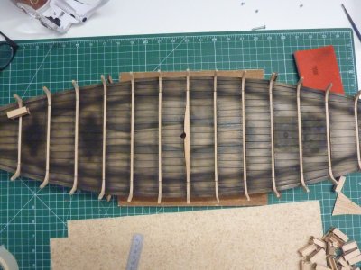

I did not want the Oseberg to appear as if it had just arrived from a ship building company looking pristine. I did not want it to appear as a preserved ship, as is now the case with the Oseberg. The look I wanted was as if it had been used for many a year and aged well with time. This is not what I see on Pavels videos for the decking. They look very clean and regular in stain and discolouration via patina in my view. The Oseberg as seen on Pavel's website is truly beautiful.
The below image left side was the result of sanding some of the stain as seen on the left of the image. You can see the paper template I used.
After some more stain was removal things looked a little better. Then I decided to add a little patina stain to below the bench position, cooking area and areas where it would receive less foot traffic and likely to become dirty.
Below, more patina is added. Now it's getting too dark again. Oops.
Some removal of stain did a little to improve the situation. Now I'm getting worried and feel I need to make a complete new deck. Or strip it right back to almost no stain.
I tried to consider where the main foot traffic would occur. Where the sailor seats would be positioned and where cooking of food would have taken place. Generally areas when wear might be more likely to keep boards cleaner and difficult area to maintain, appearing more grimed.
I Though I Had Screwed Up - Initially
I almost had the Flying Dutchman dead look. What would have been helpful is if I'd worked with dyes and an airbrush on a ship before. Even trial and error on spare pieces of identical wood scrapes would have helped and been more sensible. Below are the results in order of trial.
Horrible
Nothing more to say.
Start Again
Ok Ashley, I said to myself. Lets start again. Experiment. If I have to recreate the complete deck, I'll do that. Below is experimenting between bow and stern. I sanded back with 180 grit, then 240. It started to improve with a huge lessoning of contrast.
In conclusion.

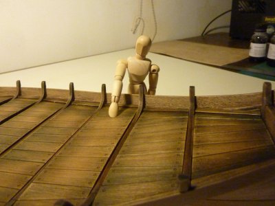

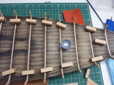

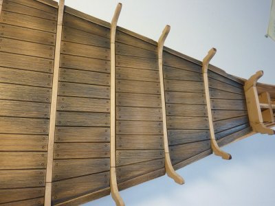

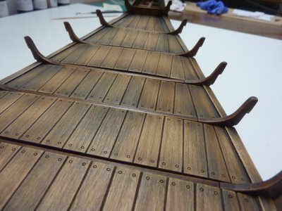

More Stain - I'm Improving
Overall Image

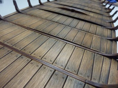

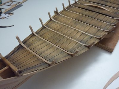

I have became more confident in my staining ability and the staining of the Oseberg. Feeling this way, and whilst the wife was chipping away to create a new masterpiece of wood carving, I undertook the staining. It was in fact a much more involved job than I'd anticipated, not that I had given it much thought.
Patina - Ageing

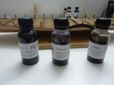

I airbrushed the patina colouration with a very fine spray setting so as not to soak the wood to much. Still to achieve a more convincing aged look. I applied so the effect was dark grey, not that of light.
Following application, I rubbed down the beams as seen in Pavels videos and discovered how involved it was. Following, I felt the results were pleasing and in keeping with the already completed deck timbers. I discovered that if not careful, a noticeable difference between beams could become obvious.

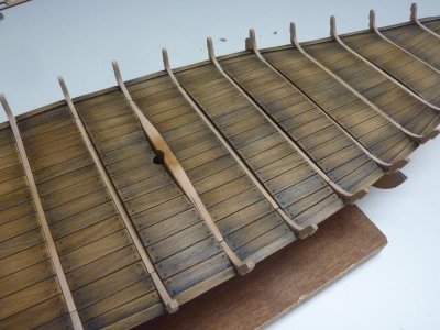

Real Colours
A second application of rosewood stain was applied and following, rubbed down lightly. On completion, I inserted the decking parts to see the result. I felt that the were not as I desired due to the fact that the rosewood has a distinct red colour. This was not really in matching with the deck timbers. To rectify this, I rubbed down the rosewood colouration but not completely. Following this, I applied a light covering of oak stain. The result, to me were very acceptable.
Conclusion
I am delighted with the results so far. In the images, it can been seen how I finished the final slightly stepped deck boards to achieve a nice join between deck and hull planking. I'm thinking a lot about the Santa Maria by Pavel.

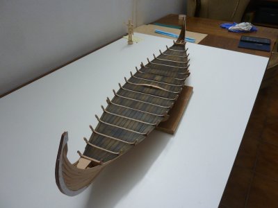

It Remains Enjoyable
I had been looking forward very much to the following works involved in the Oseberg. It seems it has taken me an absolute age to get to this point. That said, it has not mattered because it's not a race but a very enjoyable hobby.
My Inaccuracies
During the construction of the Oseberg I have learnt a lot in the construction methods required and the accuracy required for a successful finished result. In my case I made a few mistakes. Perhaps, because I failed to take better note of the videos by Pavel or because I needed to spend more time on the plans. In any event, my planking was not perfect, and I believe it could have been, because, this part of the kit will permit that. My planking started with a minor inaccuracy in the placement of the first strake. Also, I feel it's entirely possible that excessive char removal played a part. And following, a slight inaccuracy of the second, and third and so on. It goes on whilst working my way up the ship. Every little half millimetre incorrectness increases the overall effect, the further you proceed.

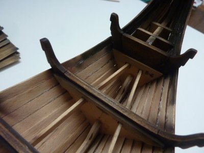

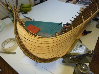

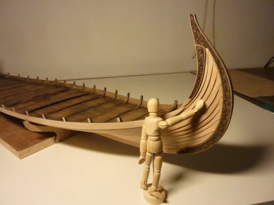

Bow and Stern
A Little Long-winded But Hopefully of Benefit to Others with a Similar Problem.

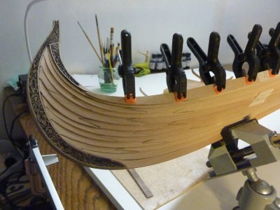

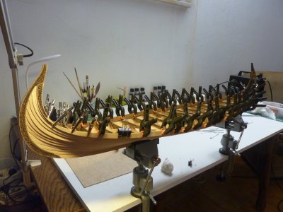

Fortunately, these wooden kits will permit some corrections with a bit of ingenuity and luck. In my case, I developed a poor quality connection between the bow planking and the temporary bow mould piece. The same was the case with the stern. In my previous images, this can be seen. It was only slight. To overcome this, after removing the temporary attachments to the bow and stern, I reshaped the planking join to all four parts, with a small file, so that the ornate mould could be set further in and towards the planking. If this is not clearly written, in short, the top of the bow and stern ornate moulding were moved in and towards the ship centre by about 2 millimetres each. This results, in my case, in a closing of the gap, and an almost perfect visual connection between ornate mould and planking.

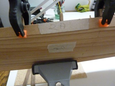

Strake Ten
Shaping and attaching the tenth strake was relatively simple but initially, I could not understand why the instruction request tapering by 60mm. After some time, I realised that the thickness of the ornate moulded section needed to be taken into account. On watching Pavels video, he joins sections of strake ten and then chamfers the bow end. I shaped and then joined. Attaching this part was straight forward.
Strake Eleven
"Easy Peasy" as the Saying Goes. Not really so. I found that making the join between strake eleven and the ornate moulding to be a very delicate job because out of the four sections, three chipped off at the very tip due to the grain of the wood. Perhaps, it would have been beneficial if I had reinforced, temporarily, with masking tape, the very delicate end tips. The four sections: bow, stern, port and starboard, I numbered so I did not confuse each of these parts. Staining of all, finished these parts.
Conclusion
In the case of building the Oseberg, I feel one of the great joys is discovering that you are learning new things and improving as a model ship builder. I may be at an early stage here, but it's a true thrill as is sharing the build process.
