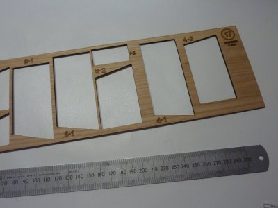

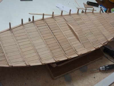

A Challenge in the Decking
A little short on the width! The decking of the Oseberg has been, boring, challenging, fun and rewarding in that order. The laser cut parts have been cut, not allowing for cleanup of the parts.
The Challenge
Let Me Check the Dimensions
Before writing this post, I did an experiment and measured the dimension in the widths of the remaining cut-outs of plates eighteen and nineteen. These are marked on the drawings where I used sections 6-2 and 6-1. Between them the measurement is 133mm. This is the exact measurement required for the decking width of the 4th section from bow or stern. When the parts are cleaned, even slightly, the remaining width is 128mm. 133mm is Required for full coverage.
Drawing and Pavel Video
Though not noted in the supplied drawings of the accompanying booklet, the discrepancy is seen in the video as supplied by Pavel. In the video, Pavel added a small piece of wood to each side of the decking sections. An additional small plate as seen is supplied with the kit for this purpose. Unfortunately, the supplied wood plate, was not matching in the case of my kit. Further, I felt that the laser cut parts were also too small.
Workaround and Potential Model Improvement

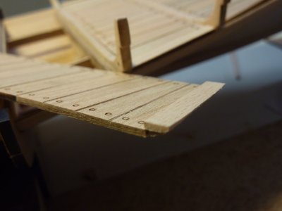

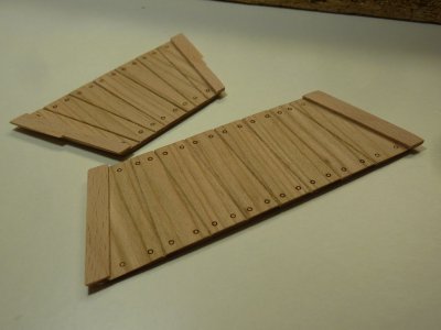

It's unfortunate that I did not take photographs of my actions here. However, basically, what I did was to fit the too narrow decking section in place on the Oseberg and then fit a temporary strake at level eight. This gave me the exact positions required for the widening of each deck section. With the temporary strake in place I made a template of the width and shape/s required. In the case of the original Pavel design idea, the deck remains flat to the very edge of the decking. Photographs of the preserved remains of the Oseberg, give me the impression that the deck took a small step up on the very last board on Port and Starboard sides. I recreated this upon increasing the decking widths.
Part of the system showing level how I achieved the widths required
The End Result
Two finished parts
The step as mentioned

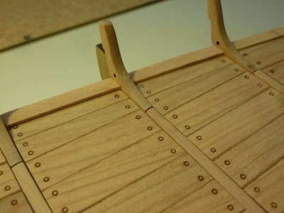

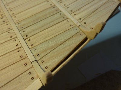

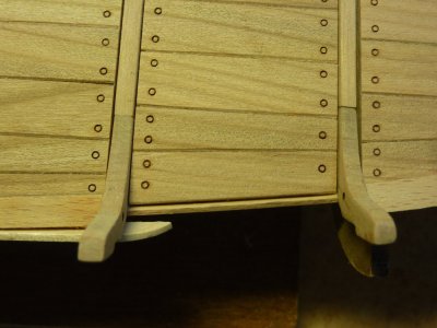

In Conclusion
Creating and using the paper templates, plus chamfering the underside of the board extensions permitted me to be able to achieve a perfect join between strake eight and the decking. The boring part was cleaning up each deck section. The challenging part was figuring out how to fix the problem. The fun park was knowing how to achieve my goal and the rewarding part was becoming a better model ship builder.
All in all, I'm more than delighted with the results.
