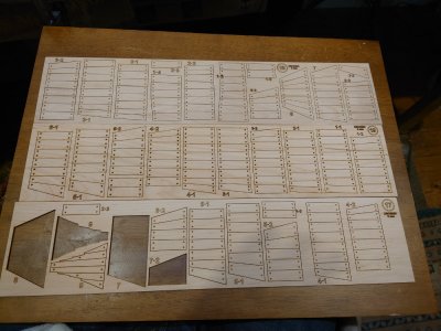

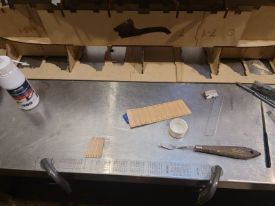

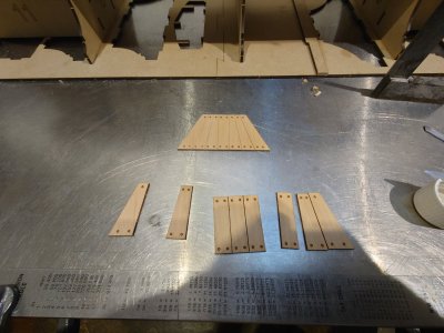

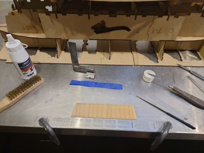

I've now started the large deck plank puzzle. All the planks in the panels are individual planks. I discovered this when I opened the packaging, as many fell out. Getting everything back in place was a puzzle in itself. Now I've glued the panels with the points to a large plank so I can pick them out individually with a palette knife.
This allows me to remove the soot from each one and carefully round off the edges a bit for a realistic effect. Then I'll glue them together.
This allows me to adjust them later and then finish them with alcohol ink.
I've removed all the soot from a few planks; now it's time to glue them together.

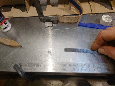

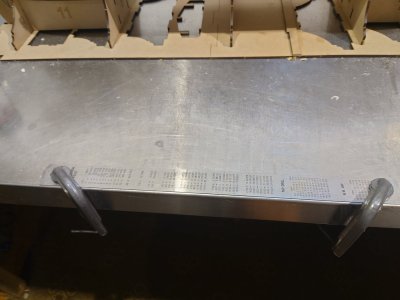

I'm using a steel ruler for this, which I'm securing to my worktable with a few clamps.
This ensures a nice, straight edge.
Next, I use a small amount of glue to attach the first plank to my workbench. I then glue the planks together one by one. The rest of the glue on the underside also helps the planks adhere to the workbench, creating a nice, solid finish that allows me to work on the rest of the piece.
After gluing them all together, I scrape the planks. Personally, I find scraping works better than sanding. Finally, I carefully go over the whole thing again with a brass brush. This doesn't damage the wood, but it cleans the seams and removes any glue residue left behind by cleaning the seams with a scraper.
After that, I can carefully loosen the whole thing with my scraper.
I clean the workspace again, and we can move on to the next piece.

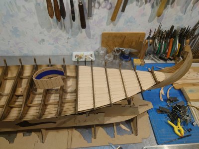

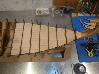

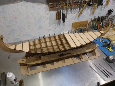

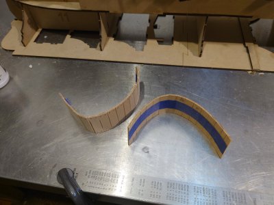

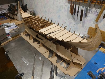

It's been a while, but in the meantime I've continued with the deck, the mast base, and the benches/boxes. For the deck, I chose to create the curve around the mast base. According to the kit, the deck should have been flat, but I opted to create a bump, so to speak.
I also made the mast base; it was a matter of gluing several pieces of wood together and then shaping them nicely. I think this speaks for itself. Unfortunately, I didn't move the location of the mast base. A fellow builder pointed this out to me. I was aware I should move it because I'd read about it, but I simply forgot. I decided to leave it as is, because I've already made too much progress and it's not worth changing at this point, considering the damage I'll have to repair later. It is what it is, and I'll definitely adjust it the next time I build this model again, (my daughter wants to have this one)

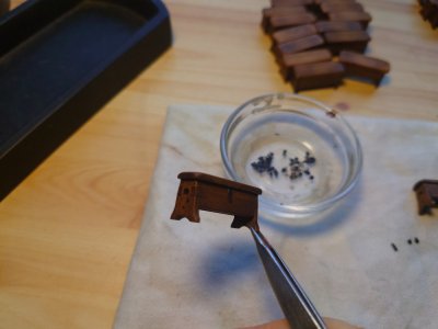

I also made the benches/boxes, which also speaks for itself. As they say, pictures speak for themselves, so hopefully the pictures explain a lot.

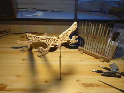

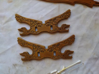

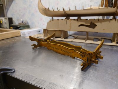

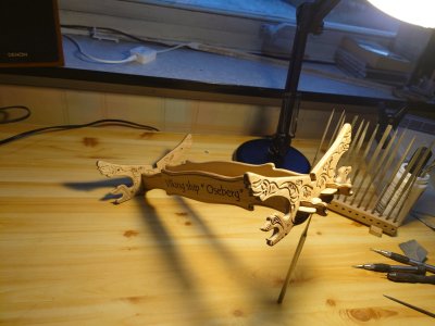

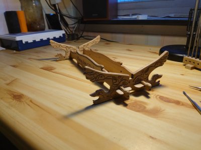

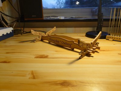

I've started another "small" project: the stand. It comes as a series of laser-cut parts, where identical pieces are glued together, and then all the soot can be removed. No complaints about Pavel's approach, but I'm not a fan of simply sanding and finished. I've taken the difficult route myself, removing all the soot and then shaping the figures and frames. It's not the easiest method and takes a lot of time, but so far I'm happy with the result.
Below some pictures..
View attachment 565226View attachment 565227View attachment 565228View attachment 565229View attachment 565230View attachment 565231View attachment 565232View attachment 565233
Wow, that is a lot of work with a great result, nicely done.
That's a seriously impressive upgrade! Well played!

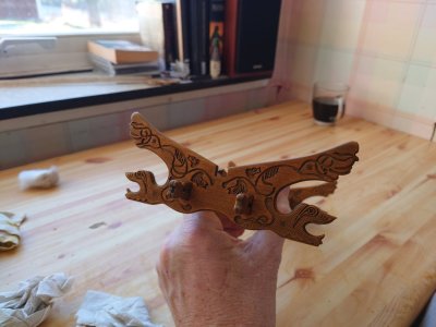

Nice! You have really raised the bar on this kit. Please tell us, what methods are you using to deepen the scrollwork? Freehand rotary tool? Carving gouges? Or are you doing everything with the files that are present in nearly all your photos?

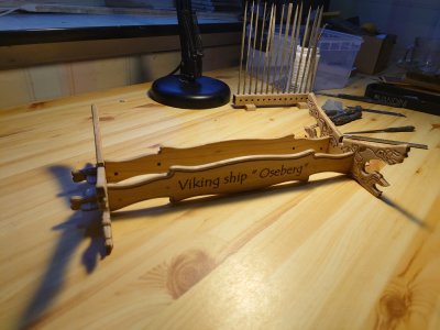

Well, it took me quite a bit of time and effort, but after hours of filing, scratching, and sanding, I'm quite happy with it now. There are a few areas where the discoloration has penetrated deeper into the wood, making it impossible to remove. But anyway, it's wood, and that's a natural product.
I'm happy with the result; it would have been a completely different standard if I'd simply sanded it with some sandpaper. I'll add the necessary color later.

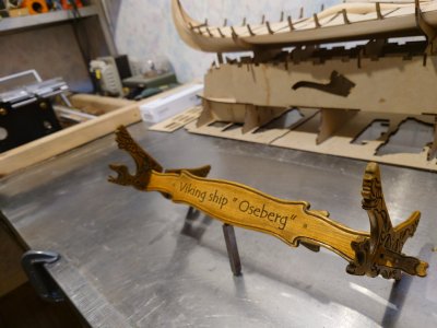

Below are some photos of the current state.
20251226_152614.JPG20251226_152659.JPG20251226_152620.JPG20251226_152706.JPG20251226_152746.JPG

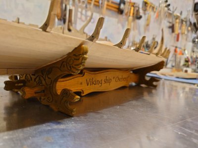

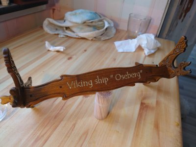

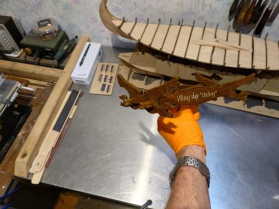

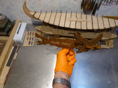

Since I was curious to see how the standard color would look, despite my plans, I grabbed the airbrush and gave it the necessary color. After sanding and applying several layers (four layers from dark to light), I'm somewhat satisfied with the result. The wedges are still there, but I ran out of dark ink; I'll have to make some more tomorrow.
Some photos below.
Beautiful stand Wilbor! You have certainly set the standard for those of us building this model!
Thanks RussF for those nice words

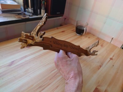

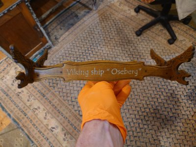

It took me a lot of time, but to make it even more enjoyable for me, I redid it. I found the dark initial design had made a lot of the carving and cleaning too dark, so I cleaned everything again, sanded it, and then reapplied the colors.
I'm now more comfortable with the color and the details, which are now more visible.
Finishing touch.

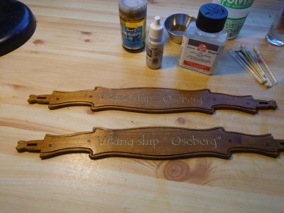

Now I just need to color the letters. I first treated the base with an artist's acrylic varnish. The finish should be matte, but I learned a trick from a goldsmith: when it's touch dry, polish it with a lint-free cloth to create a beautiful, natural, soft sheen. I let this sit overnight, then I applied a very diluted alcohol ink solution to the letters and let it dry for a while. Then I painted the letters with acrylic silver paint. The alcohol ink solution I applied earlier will seep into the paint slightly as it dries, creating a lovely aged effect and taking the bling off the silver. Wrap a sanding block in a polishing cloth to remove any excess paint. Then, apply a small amount of alcohol ink to a cloth and rub the surface lightly. Then polish immediately with a clean cloth, and viola...it's a bit of work. But I'm happy with the result.

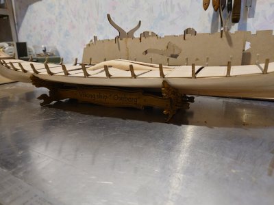

In the meantime, I've finished the stand so we can continue with the model,

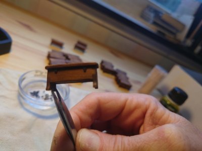

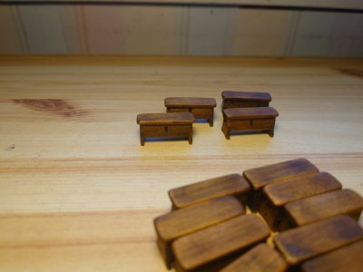

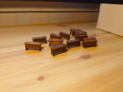

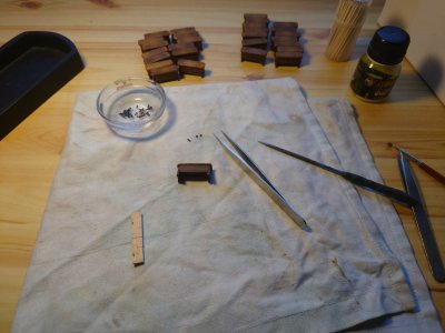

But since the alcohol ink was still on the table, I decided to paint the boxes. No further details came with the kit.
But since the "boys" need to be able to store their loot safely :cool: I've added some hinges and locks to the boxes.
