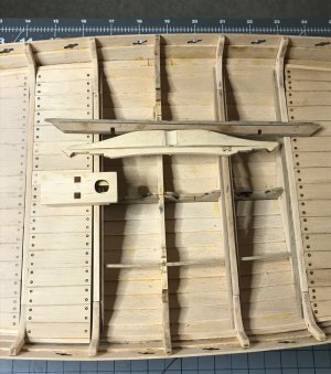

A small update.
I decided to add planks #10 through #13 (the Oar Plank) to get an idea of how the decks fit.
After inserting the decks I can now see how the extension end pieces supplied in the kit will fit against the inner hull.

I saw also Pavel’s video about the deck planking: a intens job. It’s going to look very nice, Jan. I can imagine that it took you ‘some time’ to figure out what the best practice is.
It's really coming along Jan - looks fantastic. I was trying to figure out what's going on just forward of the rudder block, but zooming in, it just looks like a weird camera artifact.
The yard and garden work are beginning to wind down, so I'll be getting back to my own soon - I hope!
Hi Russ. Hmm, don't know what to tell you, in the photo it looks like some thing is missing in that area but physically all the hull is there. :rolleyes:

Hi Jan, did you get the email from Pavel announcing his new mast step retrofit kit for the Oseberg? It is much closer to the original and it even appears from the photo that he has moved the mast forward one frame to where it is supposed to be. It also appears to have new deck planks so that they can form the "hump" up to the elevated mast partner biti. Looks pretty good. If I hadn't already done all of that on my own, I probably would order it. ROTF

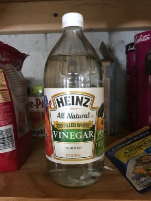

I noticed yesterday morning that I had the rudder oar plank on the wrong end of the hull. I wound up with a "BIG" Re-DO. I used Heinz White Vinegar to unglue the PVA, rinsed the planks with warm water and then clamped them between two old book shelves overnight.
You do need to test the vinegar on a scrap piece, if left on to long it might add some blemishes.

You'll have to see what it looks like when you get the kit. It may be easier than you think to move the mast forward.

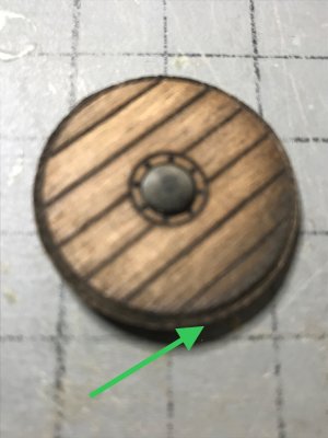

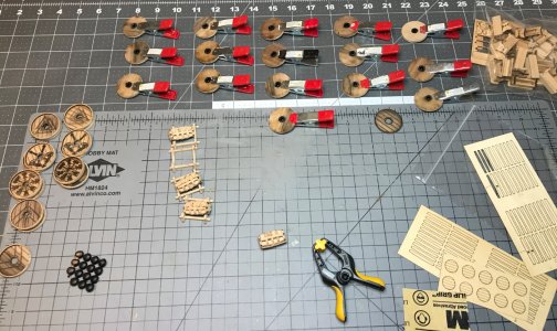

I managd some time in the shipyard and started working on the small bits while waiting for the mast step upgrade.
The 28 oar benches (upper right corner) are complete and ready for painting.
The barrels (in the middle) are proving to be a challenge for my bumbly fingers.
The Viking shields are a bit of work. The shied rim was cut off center by the Laser.
A little bit of sanding needs to done once the rim hoop is added

My go to glue for shipbuilding is "Titebond II". I've become the Master of "Do-Overs". Somewhere I read about using vinegar to loosen glued parts versus using a heat gun or hot water. So.....
I applied a thin bead of vinegar along the glue seams, waited a few minutes and carefully pried the parts apart.
You should test the vinegar on a piece of scrap to see if there is any reaction.
