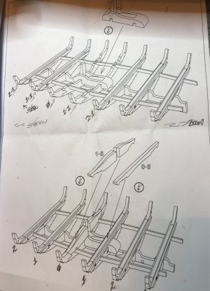

Okie Dokie, I've looked at the upgrade and it appears to me that the instructions show the Mast step being installed between the two #1 decks as per the kit plan. I think I have that right?????
What do you guys think???

I'm scratching my head trying to figure out where to start. I checked to see if there was a video to scan.
Hmmm, how is that possible, since there is a #0 frame in between the two #1's?
Yup, head scratcher.
Those frame numbers on Pavel's plans/prints has to be a mistake, it needs to go between frame 0 and frame 1 towards the bow. At least that's how I think it should work.

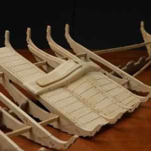

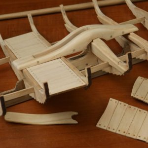

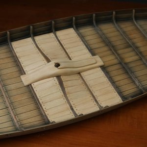

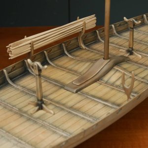

I did a screen dump of one of Pavel's videos.
This is the old installation which by the way is a bit longer than the new one. Even so I think the short end goes toward the bow and the long toward the stern. I'ts theplacement of the piece underneath that I'm having trouble visualizing.

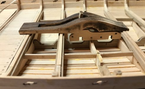

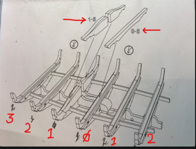

@RussF, my bad. You are right, I looked at the drawing wrong.
Fixed the rib labels." 0 " in the center and " 1-1" on each side.

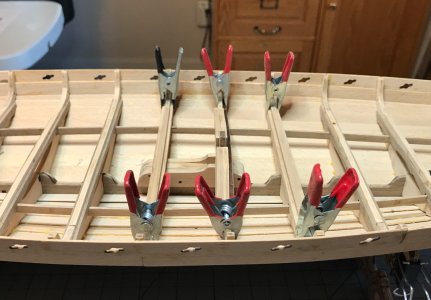

That brings me to this quick fit
The bottom has to slot in to the " 0 " rib and the right " 1-1 " rib.
I need to remove some more material on there. I think I've got this figured out.
Jan
Jan
I think you're still off, my friend. I think I had mentioned before that it looks like Pavel has moved the mast forward one frame as it is in the real thing.
Notice the biti numbering in the drawing. The thick biti used to be on frame 0, now it is labeled as 1 and the new frame 0 biti is a standard thin one.
I'm assuming the upgrade kit has replacements for the bitis? The new (thicker) biti 1 should go on the #1 frame that is forward of frame 0 (toward the bow).
All this will then effectively move the mast forward one frame and put it where it is supposed to go.

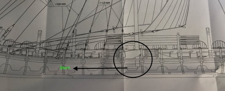

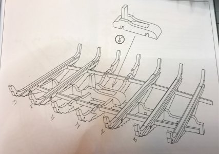

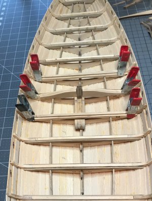

The upgraded mast step:
It took a bit to remove the bitis that were in the way (used vinegar to loosen the glue).
Then I couldn't figure out which direction the long portion of the mast step shpuld face, toward the bow, toward the stern???
The Pavel Plan. The mast step is in the circle is pointing toward the stern.
The modification dry fitted.
There is still a bit of snding involved before the final glue down.
Jan
Jan
If you're moving the mast forward one frame, then the mast will abut the forward frame 1 on the aft side of the frame. Place your step however that can be accomplished.
I did move the mast forward to the forward frame 1, the rest of the supplied update parts fit very nicely (After char removal).
Jan
