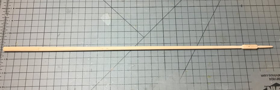

The mast,
The mast ready for the paint shop.
I think I was about an hour between removing the char and sanding it into shape.
Jan
Good evening Jan. Removing char is my bug bear. Remove too much and we change the shape, remove too little and it looks horrible. Looks like you got the balance just right on your mast. Cheers Grant
Yup, the whole kit is "Char" intensive. I've used quite a bit of 220 grit paper so far.
At last a nicely shapes mast, Jan.
Thank you Peter. I have had quite a few "Char" removal marathons. I'm amazed when watching Pavel's videos how quickly he accomplishes that chore.
