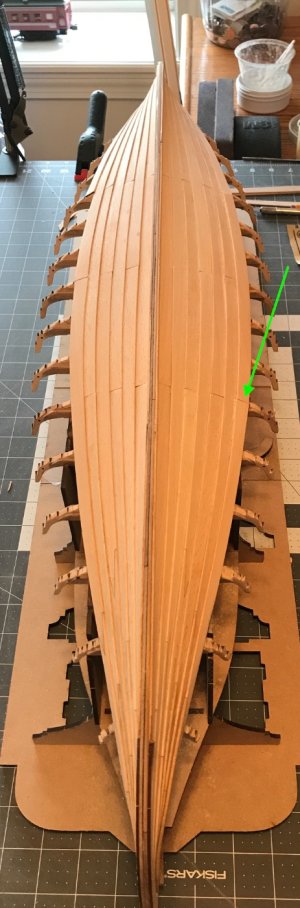

What I meant is that strake #7 is in three pieces. I'm finding that with all the dry fitting to get the best result, I start gluing and clamping from the location of where the pieces butt up against each other to the bow. The arrow shows the butt joint between the first and middle piece of the strake.
I apply glue to a couple frames and the top edge of the strake for that section, I work my way toward the bow. I usually give each section about twenty minutes for the glue to set before doing the next. Initially when I started gluing the strakes, I applied glue to the top of the strake and the frame notches it would cover and then added clamps to hold everything in place. Fat fingers, grabbing and applying clamps, adjusting the strake, etc. was a "Bad Word Jar" event.

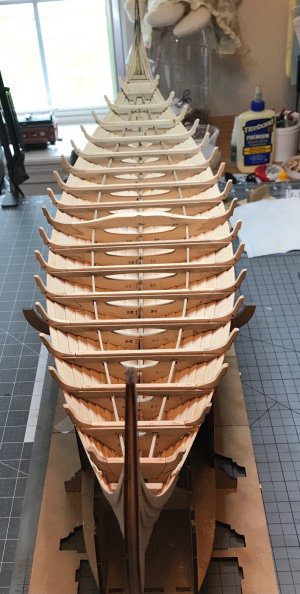

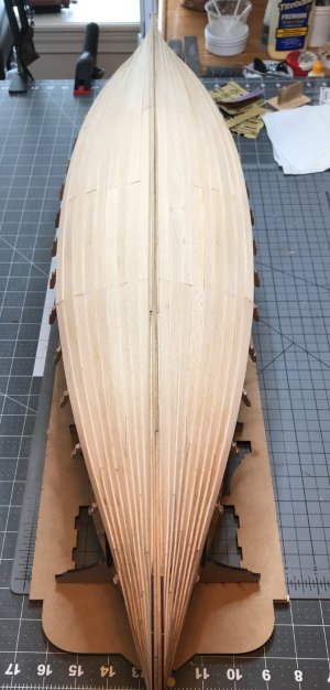

Planking milestone!
I finally got around to completing strakes #1 through #9 on both sides. There were a few additions to the "Bad Word Jar" because of that snapping sound when one the strakes snapped, but we hung in there and got it done,
The time has come to decide what color stain to use. I believe the strakes of the Longships where OAK and will probably go that route.

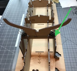

I did a Jan workaround. Number 2 jig is designed to add hull supports to hold the hull upright while adding the deck and other accessories. I stopped planking at 9th strake and still need to add strakes #10 - #12 so I chose to temporarily clamp the supports instead of gluing them.
The fit.
