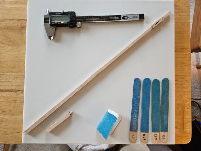

Agreed. I use large craft sticks to make my own "emery boards" by gluing sandpaper to them.
I have some large "Tongue Suppressors" that I've covered with 220 and 320 grit. Pavel seems to have some nifty double sided sanding boards.
Jan
I've been making my own sanding sticks as well, they work great. I also use single edge razor blades to scrape off some of the char marks on the faces of the strakes, it works well getting most of the big stuff off before I finish sanding them.

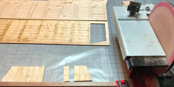

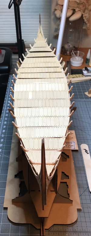

The start of the decks.

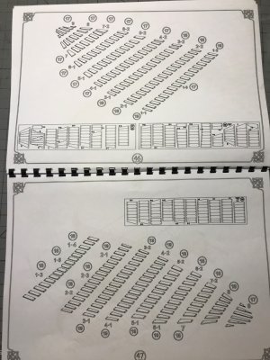

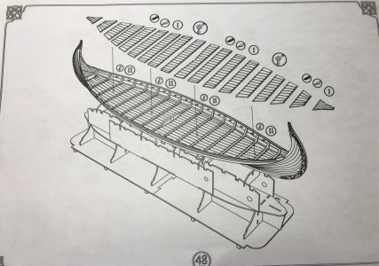

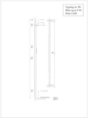

The build plans,
Plus this video "Video #11 decking. There are steps that Pavel completes that aren't in the kits build plan.

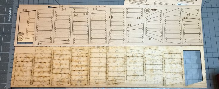

But before I started separating the pieces from the flats, I flipped the flat over and numbered the pieces on the back.
I didn't want take a chance of mixing any of the pieces.

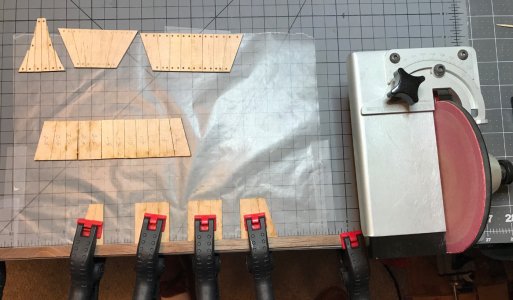

The assembly process. Remove the char.
Then butt the pieces up against a straight edge and glue them in sets.

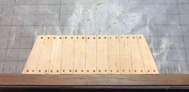

The final glue up.

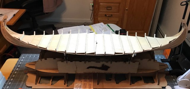

The finished deck.
Sorry for the glare from the wax paper, but it's a great backing since PVA won't stick to it.
Jan

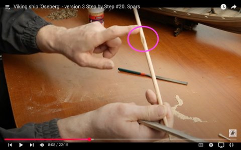

Mast and Spar Pavel Oseberg video #20.
@RussF
What is the "dimple " in the spar that Pavel is working on??
I see no reference for that in the build instructions or any of the plans. I've finished the mast and started on the spar when I decided to another look at this video and ????
Jan
@RussF
Jan
That, my friend, is a good question. I suspect it is Pavel's artistic license. We already know that the top half of the Oseberg's mast had disintegrated, so we don't know if there was a square section with a sheave or not. I honestly can't remember off hand if any of the yard was left or not. The reconstruction, however, was made with a cylindrical mast with one flat side as I have documented before and a slot for a rope. I don't know if there is a sheave or not, it doesn't appear so from the drawings in Dr. Bischoff's paper. The yard was reconstructed purely cylindrical. I'm afraid you would have to post the question directly to Pavel to get his take on it.
@RussF, thanks for the input, I had to watch Pavel' video several times to see that little bump in the middle of the yard. Interesting about the mast construction, I've finished it to be completly cylindrical following the plans, but I see from your post that the mast diameter varies 1.5cm from top to bottom. I hadn't worked my way through the Dr, Bishcoff's paper far enough to see the yard drawing.
