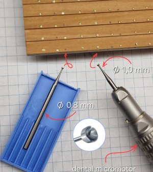

3. The most difficult, but most realistic way to create bolts and nails (with textured shape).

Hello Sergey,
So you clip the 1mm wire and this forms the bolt head? I can't see how the flanges on the bolts are formed?
I also discovered the fake freenails using the mech. pencil. Unfortunately I use yellow cedar for decks and it's too soft for this trick.
Also, I've never come across fake overlap on clinker!! I'm happy building with the overlap, I'll stick to that!!
Many thanks for this very informative post. Have a good holiday season.
Bob
Hello Sergey,
Bob
Thank you. I treat the wire edge with a special boral bowl. I explain this in detail in the link I provided. As for the clinker sheathing method, that's a matter of taste. My method is very simple, but I'll use the second option on the second hull as well. It all depends on the situation.

Nailing.
In the post linked below, I detail how to create a textured nailing.
That is, the nails aren't ground flush with the surface of the boards, but protrude slightly, creating a slightly textured surface, as in the photo below:
Also continuing the topic is a post about creating regular nails for a deck.
And about the creation of Bolts for Clinker Planking.
And below (at this link) I show in detail, step by step, the production of bolts and their installation on the body in practice.
