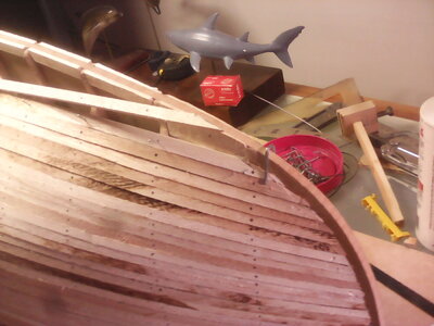

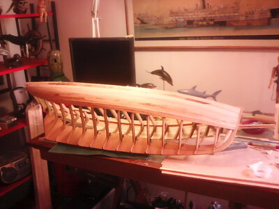

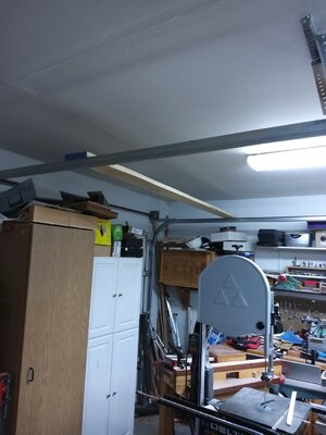

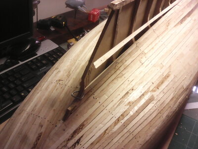

I buy Basswood too. But differently than most model builders. I buy it from a local hardwood supplier and then mill it as needed. The board in this picture is Basswood just stored up there for now.....I found the basswood from Midway to be inexpensive, and you can buy a whole bunch cheaply and not worry about running out of wood, because kits give you the bare minimum. Watch how Olha cuts wood in the link I posted previously. Narrow planks follow the hull well, wide planks make a segmented shape that no amount of sanding will create smooth curves from. Make 4mm planks and then start planking, but look at other models and copy the shape and directions of their planks. It takes practice. Planks should not have any gaps, so sand the edges at angles such that they meet the edges of adjacent planks perfectly. Make each plank FIT. apply glue to the plank edges as well as the frames. Wipe off excess glue with a moist towel and don't smear the glue, ROLL it off using the rag. You can get away with gaps on the first layer, but NOT the finish layer, so you need to practice, and prepare each plank using careful fitting, so by the time comes to add the final planking, you'll have the skill you need.

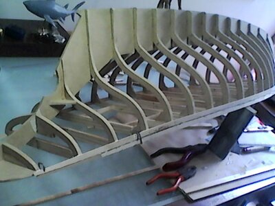

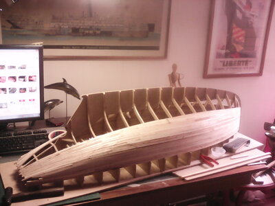

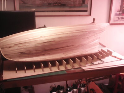

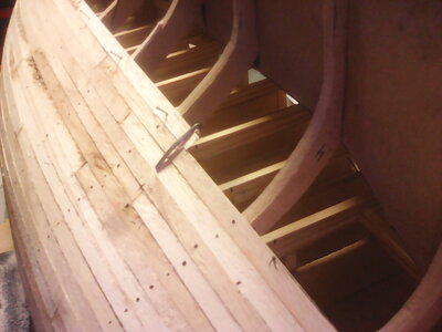

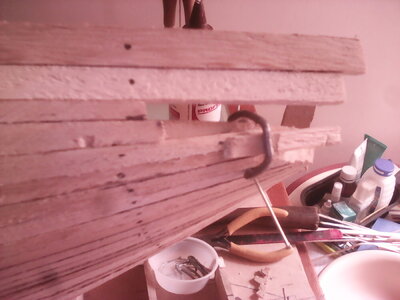

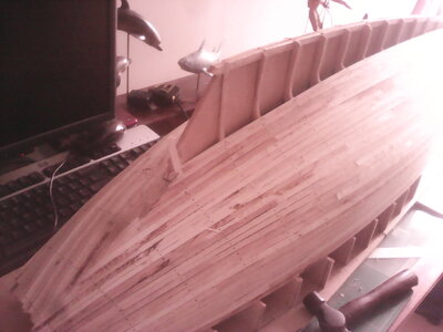

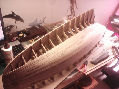

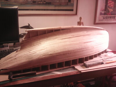

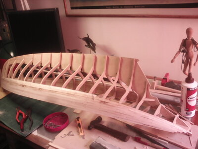

Hallo @rickyboy66look at these pictures i was practicing having problems with the tapering thing I'm pretty sure I was supposed to taper a couple of planks I'm having a problem understanding which ones to taper and how I've been watching how to videos but I'm just getting frustrated nether pictures are that great but I have to start somewhere.

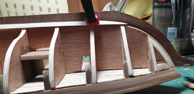

Always make TWO planks at a time, and plank the port and starboard sides at the same time. This allows you to look and check to make sure both sides are symmetrical. You can adjust by making a couple planks a bit thicker on the side that is losing the race toward closing the gap in the hull. Look at the hull of La Couronne below. Note how planks are started at the gunwale at the top, and also at the garboard strake, at the keel, and planking progresses toward a midpoint at the hardest turn of the curvature of the hull. The strip left unplanked is the line where the gun ports will go.
The gap narrows. It is obvious at this point hat drop planks will be needed, mostly at the bow, and a couple at the stern.
The lines of the planks are harder to see here, because the hull has been sanded, filled, and sanded again several times. Filler fills in flat spots, so the hull curves are never sudden bends, but rather slow and subtle curves. The drop planks at the stern terminate farther from the stern than the drop planks terminate from the bow.

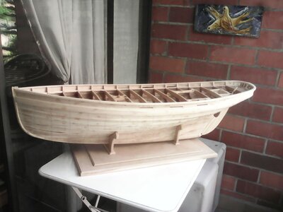

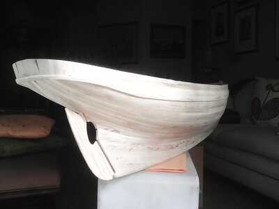

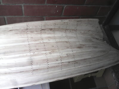

Lovely planking, what do you use to hold the planks,Las tracas deben ser adelgazadas hacia los finos del casco, no en una medida prefijada, si no de acuerdo como van evolucionando las curvas del casco. Cada diseño tiene los diferentes anchos en lugares de acuerdo con su estilo. Es señal de buen trabajo que las tracas sean el mismo número en proa, en popa y hacia la cuaderna maestra. Para ello es que se van adelgazando a medida que pasan por las distintas cuadernas. Dejar morir una traca sin llegar a la roda o al codaste es que no se comprendió la geometría del casco.
