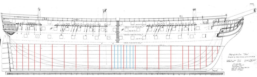

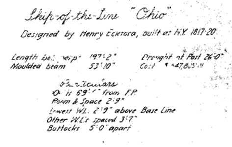

At the Naval Yard the station lines were on the frames case in point the OHIO the red lines are the station lines the blue lines are 3 frames between each station line. bow and stern the red station lines are every other frame
We know this because it says it on the plans frames center to center are 2 feet 9 inches
Maybe this is how Henry Eckford drew plans or if it was standard at naval yards to space the stations on frames Or maybe there was no actual standard and each master shipwright did things his way.
