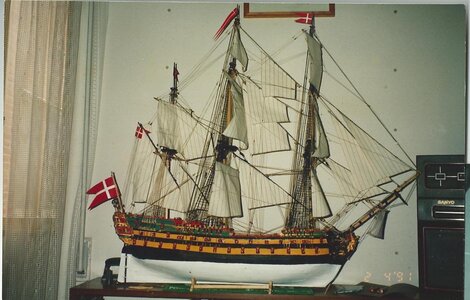

I always did it in my time-19*60and forward. It will close all the tiny holes on the planks, and as you mentioned to give you information on failures ann bad connections I used my own mix-white -but as it was very hazard ta sand down,. I will not give the recipe- eye mask, mouth and nose mask etc far away from your wife, as it gets an. extremely fine dust. it was built so well, that NO 2 ND planking were needed
