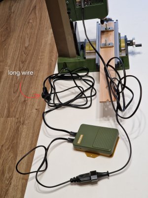

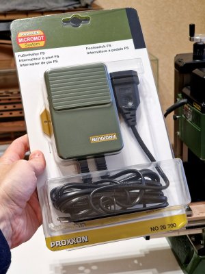

Another very useful feature that (in my opinion) is a must-have for your router.
The pedal.
One of the big advantages is that you can quickly turn the router on or off at any time without using your hands (the latter is much more important).
The second advantage is the long cord. The pedal cord is longer than the cord from the router, and it starts further from the router itself, so the cord can reach further to the outlet.
I definitely recommend it.

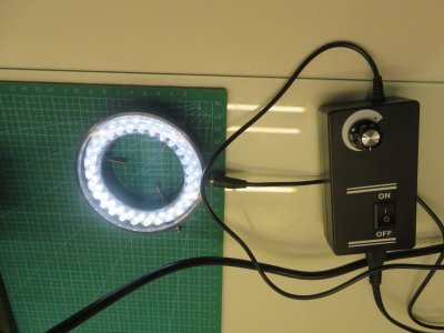

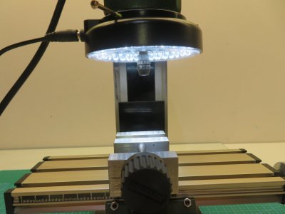

A foot control will be very good when doing repetitive drill/shift/drill/shift. One other add on I have found very useful is a ring light. I am not sure if Proxxon do one that fits the MF70, but I bought a very low cost adjustable ring light for a microscope from ebay that works very well. It is a little on the large size, but if you are not changing the bits often, it is fine once set up but is very easy to take on and off.
How many LEDs do you have there? There are 3 versions.
I have the one shown with 60 leds. They are very bright and I usually have them turned down quite low which is ample to light the pieces I am working on.
In my opinion, this is a bit big for such a small machine. I'm more inclined to this option.

The LED ring light is quite large I agree. I looked around but was not able to find a smaller ring light that would fit onto the bottom of the mill body (36mm diameter). I don't know if the sewing light would fit but if it does, it looks a nice cheap option. I tried using some small LED spot lights on flexible stalks to light the work area but I found that the lights just got in the way and cast shadows so you really need to light directly above the cutter. If I find time I might make a custom LED light myself as a little project.
