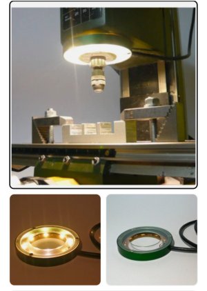

The LED ring light is quite large I agree. I looked around but was not able to find a smaller ring light that would fit onto the bottom of the mill body (36mm diameter). I don't know if the sewing light would fit but if it does, it looks a nice cheap option. I tried using some small LED spot lights on flexible stalks to light the work area but I found that the lights just got in the way and cast shadows so you really need to light directly above the cutter. If I find time I might make a custom LED light myself as a little project.
By the way, I was also thinking about making my own lamp, but I think I'll test the sewing machine lamp and if it's not so good, I'll make a custom one based on it. The price is good, even if I have to remake it later. There are better options, but they're х10 more expensive.
I dug up a cheap, small, LED goose neck desk lamp, seems to do the job without getting in the way. Old school + LED brother. I'm sure it will be plenty dusty and greasy soon enough.

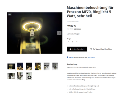

Just a quick update regarding the light. Nobody sells the Proxxon light in the UK and shipping from a European supplier made them too expensive. I looked again and found these Angel-Eye lights on AliExpress which are perfect. I bought the 40mm OD version which is 12V and works on the dimmer that I already have. Paid £1.60 for the light! Very thin and compact and I used some double sided tape to stick the light onto the mill.
Thank you, this is a very interesting option and, most importantly, very inexpensive. You just need to wire it to any 12V power supply.
