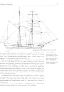

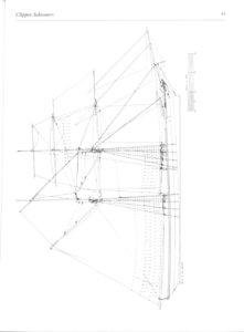

Hello again Eric,
There is one more book book where you can find more details on the rigging of early schooners:
The Schooner by David Mac Gregor.
I hereby attach 2 drawings of the said book that show how different braces are rigged.
Your choice...
